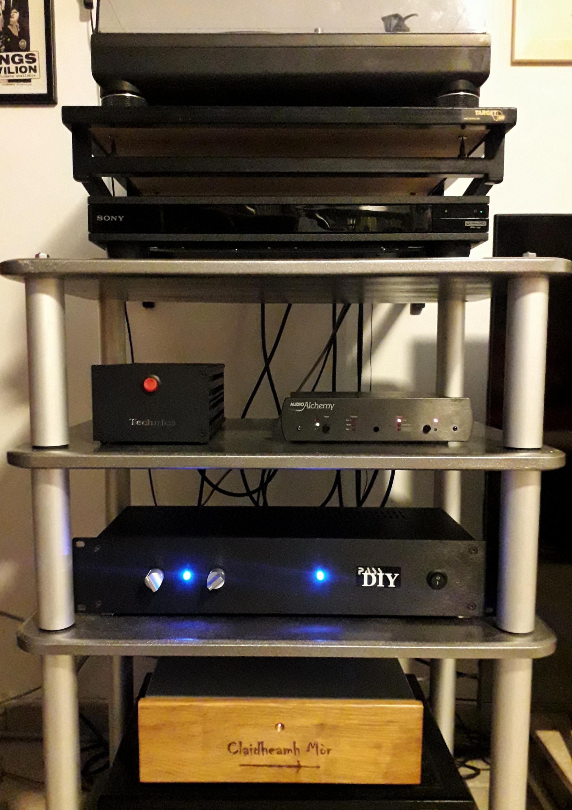

...But sitting in my rack now is Korg B1 which is a different animal but I like it best of all. It's like wearing 3D glasses.
Oh my! And all this time, this is the one I didn't think I needed...
Waiting for R0 to R2 to K B1 comparison on the same setup, in these two days I'll burn-in the R2 and have some serious listening sessions
I would also like to hear that comparison

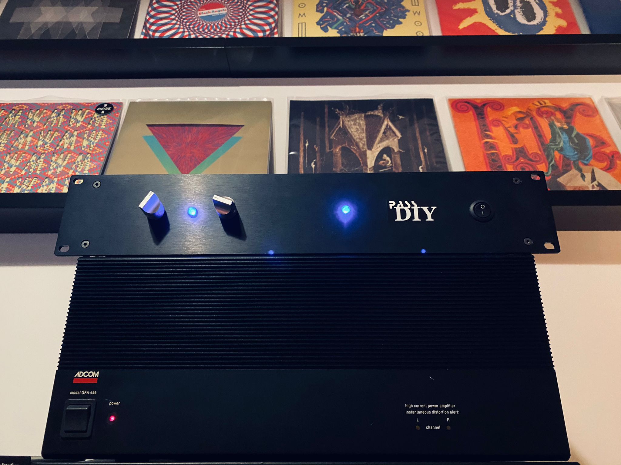

I've built a B1 R2 using the same board as Peppennino. I've used components with the same values as Papa's schematics.
How do I adjust the P101 and P102 for correct performance? I've read through a few threads but haven't found an answer. Jfets are matched Linear Systems, grade B from the Diyaudiostore.
I'm guessing I adjust P101 for V measuring across R101?
P102 is adjusted for 0 DC?

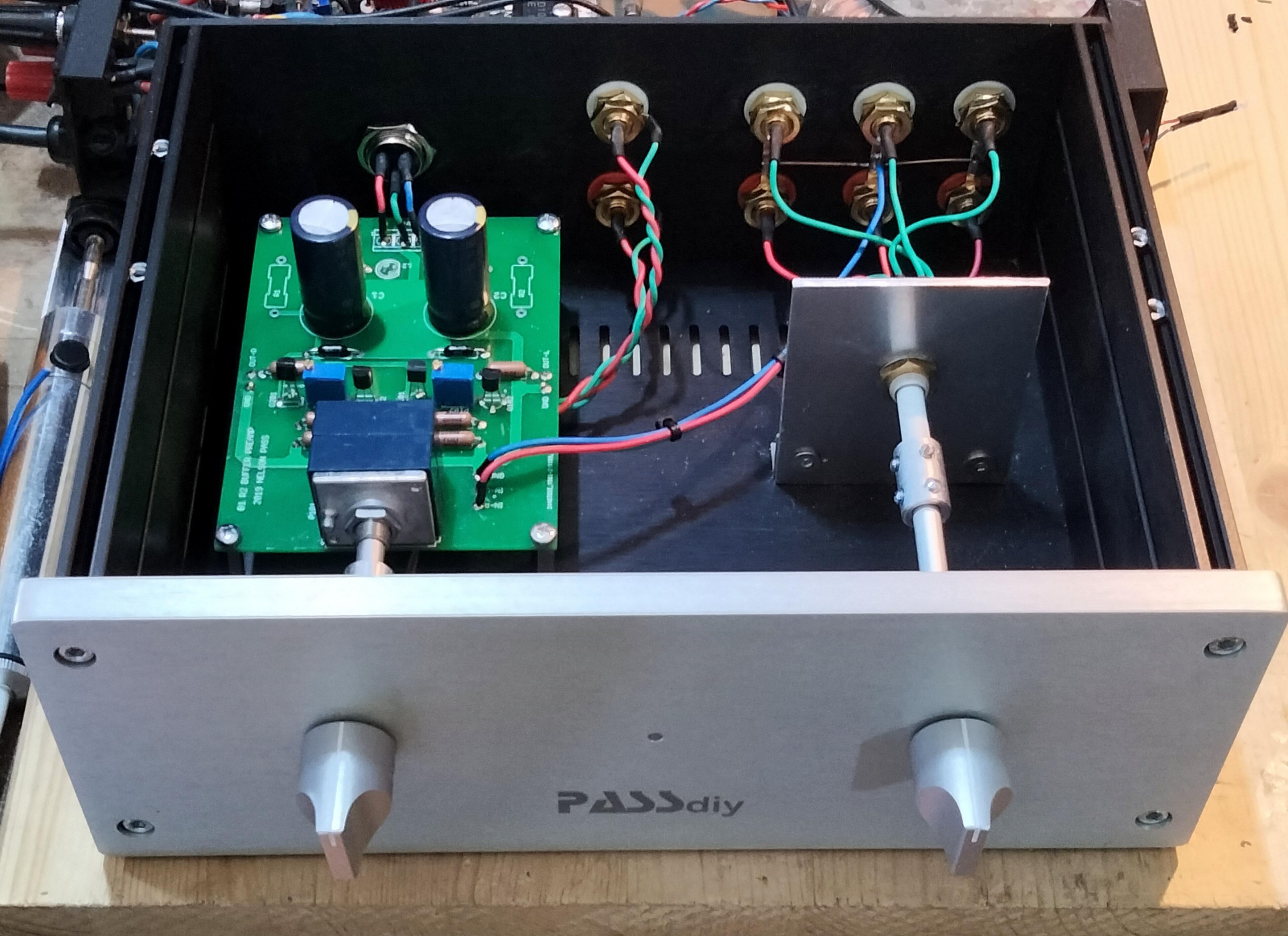

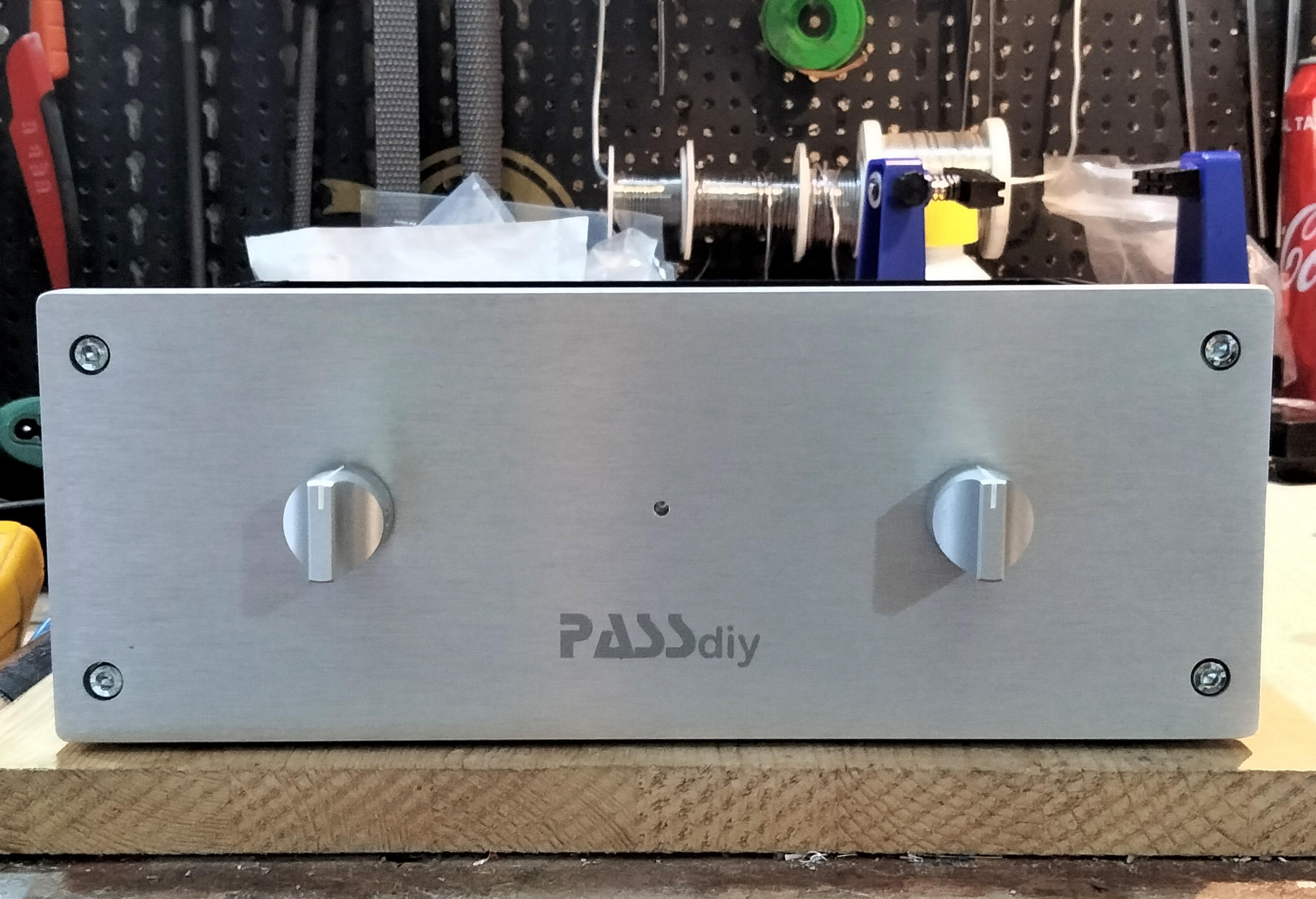

The second one (mine) will be in more "KISS" style in a simple GX287 case
Bere I am
I'm waiting for R1 and R2...

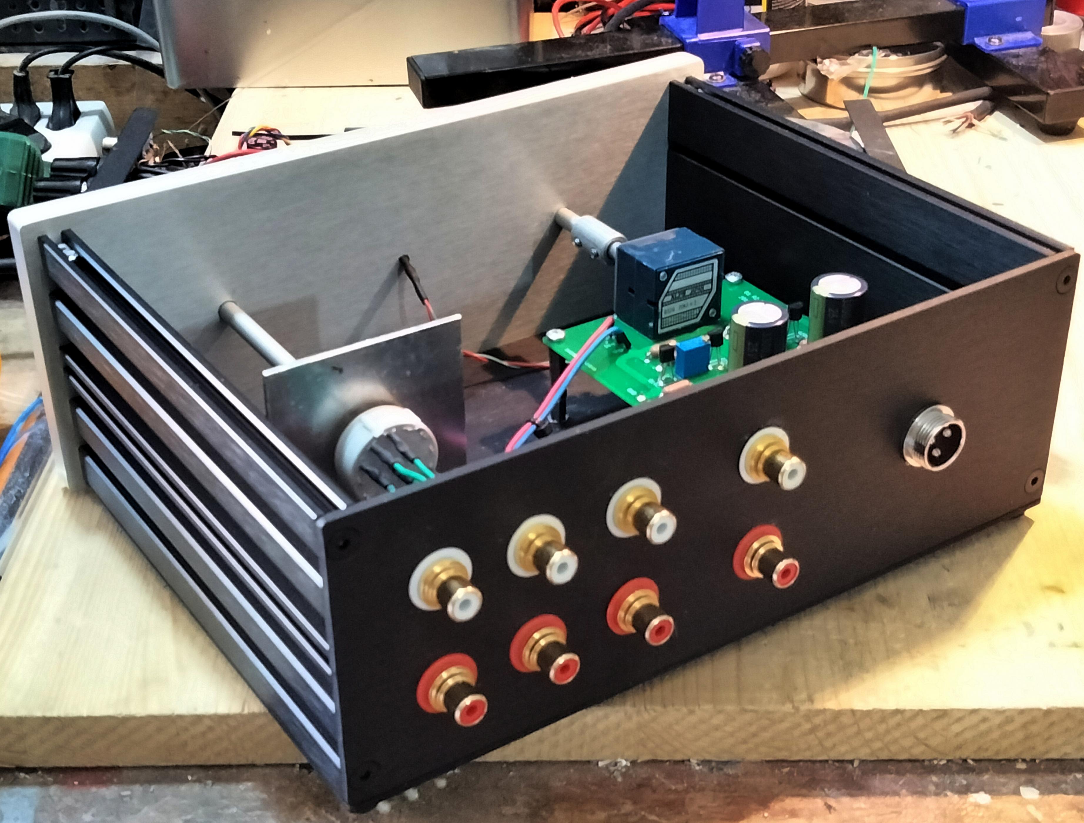

Hi Peppennino,Bere I am
I was looking at your cool case for your B1 rev2. I notice the switching and volume pot extensions. How did you do that? I'm wanting to do that with my build and not sure where to buy the stuff that allows you to have knobs on the front of a box but move things or switch things toward the back of the box? I'd appreciate your input. What do you even call the added tubes and supports-- in other words if I went to digikey or someplace, how would i even find those extensions, etc. THANKS!!!
hardware store, 6mm material
dunno how it's called in your neck of woods, wire, shaft, stud, bar, rod
heck, you can even use M6 threaded rod, usually sold in 1m length, though proper round 6mm will give less wiggle in front hole
and then you can dismantle old broken pot, and use its front as sleeve bearing for front plate
illustration: https://www.amazon.co.uk/PACK-METRIC-THREADED-STUD-ROD/dp/B07DK9CRG9

Here is a thread that might help with ideas and terminologyIf I went to digikey or someplace, how would i even find those extensions, etc. THANKS!!!
https://www.diyaudio.com/community/threads/where-to-get-pot-shaft-extension.6366/
