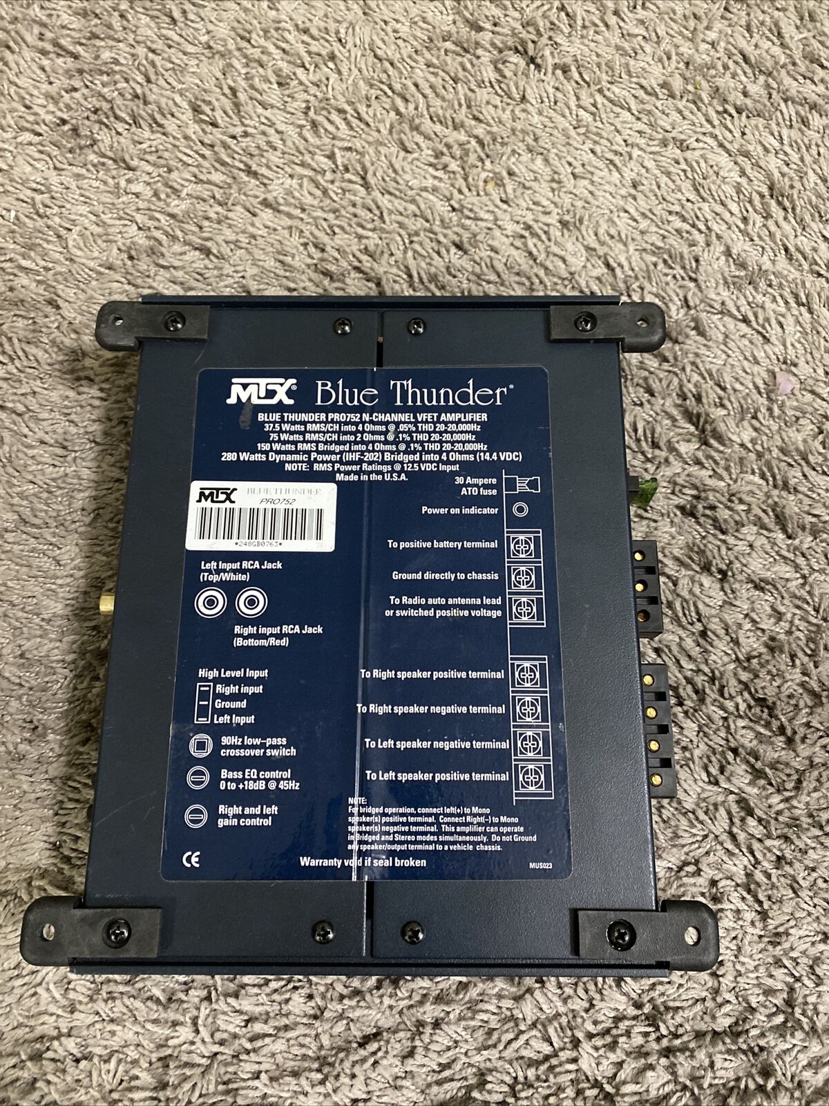

Funny you should mention the SIT-3 since that's the other amp I aspire towards getting. I'm waiting on delivery of an old MTX Thunder amp in order to sample VFETs in my system.
If it's as good in house as I remember it being in car then I'll probably pony up for the SIT-3

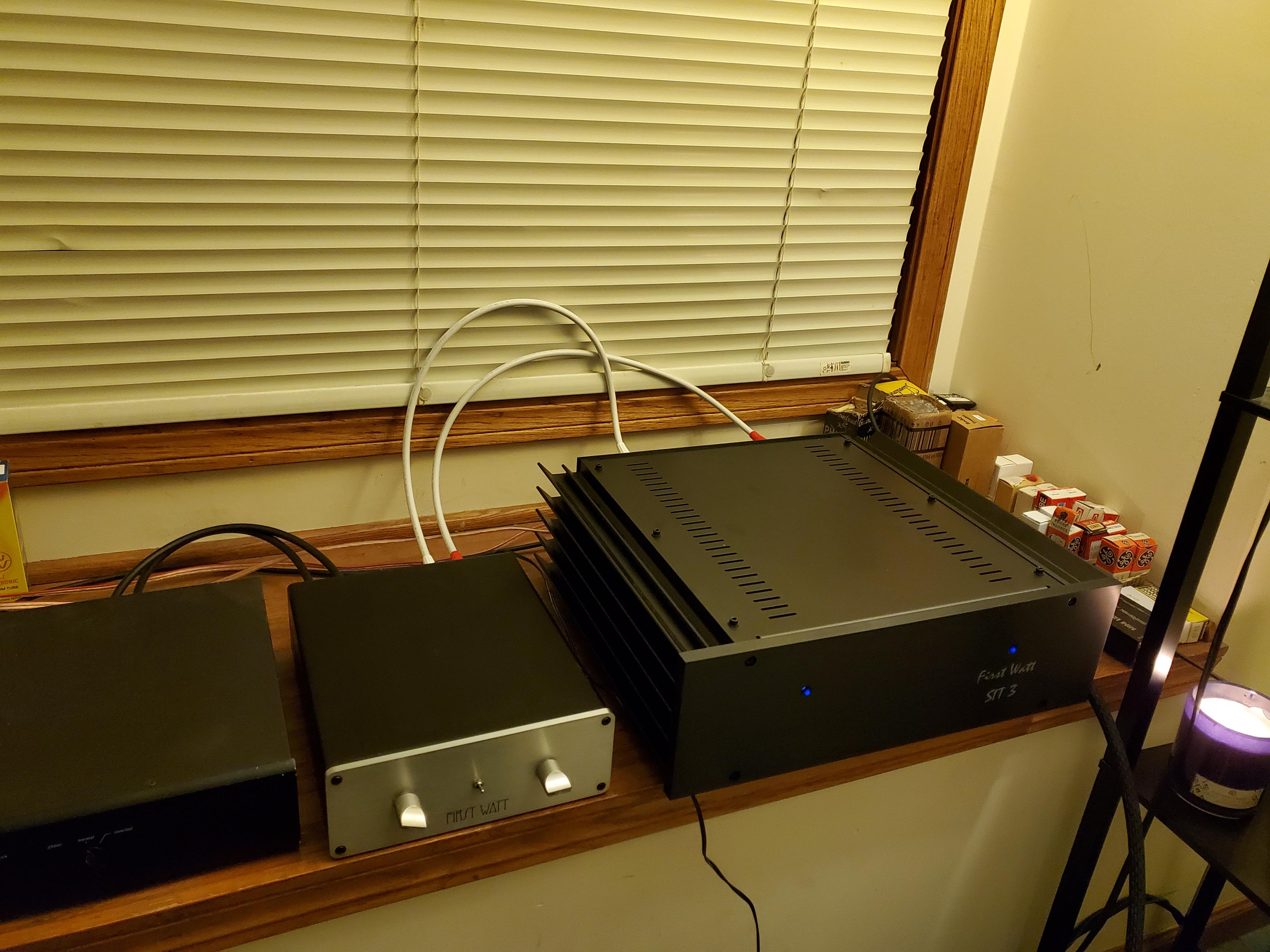

I ended up getting a SIT 3. I tried out a mtx (vfet) car amp both in-house and in-car. Those vfet mtx's are good old American amps. Ballsy.
In car the mtx is awesome. In house it lacked some finesse.
So anyway the SIT 3 is a revelation. Picodumbs you made a great recommendation 👍
Im a little obsessed with the connection between the mind and body. That's my frame.
Finally I'm experiencing hifi. Listening to music is different now. I feel a connection to the songs in my head and torso. Its a blissful feeling. This First Watt/Buchardt combo feels good in to listen to

I dug up the sales sheet for those MTX amps a while back, and I think they were using VFET more as a marketing term for a vertical mosfet. Assuming that’s the case, I bet the SIT-3 was a pretty big step up. Enjoy!
I just looked at probably the same sales brochure and it said "Vertical-Mounted FETS" So you may be on to something. On the other hand that brochure was probably written by an ad-man and not an engineer. I'm surprised a company would lie like that while also underrating their amps at the same time. Those amps regularly test at double their rating.
Either way I can't turn my SIT off and it definitely has real VFETs

Yeah, no doubt SIT-3 is the real deal. And I don’t think the MTX ad folks were maliciously off base, as the mosfet they used probably had a v-shaped trench. Not sure how easy it would be to get inside the MTX, but it might be worth taking a peek and seeing what they used.
You can find pics of the PRO752 at MTX Blue Thunder PRO 752 - AMP Performance
I have my doubts about the VFET content...
All power SIT are metal package TO3, TO79, RF, Pucks and some other varieties not seen from Amp Performance photos. No SIT there, no mystery.It will remain a mystery to me
Yes Gerd, there are a few small SIT, I happen to have a few Sony 2SK63 and 2SK79. The 2SK63 is metal TO39 and the 2SK79 is sort of grayish rounded corner TO92L. I am pretty sure there is no K79 there. 🙂
Anyway, SIT parts are expensive and quite an odd choice for consumer grade car amplifier targeting subwoofer driver duty.
