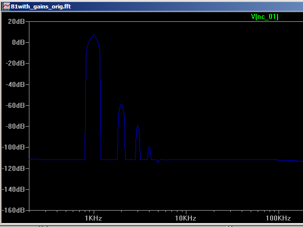

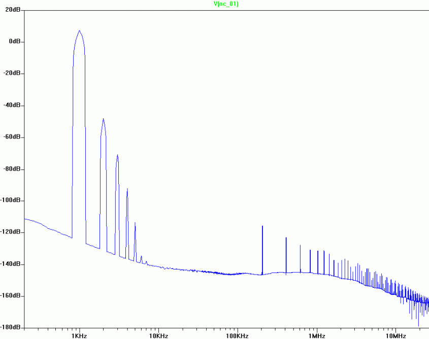

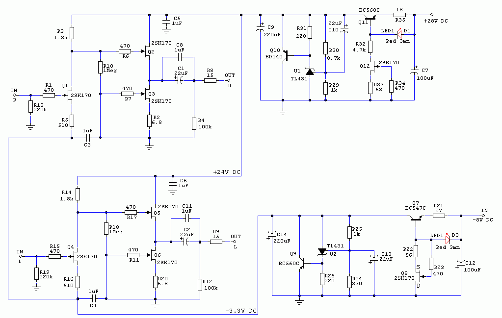

I have simulated, with Ltspice, at 1khz with 1 volt input, the B1 with gain circuit in the post #664
The thd fft spectrum show much more distortions than the original B1 circuit simulation.
Is it normal, what modifications could be done to lower the distortions of the B1 with gain circuit ?
I include an image of the thd fft spectrum and the .asc file of the B1 with gain circuit.
Thank you

Hi Gaetan, note that I have no idea what I'm doing but try increasing R9 to 20K and R10 to 5.6K I think you should see a big improvement in your distortion 🙂
Note I modified the circuit on the B1 side to be closer to the original, but that had very little effect (if any) on the distortion, so I turned to the gain stage. That dropped the THD from 0.17% to 0.05%
Attached is from your original circuit with only the two mentioned resistors changed.

Hello wintermute
I'm surprise, I have simulated your suggestion and despite that the input Jfet do receive only 669 micro amp of DS current, the thd are lower !!
Any explanation about it ?

Hi Gaetan, As I said I have no Idea what I am doing, so any explanation will be speculation on my part... I tried isolating the gain stage from the buffer stage, in case it was an interaction between the two cricuits but it didn't change things, so it appears that the distortion is directly related to the amount of current flowing through the fet (I also simmed with 10K and 2.8K first and it was higher in distortion).
Although the gain stage is about as simple as it gets, I unfortunately do not really know enough to say how and why things affect the distortion, I just had a hunch that increasing the resistance may help.
Tony.
