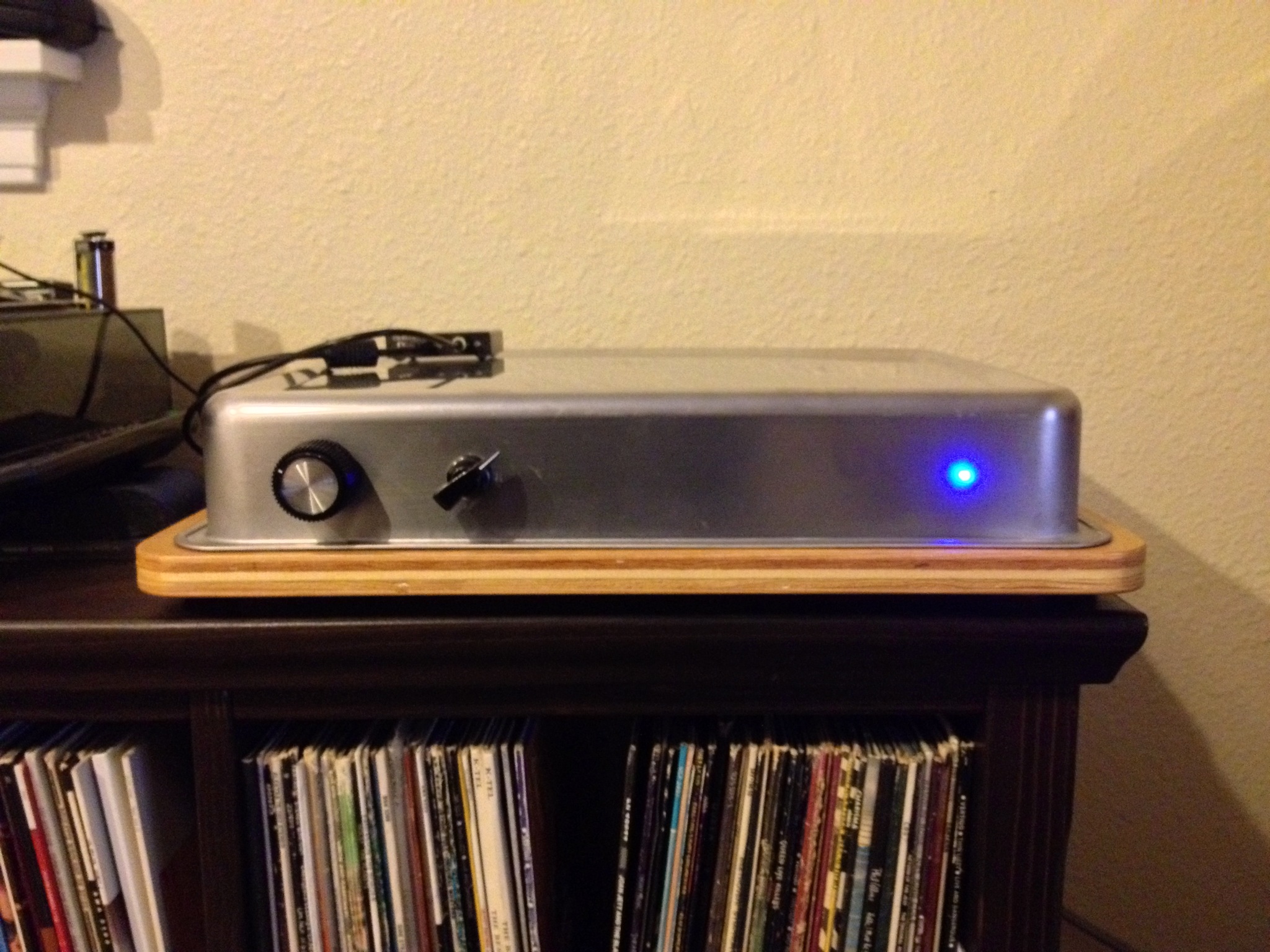

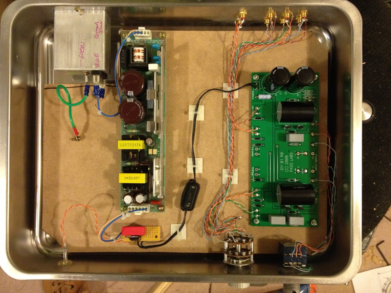

Here's my B1
Stock B1, used a 24v switcher power supply with a linear section to drop the voltage to 20.5v. Checked the PSU and audio outputs with a scope and found switcher noise in both so since these pics I added a larger inductor to drop it down. Its minimal now.
Sounds great and yes I built it in an upside down Ikea baking tray (stainless steel) with a plywood wooden bottom.
Can't decide whether or not to add the Pass DIY sticker or not (or where?).
Its feeding my penultimate zen amp and is fed by a ODAC DAC and an ESP battery powered phono stage from a Rega Planar TT.
Tip my hat to Mr Pass for making this all possible..

Looks great Chris. If I might make an improvement suggestion it would be to change the Solen fastcaps with something much much better and will not break the bank. I used Robert Hovland supercaps and must say they are really superior caps. They made the use of caps transparent in my B1 + F5 system.
