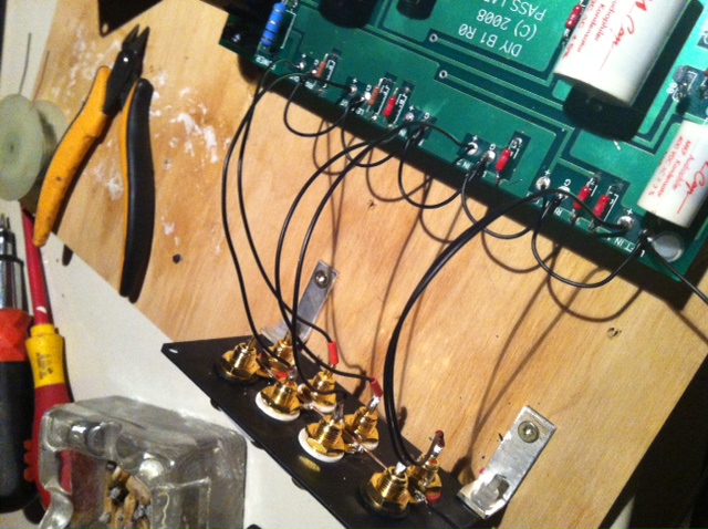

OK , OK I'm as blind as a bat ... It was the we hours euro time But thank you .
Its not 100% clear about the selector switch ,but the socket wiring seems pretty clear .
Will I be able to use Balanced out to my XA's and RCA in from my DAC and Pearl with no issues ? I don't have a balanced source at present ,but the near future may bring something .
I still need to select between to RCA connected sources. Can I just make my out put XLR and leave inputs RCA- again with no issues ?

If you want to go from an RCA input to an XLR, you will need a converter. I used the DRV-134 PCB board from Per-Anders.

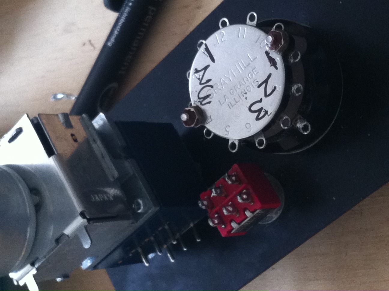

The selector has a ring of pins around the top and 2 pins on opposite sides below them .... Are the lower 2 the ground and the above pins + I have done a test and numbered them . Ground to 1,2 and 3 on both sides . Each side being left and right ?
On the Pot .. 2 rows of 3 pins .1 row per channel ,L & R ,the centre pin of each row being the ground ?
The input on the board is in fact , the output signal to the selector - signal from there , to Pot and back to board ?
I have CCW ,W , CW then CW , W , CCW . The signal from the pot goes to here as my out put ?
I have searched Youtube tutorials and the web, but really struggling . I have a drawing of the selector ( may as well be Mandarin ) Ahhhhh ! I have'nt googled pot yet !!!! Shall do that after Breakfast .
thanks to any that can help , Rich

Rich I think that the selector switch has six inputs and the two lower tags will be the left and right outputs but I would check that with a dmm. The volume controls are pretty straight forward on one channel you have to cross over the outer 2 connections. I think its the right channel but I'll have to take the lid off mine to check.

The volume pot uses the cw, ccw and w connections. Look carefully at your pot for the numbers 1, 2 and 3 by the lugs.
ccw will be the ground connection, w is the wiper on the pot and cw is hot.
Many (most) pots are numbered with 1 being ground or ccw, 2 being the wiper or w and 3 being hot or cw.
From there you are best off sleuthing your selector with the dmm.
Hope this helps.
