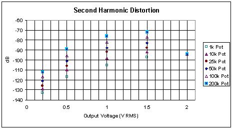

OK here are the rest of the measurements.
1k Pot gives least 2nd harmonic distortion, 200k Pot gives the most second harmonic distortion.
However I really wouldn't recommend anyone using a 1k pot, as this may pose a serious load for a cd player. The measurement was done for curiosity only
that fits with classic circuit theory. Lower Rs gives best performance.
I was hoping you would find an optimum near the recommended 25k (Rs<=6k).
These measurements were carried out using LSK170 spice model.
I will repeat these measurements with Toshiba 2SK170 spice model and report back if there are any significant difereing trends or differences.

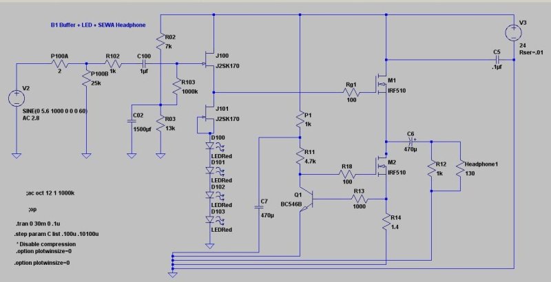

I am planning on grafting a B1 onto the front of a mosfet follower type headphone amp. It has a 24 volt power supply. To be able to directly connect the 2SK170's to the output mosfet, I need to eliminate C101, R104 and R105. To keep the correct bias for the output stage I also need to raise the DC level on the output of the B1 about 6 volts. The plan is to add 4 Red LED's below Q101 and then change the B1 bais resistors R2 to 8K and R3 to 13k. This will also bring the B1 portion back to Nelson's sweet spot of 18V over the jfets. Does this sound reasonable?
Here is the schematic. It's just a work in progress so things like the grounding layout are unfinished.

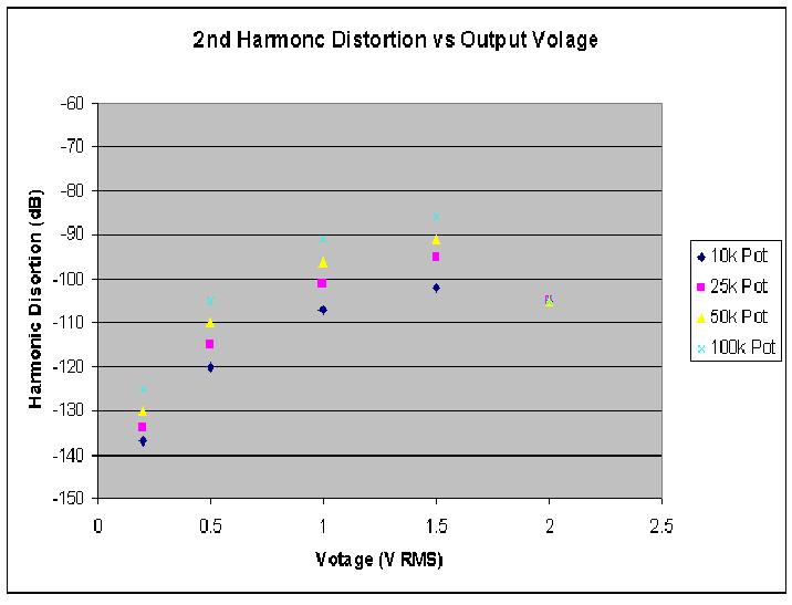

I wasn't going to post these results but since i went to the effort of doing them someone may want to compare them.
These were done using the Toshiba 2sk170 model instead of the lsk170 model.
The trends are the same but the distortion numbers are lower (ie the curves have shifted down)
do they all coincide (-105dB) at 2Vac input/output?
Now we need a real test @ 2Vac using both the LSK and the 2SK.
