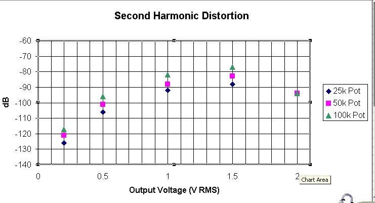

I don't know if this is of interest to anyone, but today I was playing around with ltspice and looking at what effect changing the pot value would have.
Well what I found was going up in resistance increases the amount of 2nd Harmonic distortion (ie going from a 25k pot to a 50k or 100k pot).
While I think a lot of people here are probably interested in minimising harmonic distortion some people might want to experimemnt with this to get more of a valve tone and hence increase the resistance of the pot.
I am planning on buying some cheap pots from Jaycar a 25k, 50k, and 100k and seeing if this effect is discernable to the ear.
The input impedance of the preamp will also increase by doing this.
I am not sure if their will be any negatives by doing this or not but it is definitely worth trying out if you want to inject some second harmonic to the sound of your system.
If anyone is interested I can post some screen grabs of the results.

Well here are some ltspice measurements (2nd Harmonic) done with different pots at various output voltages.
The results were not what I expected (ie the trend of results)
Also one other point, the difference in distortion between pots may not be great enough to discern the difference by ear. So those hoping to inject some tube/valve tone may not notice the difference.
I did do some measurements with a 1Meg pot which gave more significant distortion but I would be a little worried putting in a 1Meg pot that it might have some other negative effect.
The measurements were done at 1000Hz using a 47k resitive load.
It would be interesting how these might correlate with real measurements.

it is fairly common knowledge that most amplifiers perform better when Rs is kept low.
In particular distortion rises as Rs rises.
Your results simply confirm this.
That's why you need to be very careful when using passive pots to drive anything.
try 10k pot and 1k0 pot and add those results to your graph.
The 1k0 pot is equivalent to Rs<=250r.

Just to be sure there is no misunderstanding.
These measurements were taken of the B1 buffer using different pots.
The input voltage was held constant at 2V RMS and the output voltage was adjusted by adjusting the value of the pot.

What I found unusual (to me that is) was that max distortion occured with pot at 3 O'Clock
I am not keen on the idea of dropping the value of the pot to below 10k as this will present a very difficult load to the cd player, and since the B1 has a relatively low output impedance regardless of the pot used, my feeling is a higher value pot would be a better choice (espescially for the cd player.)
I'm not suggesting that you adopt a very low value of pot.
All I'm asking is that you complete the investigation to see if your results can confirm an optimum Rs that allows the buffer (amplifier) to work at it's best.
Measure the resistance on both sides of the wiper when set to 3 o'clock. Is this the -6dB position? If so then it also presents the highest output impedance and again confirms that high Rs is a direct contributor to non optimal distortion.
If you find that the B1 likes to see a pot value between 10k and 20k at it's input, then you have provided good information for other users.

3 O'Clock using Linear pots.
For a 10k pot that would be 2.5k and 7.5k.
I will do the measurements as you suggested but it will have to wait till monday (Aussie Time).

Thanks for posting. Are you using the actual Toshiba 2SK170 JFET parameters, or "generic" JFET to generate these?
From above, the -6 dB position would be the 1V middle readings, which would be the highest source impedance. Oddly they are not highest distortion.
Also very interesting is a 10dB difference between 25K pot and 100K pot. This is a factor of 3X, and is certainly measureable. I can measure to verify the highest distortion spot, 1.5V, my gear can do that easily.
I'd love to see the same runs at 10kHz if possible.

I am using LSK170 parameters from linear systems.
I also did some using Toshiba 2sk170 parameters (not shown here) which gave lower distortion numbers than the Linear Systems model.
I will confirm later whether the Toshiba model exhibits the same behaviour as Linear systems.
