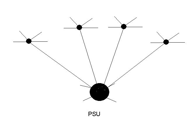

Ground wiring question re. B1
One issue that I have always had trouble wrapping around my brain cells and that is correct grounding in P2P. In some of the forums, the comment is that star grounding is not necessary or benefits are nonexistent. When I viewed the B1 pcbs from Papa, and the schematic, signal and power share the same ground.
So here are my thoughts and please let me know if I'm about to build the world's best oscillator or smoke generator instead of a nice version of the B1 sans coupling caps:
Run 18 gauge solid core around the board and tie resistors, decoupling caps, ground inputs and outputs, regulators, etc. to this ground wire. V+ and V+ will be distributed using 20/22 gauge solid core and signal inputs/outputs will be wired using 24 gauge silver solid core wire.
Does this make sense in a p2p preamp design?:confused:

Salas - something like what I've sketched here?
