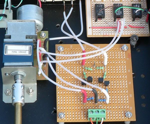

Firstly, thanks to Nelson for this simple design and to Salas for his work on the modified capless split rail version. The one I built is based around the schematic that Salas provided.
Very easy build, doesn't come much more simple than this, and no problems experienced. The circuit is extremely quiet with no associated nasties. I wasn't too sure about no caps even though the previous buffer (BB) in this pre also had none, so I made the board large enough to allow for caps if required.
Upon firing up, the offsets were -3.1mV, +0.2mV and were adjusted to -2.7mV, +0.7mV via the trimpots on the power supply. With these offsets the power supply was doing ±10.1V and never varied more than 0.04V during all the testing. Changing the offsets to equal values did cause the rails on the power supply to differ too much. The offsets and only varied 0.2mV during hours of testing and playing, so no caps were used. Matched pairs of 2SK170BL were used (thanks for them Kovax) and maybe would have better offset results if 4 were matched.... dunno.... but the offsets I have is fine.
The initial tests and listening was done with a 10K Alps RK27 as that's what was in the case and the sound was as expected.... very transparent, open, smooth, good dynamics and wide range, in other words, much better than a standard passive but with the good attributes that a passive can provide. The 10K pot was then changed over to a 20K Alps RK27 and the sound was not quite as good. Some of the dynamics were lost, bass seemed more recessed and not quite as open. So the 10K pot went back in as well as the wiper shunt resistor changed to 100K from 220K. This is where it has stayed. I have no idea if the sonic variation was due to the quality of the pots, but both are Alps RK27 motorised and about the same age.
It was tested in 3 systems and 2/3 performed extremely well with one not reaching the full potential on offer. I think the simpler the system, the better the performance with the B1 and has ended up in my office partnered with an AudioSector LM4780 (reduced gain) and some Vifa based nearfield monitors. The B1 is just what the doctor ordered in this system and has taken it to a new level.... plus no additional gain.... woohoo. For those with ChipAmps and simple speakers such as fullrange, I think the B1 could be the ticket to better sonics. The other system with great performance used a Anthony Holton NXV200 and a stand mounted 2-way using Vifa XT25TG / Scan Speak 18W8531... the NXV200 never sounded better.
There will be more of these made for sure as I can think of a couple of other uses for the B1 (and no GAIN.... great).

rabbitz said:............ Changing the offsets to equal values did cause the rails on the power supply to differ too much. The offsets and only varied 0.2mV during hours of testing and playing, so no caps were used........
I think you mean did NOT? might not be obvious to non-native(?) English speakers 😉
Nice one rabbitz. Congrats. I selected my 2SKs very closely, virtually identical. Your offsets are fine too.
Re: Re: B1 born in the land of Oz
I meant "did". You had me going there as I'm partially disabled and tend to hit the wrong keys or type slower than the brain so I miss out on key words.
When I adjusted the offsets to about the same numerically (1.4mV), even though one was +ve and the other -ve, the rails were quite different. I'm trying to remember but it was something like +10.1V and -9.4V so I decided to keep the rail voltages the same and have and extra 1.3mV offset which is no problem.
Salas
The next one I build I'll try and get them closer, but hey, a few mV here or there is not going to upset me.
