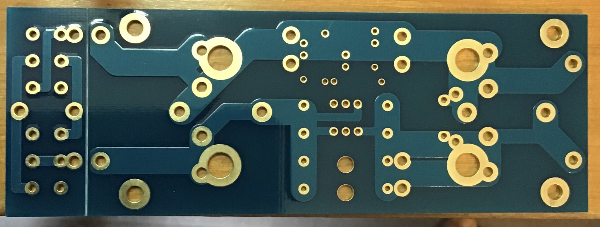

Power supply schematic? If no, what is the regulator? Is there a bleed resistor? Post pictures of the bottom of the power supply pcb and details of the top side of the board if you do not have a schematic.

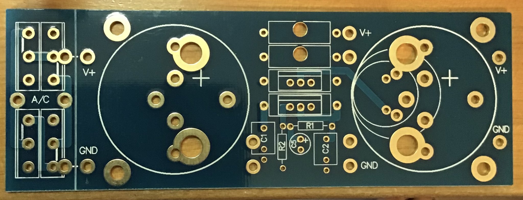

So you should have ~24VAC feeding the PS board prior to the diode bridge, the VDC measured on the first big cap should be ~33-34VDC and the regulator (I'm supposing for the B1 is 18-24VDC) output as measured at the output of the PS board is 18-24VDC?. This tranny + PS works correctly, yes? No blown fuse? The B1 circuit should only draw 20mA max. Disconnect all the signal inputs & outputs on the B1 (leaving just the +/- DC input) and just see if powering it up blows the fuse. Take the board out of the case and just put it on something non-conductive to do the power up test.
I looked at the board pictures and the K170s, the caps and the one diode are mounted correctly as far as I can see.

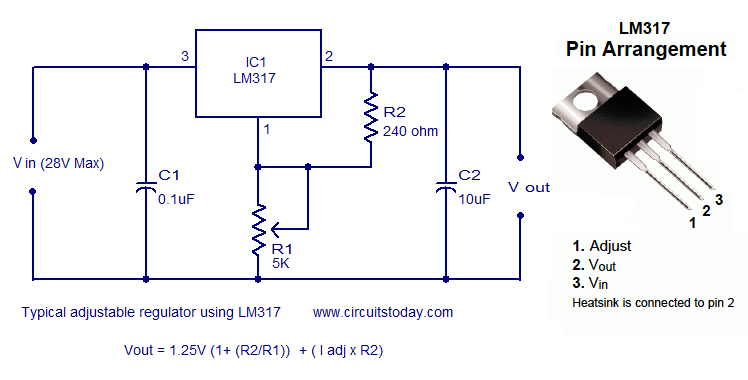

What is the design output voltage of the power supply? What is the measured output voltage of the power supply with the B1 disconnected? Designed for 18V - measures 18.2V
Power supply schematic? If no, what is the regulator? Is there a bleed resistor? Post pictures of the bottom of the power supply pcb and details of the top side of the board if you do not have a schematic. schematic is basic LM317 setup for 18V I believe the resistors between LM317 and last capacitor will act as bleeder as well as setting the voltage?
the values are of course different than this picture - and I am using fixed resistors.
Pictures of PSU - PCB (a spare I have)
