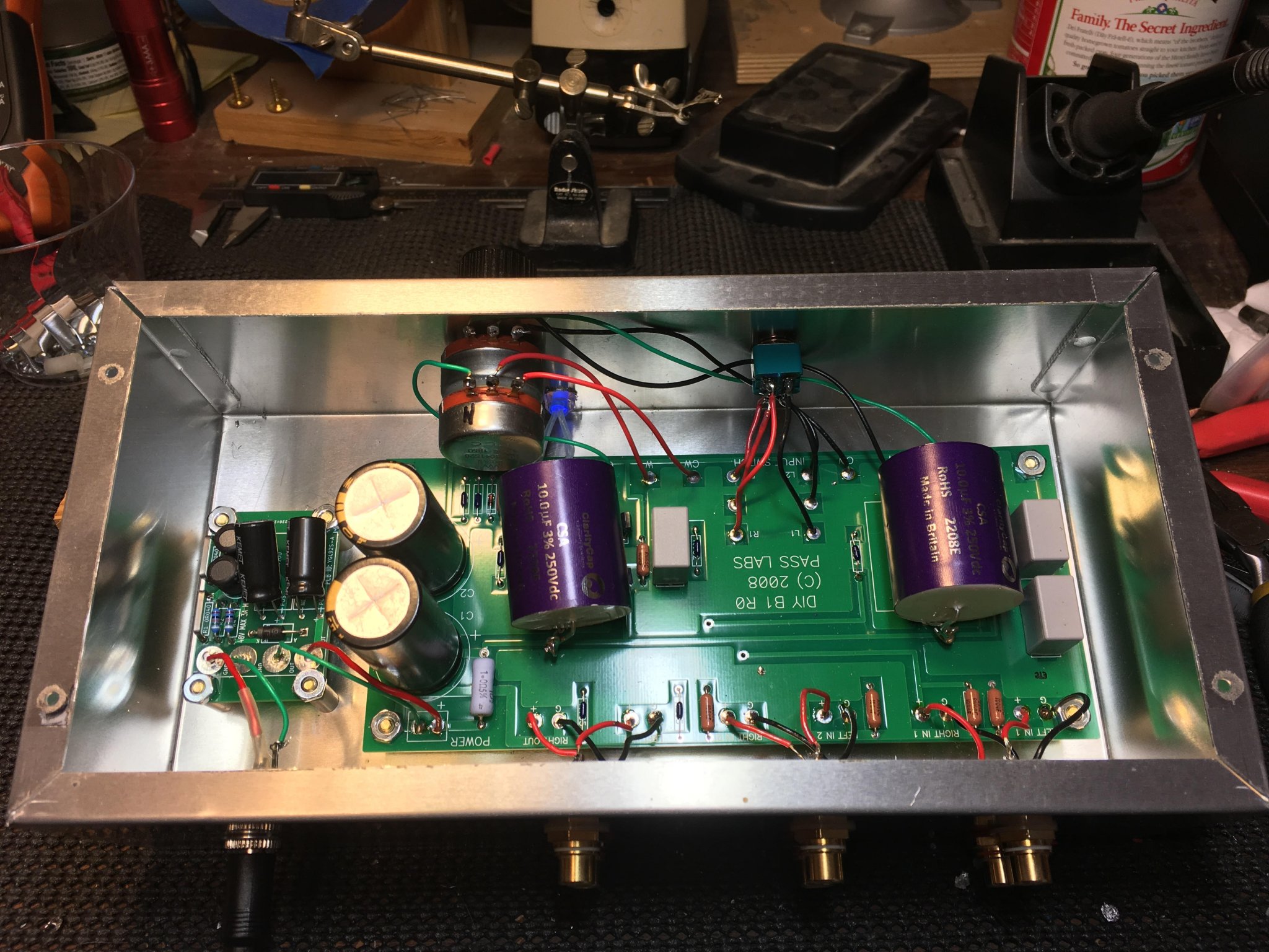

My Allen Wright style phono stage and Cinemags can power a small city even off the ZYX Bloom but I've stubbornly stuck with a traditional line stage as all my past attempts at going passive were, Meh. But there's 20 feet of interconnect between the line stage and the 60 Watt Mullard circuit style mono blocks so a Buffer was appealing. I had the Schiit Saga+ in last year and it was plastic sounding. Adding up the cost of the PCB and parts I thought, why not. So here we are.
The 76 has a Goldpoint V-24 and the B1 got a 100k PEC from the bin which makes it, the B1, even Rocky-er. Nonetheless, where the Bass Guitar and kick drum on the Neville has slightly more impact with the 76 than the B1, the latter does a better job, slightly, of a thunk being a thunk and a thud, you get the picture. Tonal balance bottom to top, a draw. Purity, as on Alison's voice or Adam's Mandolin a point to Nelson. Being an orchestral Trombone player I've had way too much time while counting bars to be aware of who sits where and plays what in the standard repertoire so Soundstage is of utmost importance. The B1 is ever so slightly better at positioning and audibility of instruments but that comes off as juuust a touch of solid-statey detail at the expense of music; the 76 creates a more "believeable" position of 100 instruments in a hall. I can't say much about the Turandot, when I listen to it all thoughts of analysis exit stage left.
I've got $230 in bills from Digikey and Pass DIY plus 3 pairs of Vampire CMHex, a TOCOs Toggle, and the PEC from my bins, another $80 or so for a total near enough $300. "They" say component retail is 10X manufacturer's cost so the 76 would be $11,000, the B1, $3000. On a value scale, assuming a Buffer fits the system, I'd place the B1 within a thou$and, maybe 2 at most. Now what am I going to do with two outstanding components vying for playing time?

How important, or not, is having the B1 in a metal box? Thinking of a new build with walnut chassis and alu top plate like all my other gear. I'm in an apparently very benign RF environment.

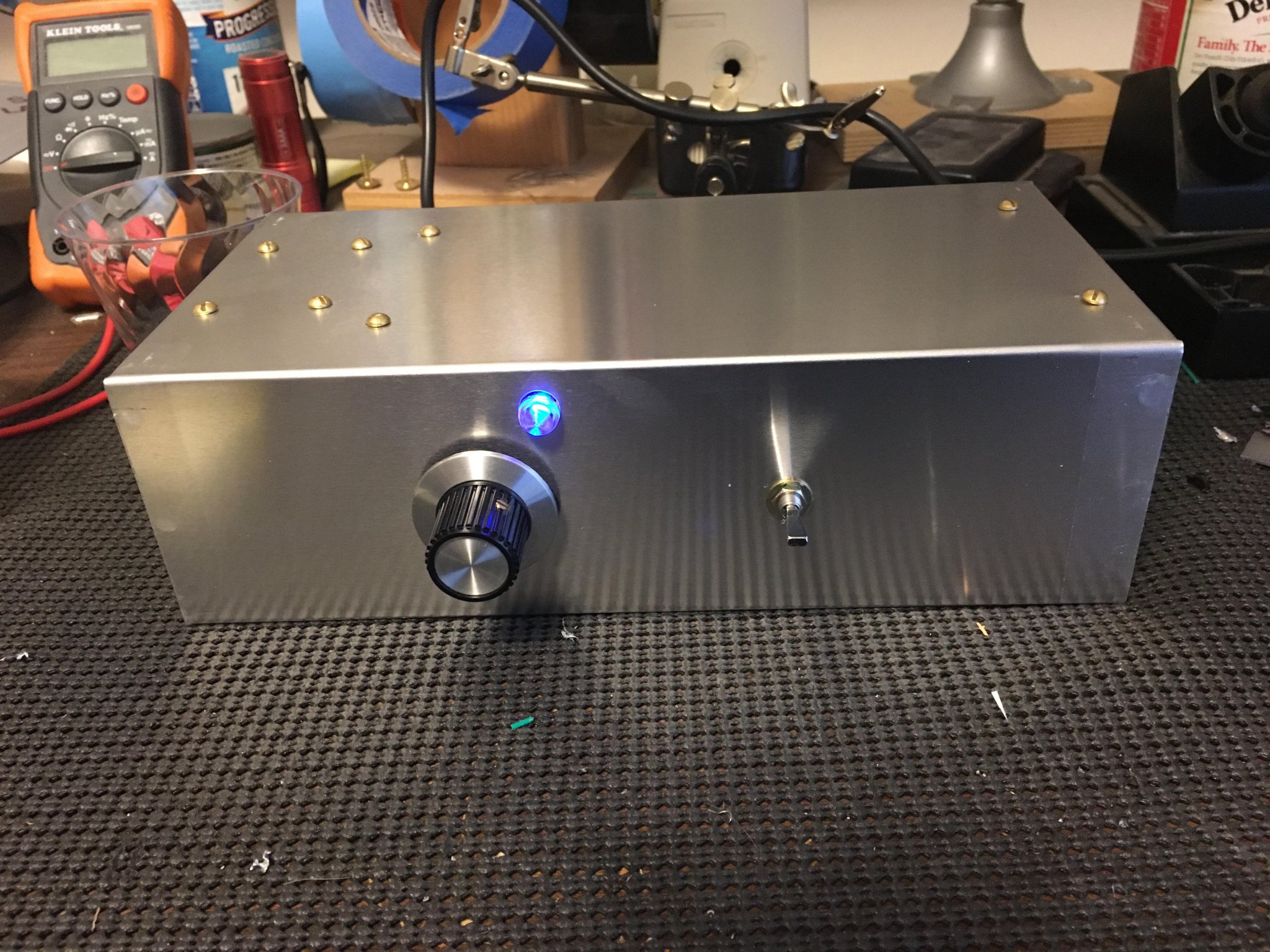

Next question: the first time I tried to place an LED where I wanted it was a mess of wires and caulk. The next time, about 15 years later, the B1 I just built, I simply positioned the PCB close enough to the front that bending the wires put it in view. But not where I wanted it.
Is there some conventional method all you solid state guys know for a neat install away from the board? Us tube heads aren't real big on running lights 😀
I usually drill a hole in the panel just big enough so the LED fits and is held in place by friction. A twisted pair of wires connect the LED to the dropping resistor and power source.

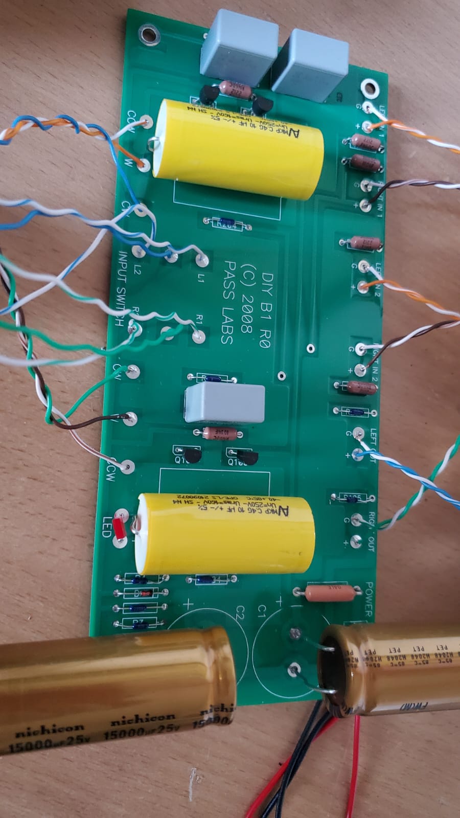

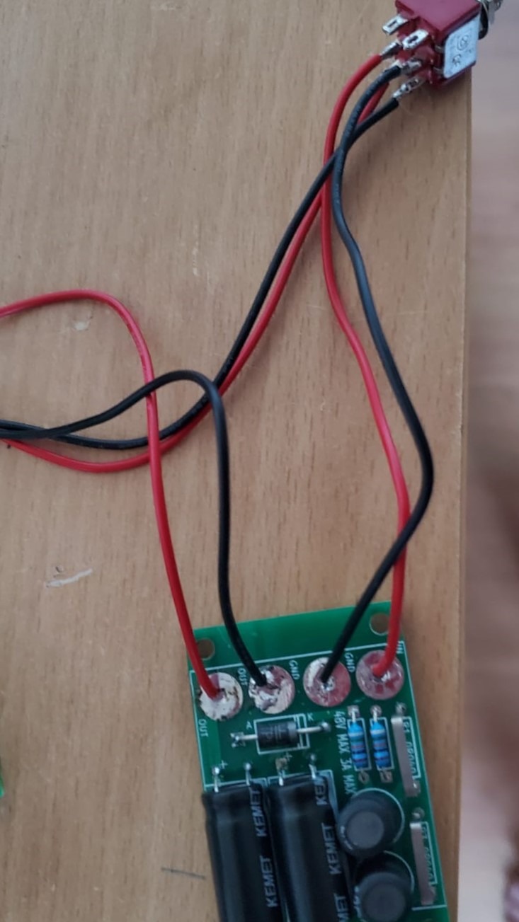

I just finished building this project. I previously owned a Pass B1 Korg, but wanted to try this one out. Although Im not being able to light it up, the included LED is not lightning up. I uploaded some pics from my build, I've used some of the recommended electronics plus a SMPS DC Filter P089ZB, which I know it works because I was using it with my B1 Korg
Not enough info, maybe leds are in backwards?Hi,
Do you see voltage anywhere?
Of course check that you are seeing the right voltage across the LED thu holes on the board once powered up. Here you can use your DVM to check the voltage polarity and then match that with the LED. You can determine the LEDs polity either by looking at its data sheet, or the way I do it, is to use a DVM's diode test mode. It won't fry the LEDs with too much voltage (forward or reverse), which is what can happen if you just insert an LED into a spot backwards.Hi,
If you've tried the LED in both ways and its failed, you've fried it (or it somehow got static zapped or is defective). Try another one. The good news is that LEDs are wicked cheap. 🙂
Revisiting the article, the answer appears to be yes:And on this board, the only thing the LED does is light up, right? I mean, it's not used to set a voltage reference or anything like that.
I did once connect the power backwards, and that fried the electrolytics....
"D2 is a generic LED for indicating power the board."
Its not a big deal. Remember, we all started somewhere. And also Nelson's guiding wisdom: "This is entertainment, not dialysis". 🙂yeah well, I'm embarrassed to admin my largest fail so far, so I didn't know LED could be backwards and turning it around happened to be the solution, sorry for that
