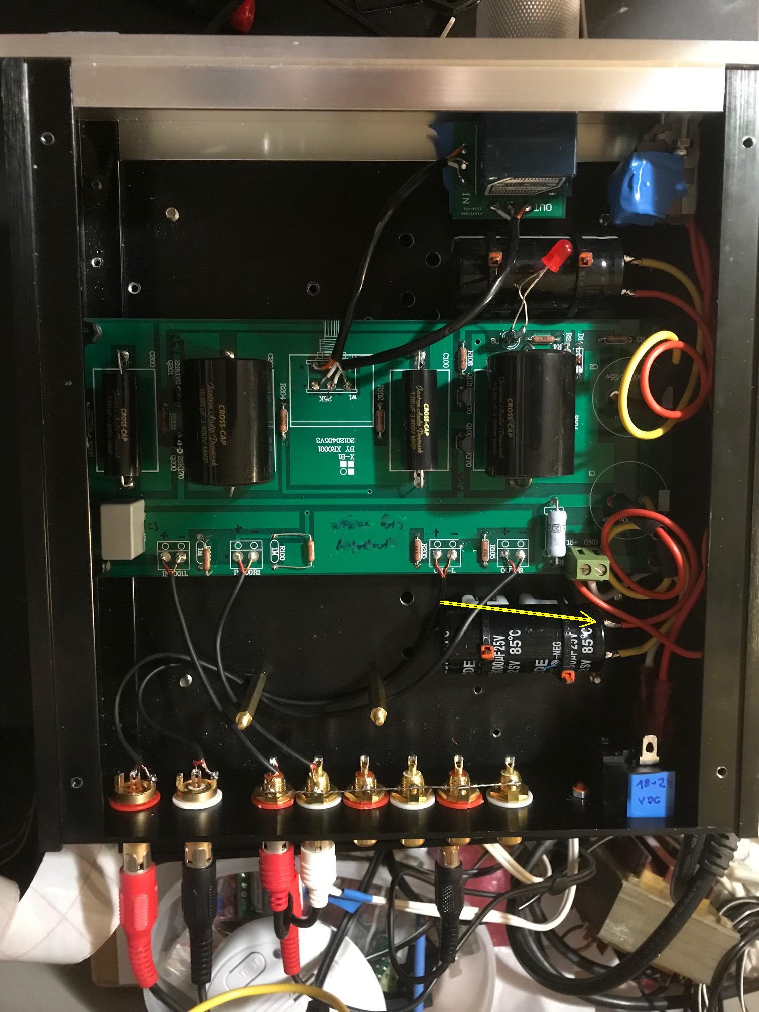

Sounds like you may have an error in the wiring of your B1 that is loading down the power supply. The B1 draws very little current, so unless you have an inadequate wall wart it should work.

...if you're sure in your build...
Heh, heh. I was sure of my build... until I wasn't.
After looking more closely at my wiring I noticed that I had + - input leads backwards. The twisted CAT5 were hard to see which one was solid and which was striped. 😱
After correcting that, the B1 is now as quiet as an undiscovered mummy's tomb. The Mean Well GS06U-6P1J works perfectly and only cost US$12.00. 😀

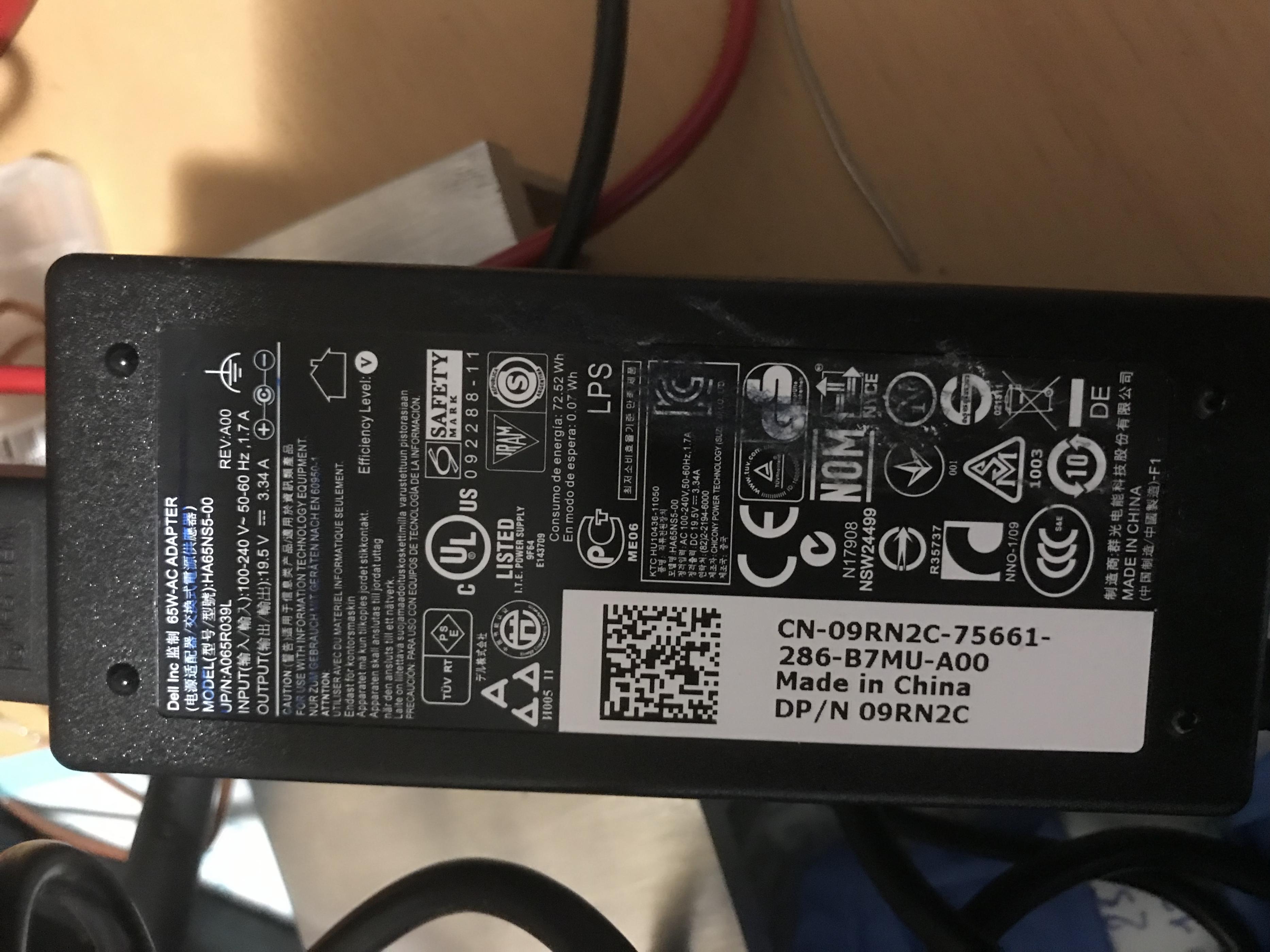

It's not exactly a wall wart. Syl20m posted, "I am using a computer brick to power up my b1!"
Some laptop power supplies have under/over voltage protection built in to protect the computer's battery. This could be the culprit.
I found a link to someone who disabled theirs.
As I said a few posts back, my $12.00 wall wart works perfectly!
Hi all,
Some of you are wondering about what PSU I am using !
So please see the model on the picture !
This laptop charger goes indeed in some protection mode when a pop occurs if powering the ACA first and then the B1!
I must unplug the charger from wall socket to make it work again.

I just replace the R1 1r to a 10r and now quite no pop and charger does not go
To safety state!
Then I have tried 20r , but it does not help further more!
I have to try now to take out C1 15000u out as Zen mode suggested, or replace it by a smaller one?!
Anyway this is already quite alright, as b1 should be power up first , which in that case does not produce any pop!
