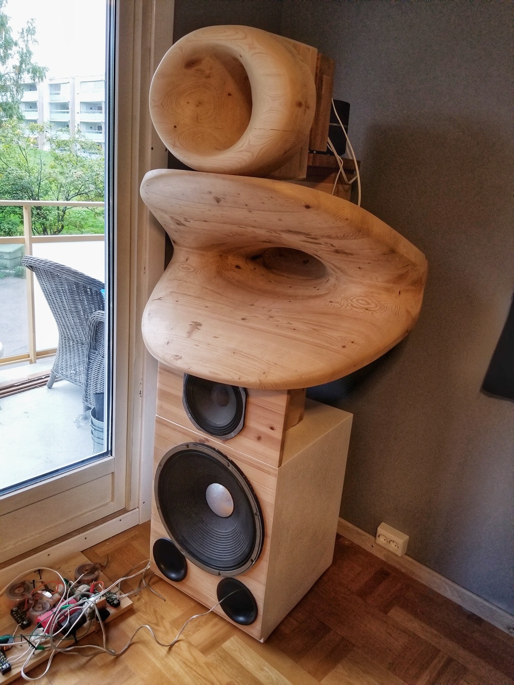

I have a multi-amped, multi-horn system with a JMLC Iwata horn as mids and Raal in a horn on top, planning on more horns and a smaller horn for the Raal. I am having a constant headache when changing between music and movies, because the volume level is so different at the source. After going through tube amps and F5 and soon F6, I would be happy if my final solution ended up being five F6 with five B1. Trouble is the 800W bass amp, but I guess bass is always a heachache.
Does anyone have a good solution for building five B1 preamps to control five amps simulataneously? Don't say that the best solution is a rubber band on the volume knobs. I am getting old, so a remote would be nice.
