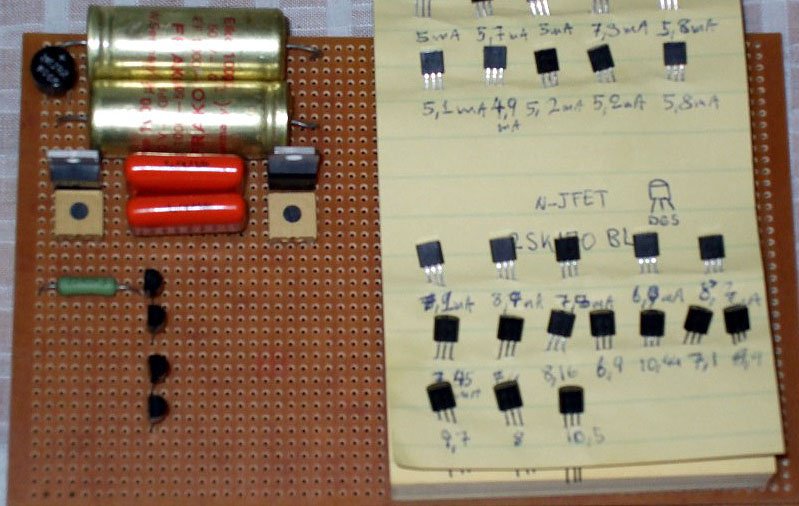

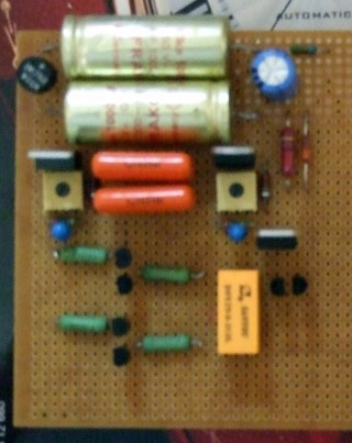

Basically what I have done by now
Found some spare time, and populated the perf-board. Done half the point to point also. I am putting together 1 positive & 1 negative regulated PSU, 1 output delay relay circuit and 2 channels of capacitor-less B1s. Hopefully in the next few days I will find time to finish it and test it little by little. Will report.

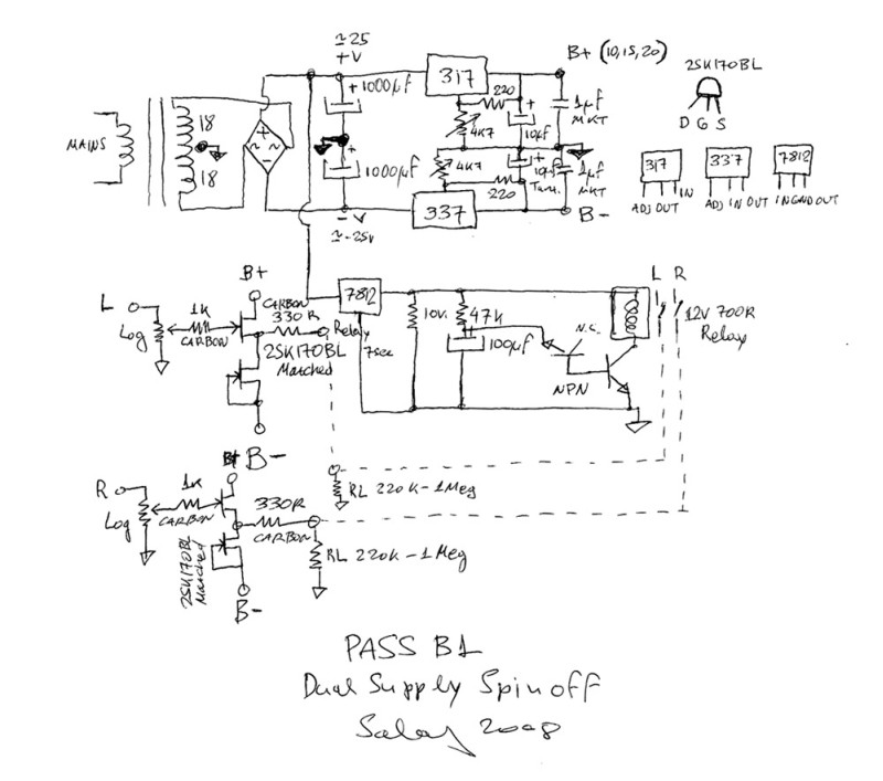

Next post includes the awfully sketched schematic.

Regarding the output resistor....
Does Nelson have a reason for making this 1k?
Is this to guarantee safety in the event of a short, or does 1k give better isolation from cable effects, or change sound quality relative to 330 ohms or so?
These are against oscillations due to the wide bandwidth too. I will check with high frequency squarewaves. Such stuff depends on layout too. Mine are hardwired directly to the Jfets. This circuit is in experimental early stage.
