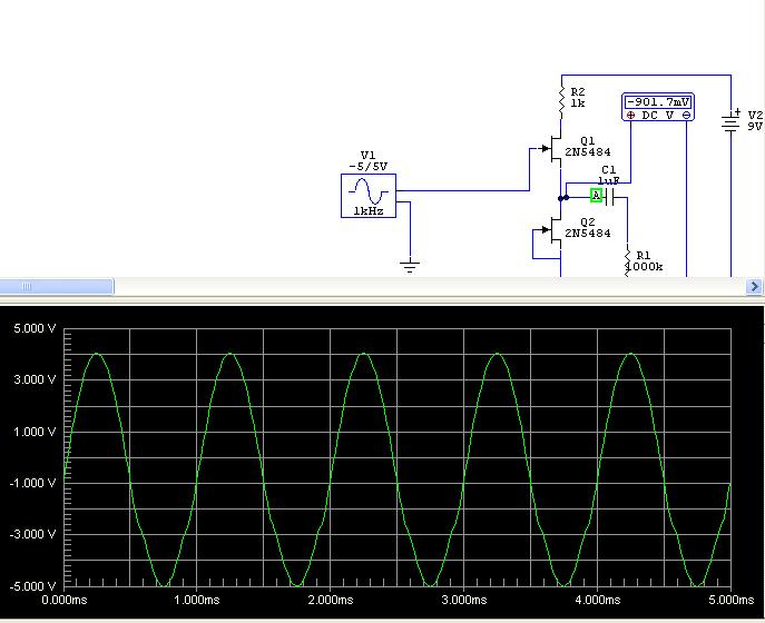

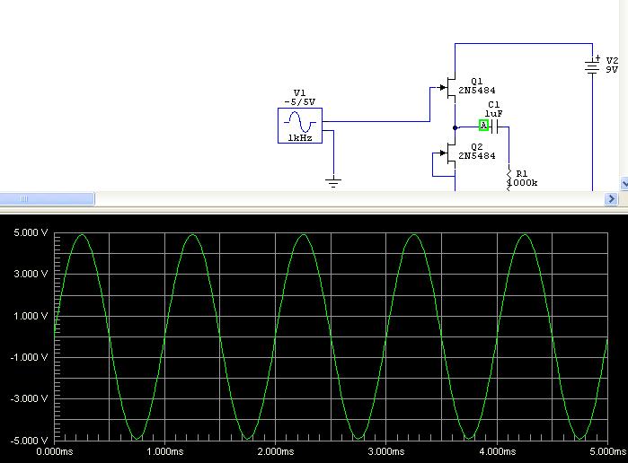

It will move up the center line of the waveform by 0.5V, it will rob that from available headroom and it will translate to some 2nd harmonic also. That 0.5V it will appear at the output.
I have introduced -0.9V DC offset by asymmetric positive rail, using a resistor between B+ and upper FET. See what happens. Moves down in that case.
BTW, if you need a trimmer to null positive offset, you have to introduce it in the upper side. If you want to null negative offset, you do it vice versa. Or you use 2 trimmers and you match whatever JFET or PSU irregularities.
Pic1. No offset:

float said:
Thanks again Salas.
BTW, could the distortion in your second image (0.9 offset) have anything to do with a 10v signal and only 9v power supply?
Remember that we are discussing the bipolar B1. There is a -9V B- also. It is just obscured by the sinewave foreground in the picture.
