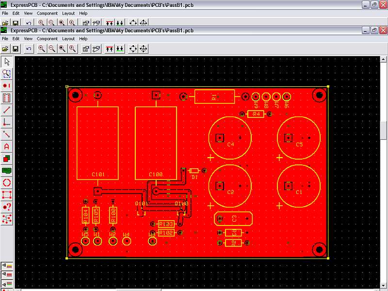

I am using this transistor.................
Phillips BF861B
This one is available from DIgikey. It seems to match the specs quoted in Nelson's article, it's cheap, and from the datasheets- it looks to have good performance.

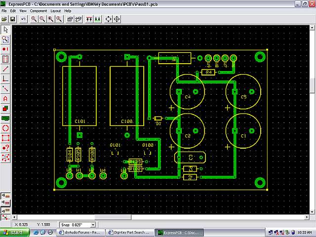

I have attached my design of a pcb that I came up with in order to utilize the smd jfets.
I'll attach the other one without the ground plane on the next post.
Here's another one..............
This one is sans ground plane.
You would need two of these for stereo.
As you can see, the PSU is on board; the electrolytics I'm using are 2700uF Panasonic FM.
There are pads on the board for power in out, led, input, and the pot.
Also note that here is room enough for those big-honkin' coupling caps that we all like to use.
I wanted to purchase Mr. Pass's boards, but I didn't know if they would be configured for SMD devices.
Thank you for sharing your designs with us Mr. Pass, I've been waiting for a simple design like this for a while.

BTW..........................
I've been reading some of the posts about using a battery supply for this buffer, but in my opinion- the current draw in this circuit is so low- and the capacitance is so high that all you'd really have to do is perhaps use EMI filtering on the AC side- and refrain from using switching power supplies.
As far as the rectification in cheap "wall-warts" go, you could always opt for an AC "wall wart"- and use hexfreds on the board itself.
