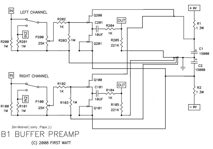

B1 is exactly what you need for chipamp , either it is inverted or not ;
you can rid off input cap in B1 if you feed it with +/-9V , tying input gate to gnd , instead to resistive divider on half PSU voltage , as in original B1
Thanks Zen,
My chipamp is a non inverted one : http://www.diyaudio.com/forums/showthread.php?postid=1569138#post1569138 and these are the schematics: http://www.vikash.info/audio/p2plm3886/
I have a spare 2X18V 300 watts toroidal transformer and I wonder if I could use it with a regulator for the B1 project. I really do not understand what you mean with feeding the B1 with +- 9V. The schematics say 18V.
Antonio

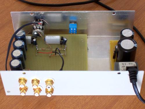

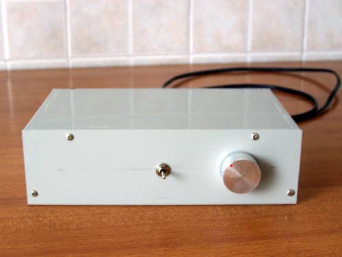

Personally I have been sitting with my F3 for months , listening , playing my instruments with music , wondering how good that amp can be .
Now just give me some days , for having some "experience " with the B1 which is playing very very well , and also let me take some pics of it to let you see.

A Sanchez said:
Thanks Zen,
Antonio
in 10 min. I'll post re-drawed circ for you
edit :
little more than 10 min ;)
here it is : you can mount it in same case with chip/drek amp , using any type of IC or discrete voltage reg , to have nice and stable +/-9V , from same PSU ( of chipamp ) ;
dunno - probably LM317/LM337 will do the job for you , or nice discrete zenner followers

Thanks for your replies.
Zen thanks for the schematics. Yes it seems really easy and I can put it inside the same box as you say, so I only need the few components and perforated board. I will definitely give it a try.

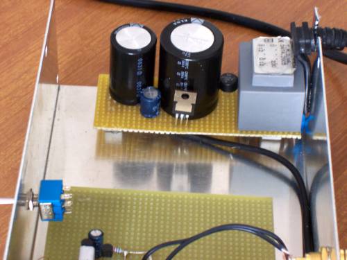

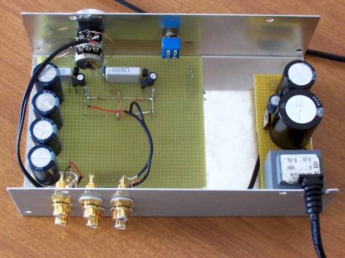

Anyway I didnt finished to work on it as you can see there is lack of input and selector connections . I was too busy in listening to it , and mainly arranging the ground .
I have found the less noise connectin both input and output RCA ground to the chassis . The circuit ground goes to the chassis throgh the output point .
It seem to me perfectly quiet , which I consider a luck since the circuit is p2p builded .
