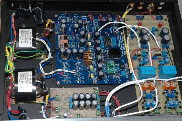

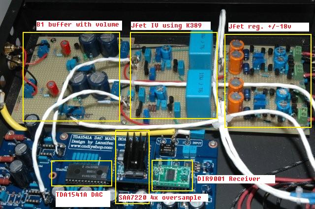

Implemented the B1 buffer in my TDA1541A DAC as follow:
DIR9001 --> SAA7220 4x oversample --> TDA1541a --> Jfet IV --> 10kA volume --> B1 buffer.
Now the DAC can directly drive a power amp and it sound wonderful!
Thanks Nelson for sharing the new designs.
Spencer
Spencer
The B1 has following component changes due to on hand part availability issue:
R1 = 0.47R
C1 = C2 = 1500uf 35V
D1 use green LED
R202/R204/R102/R104 = 680R
C100/C200 use 0.47//0.68uf film cap
P200 / P100 = 10kA type Alps
C101/C201 = BG 10uf 50V N series
K170BL use 8.2mA Idss.
Cheers.

Are the JFET I/V schematics shown somewhere?
Thanx!
