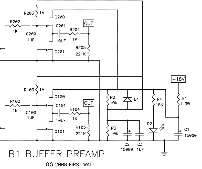

Hi, Sorry if this has been asked before.
Can the B1 take 2v DC on its input? I want to put the B1 directly after a voltage output DAC chip that has 2v DC on it.
I have a blocking cap on the both the input and output of the B1 right now but would like to omit the input cap if it's possible to do so safely. Will keep the output cap in place to block DC from the buffer to my amplifier input.
One less cap in the signal path seems like a good idea 🙂 .
Anyone know if this is ok to do?

you can't do that if you're using B1 with single supply
TV Man said:
Yes, it's single supply.
So we can't have any DC on the input of the buffer even if we have DC blockers on the output of the buffer to stop the DC from being passed to the component downstream. Is it a bias issue?
Thanks,
exactly - bias issue
you can try that , but only if you use split PSU , counting that lower JFet will do biasing and compensate that 2V shift ;
Ok, thanks 🙂
I was looking at Mr. Pass' schematic on enjoythemusic.com thinking C100 and C200, the 1uf caps right after 1k ohm R102 and R202 would block DC at the input of the buffer making it unnecessary to have a DC blocker on the output of the component in front of the buffer.

that's different than your previous asking ......
like this :
Assuming that I'm understanding the question correctly, yes, the caps will block DC.
As long as the DC does not exceed the wattage rating of the pot--no problem at mid or low point, but possibly so at nearly full volume when the heat is dissipated across a very short length of resistive track--then you should be okay.

The input impedance of the circuit is very high, so it would take a
scary amount of input DC.

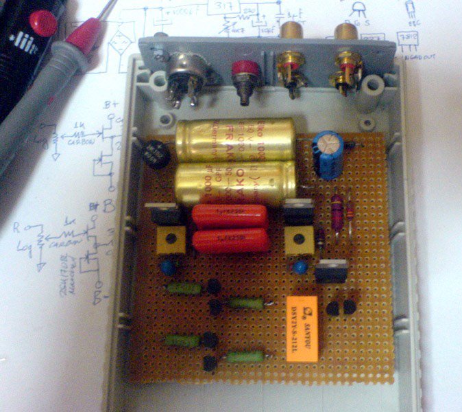

Just a little progress...
Found some time today and did most of it. I hope that I will be in operating condition soon, maybe in the weekend, so to test its various aspects.
