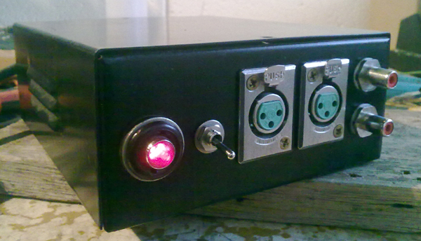

Another B1 Lives..
Another B1 Buffer stage using the 2SK170B
No pot on this one, just a fixed ~10M input impedance and large 100uF Silmic output caps to drive a LF amp from 20 - 200Hz in parallel with my main amplifier.
PS is schottky bridge - a couple common mode 10R resistors, 28kuF - 130R - then 15kuF - 10k - 15uF as per the schematic, drawing an extra 38mA through a 470 bleeder on the first cap to lower the voltage a bit to those 25V rated 15kuF caps. Sets up with 18V C1, and 9V C2. Ground lift on front panel, unit will be energised with switched active from LF amp.
Enclosure and transformer were part of a regulated battery charger supply, part of an alarm system left in the ceiling space of a de commissioned factory 🙂
Really quiet, and dynamic sound running full range. Really impressed, should suit its intended purpose nicely.
Thanks for making the design available, and thanks to Andrew for answering the questions needed to bring this to fruition.
Shane
