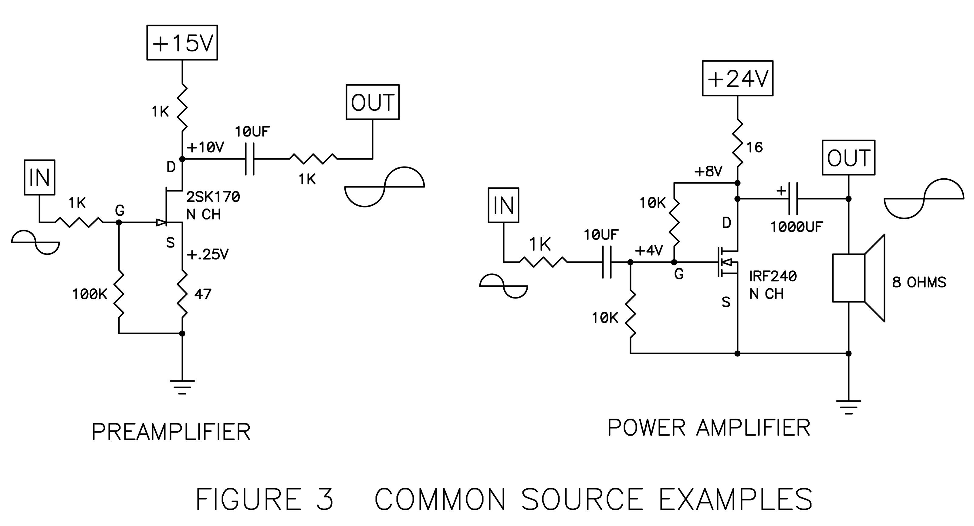

C101 and C201 I just measured ?
Right Channel
After cap = 04.0mv slowly dropping lower over time
Before Cap = 7.3v
Left Channel
After cap = 24mv slowly dropping over time
before cap = 12 or 13v but is slowly changing over time too
I guess if i left it on some time it would become stable but it doesn't look to good!

If the JFETs are reasonably well matched, the output (before the caps) should be at half the supply voltage, looks like you have a problem with the right channel.

Already mentioned above, the DC voltage before the output caps should be about Vcc/2 with well matched FETs.

This seems broken.
Most properly built B1 have zero Output offset. The DC blocking cap and the leakage to signal ground resistor ensure the output offset is zero.
0.01Vdc = 10mVdc is wrong.
0.34Vdc = 340mVdc is broken.
So Im thinking that the B1 I got was from china, possibly dodgy fake transistors causing the problems. SO before i give up on B1 am going to order some 2SK170 from germany, no wonder the sound didn't sound good before!
