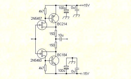

I did it with 150ohm and it worked wonderfully. Quite a few others have used 220 ohm and reported back nothing but good.

I did look at those schematics but I got the impression that they were just variations of the original.
The original simple compound buffer by JLH is a well known circuit. Its a low power mixed genre Sziklai. Higher Ygfs JFETs, more bias through better BJTs and an offset balance trimmer take it further. Expect a different sound than a B1 that may compliment different systems and likings better or not.

JLH Buffer
The circuit that Katie and Dad shows is virtually exactly the one I have just built. The two 150ohm resistors are , instead, a 1k trim pot in the circuit I have. (The circuit I have is in the "Audio Design Amplifier" project in ETI Electronics Digest Winter 1985 / 86). All other components are as specified and were obtained from Cricklewood Electronics. The PSU is from the "low current" section of the ETI 80 Watt power amp PSU with resistor values recalculated to suit my input / output voltages. The ripple eater or "shunt regulator" part is also JLH and was published, again, in ETI April 1994; I just combined them both on a single PCB (well two to make the dual rail supply)! I sure didn't mean to dis the B1 because it sounded very good but, in the end, it just lacked drive and excitement but this JLH arrangement sounds magnificent in my system.

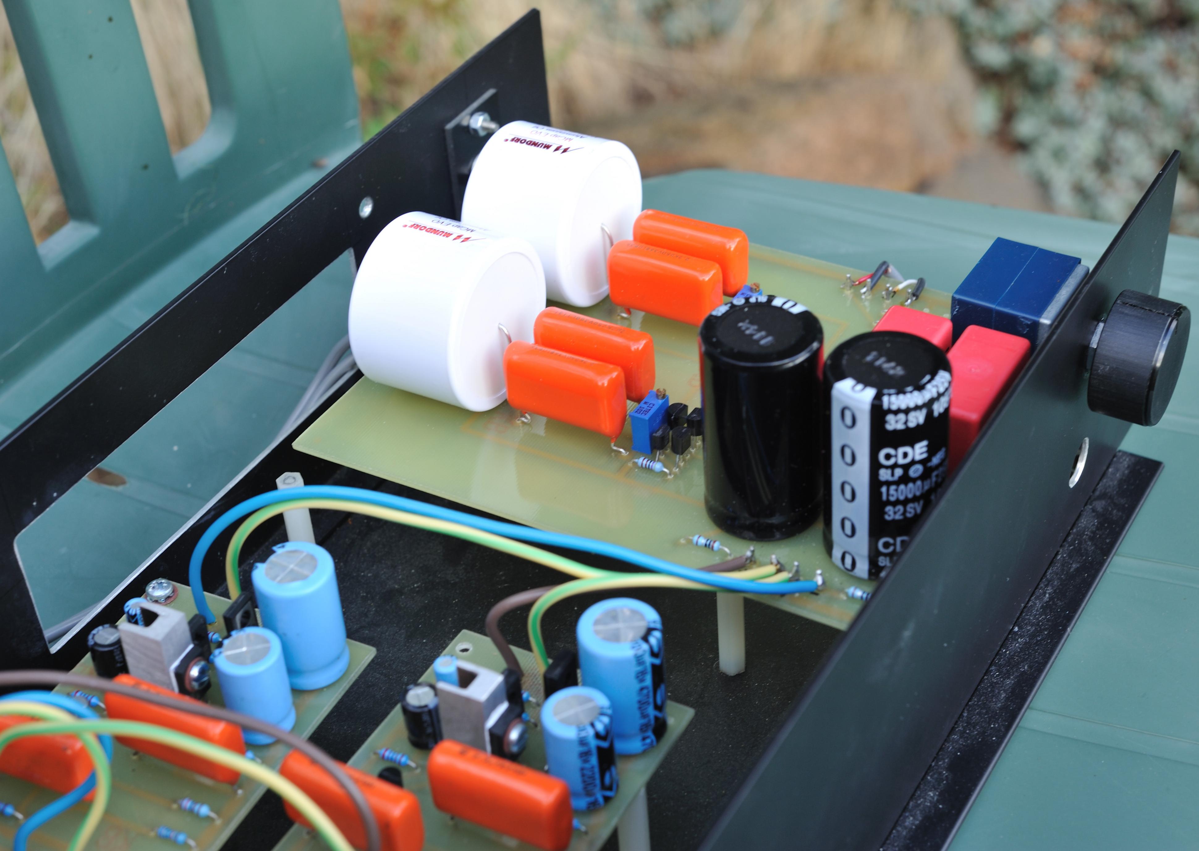

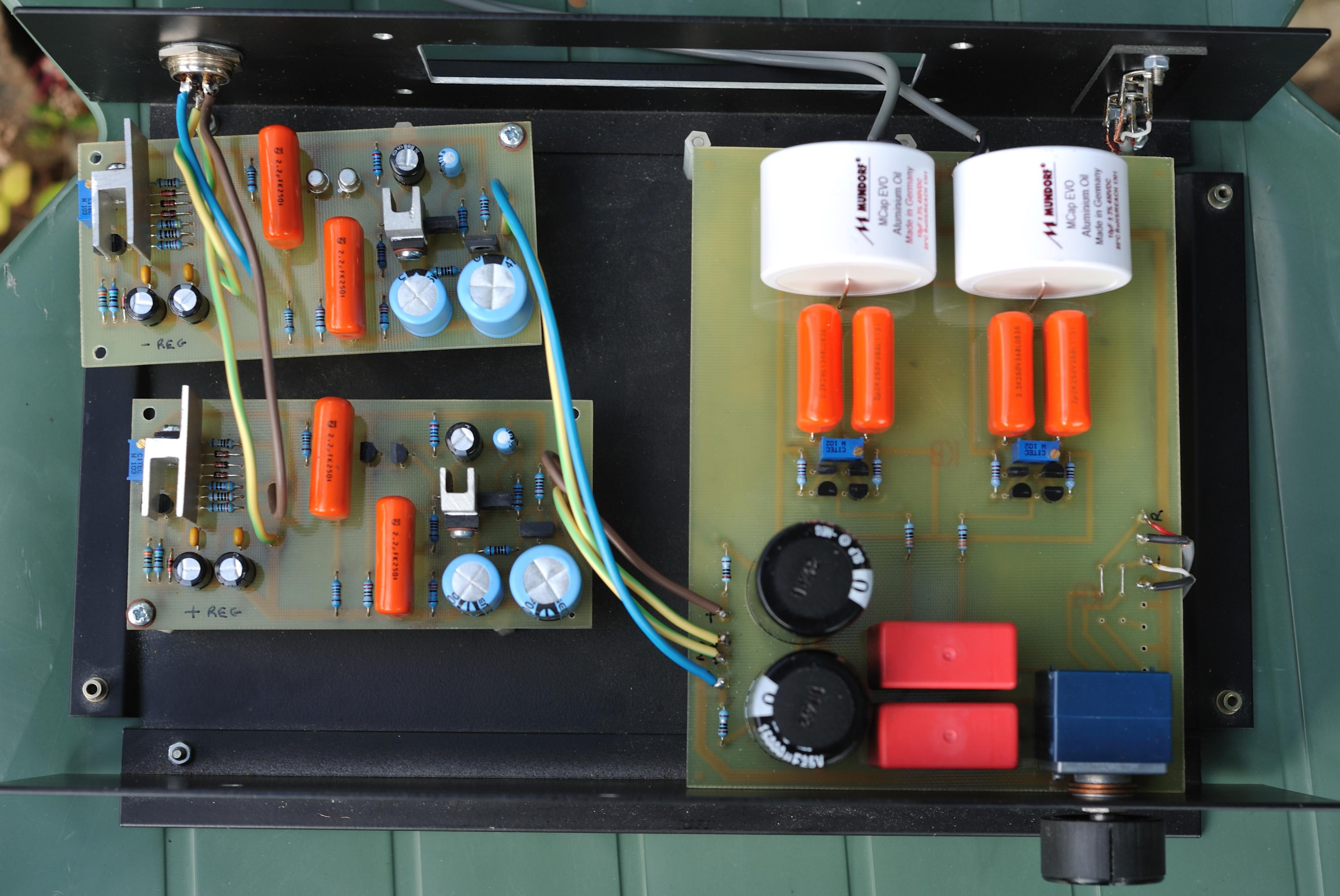

I just built a B1buffer stage within a box with remote volume pot & input switching. I cannot believe how good this sounds, I've used a TDA1543 to supply two digital inputs and have two additional analogue inputs, the DAC and B1 boards are fed by Teddy Pardo Teddyregs, the volume pot & switching relays from a simple LM317. Despite the messy wiring and budget-level components, it is dead quiet and very transparent. I'm alternating between Ncore and Fetzilla amp stages to see which has the better synergy within the system, both sound good.
I used 200K resistors instead of the 221K - anyone care to let me know if this will make a noticable difference?
It's an elegant design, I like it.
It's an elegant design, I like it. (I mean the circuit - not my build which is like a spaghetti bolognase).
