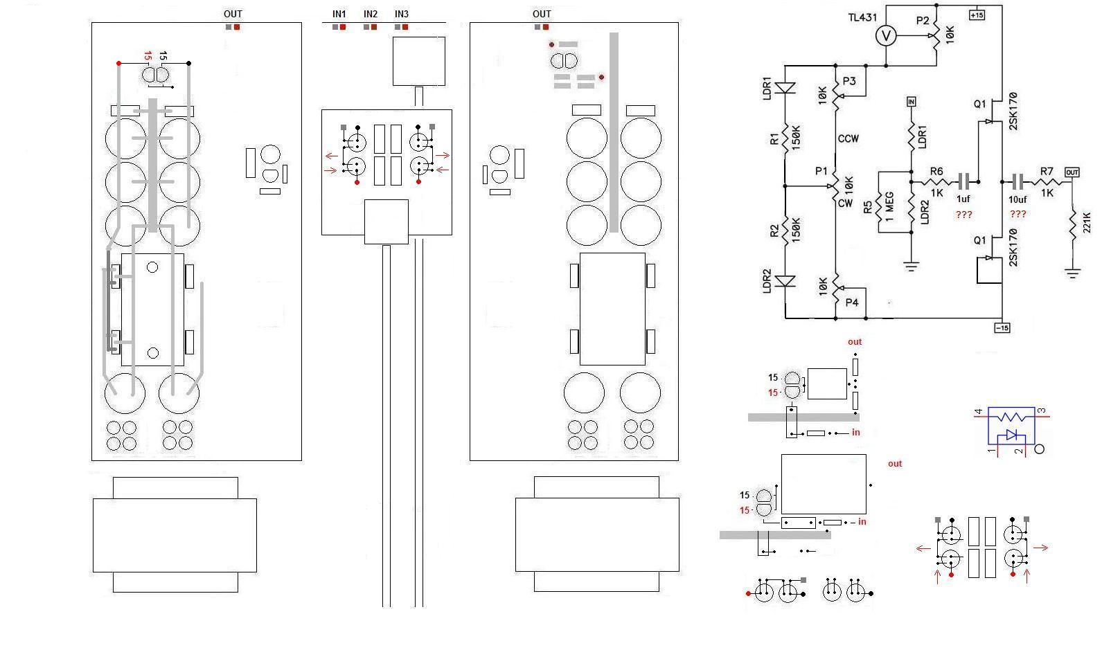

Subwoofer output on a B1?
I would like to add a subwoofer to my current system, already including a very nice sounding B1.
How can I best implement a sub-mono output?
The sub can be driven from a stereo signal or a mono, but as it is lokated approx. 5 meters from pre I would like to only use 1 cable...
The sub input is 33k...the main amp have 100k input...
1) Can I make a simple summing output without degrading main output on B1?
2) Or would it be better to drive the sub with stereo signals parallel to standard output?
If your sub already has a gain control you should have no problem. Send it left and right signals.
ehh, I take it I need a 4-deck input selector, if I want it to switch the grounds as well :scratch1:
and I will need the input cap and out cap from original B1 schematic too, as shown
or only the one on output 😕

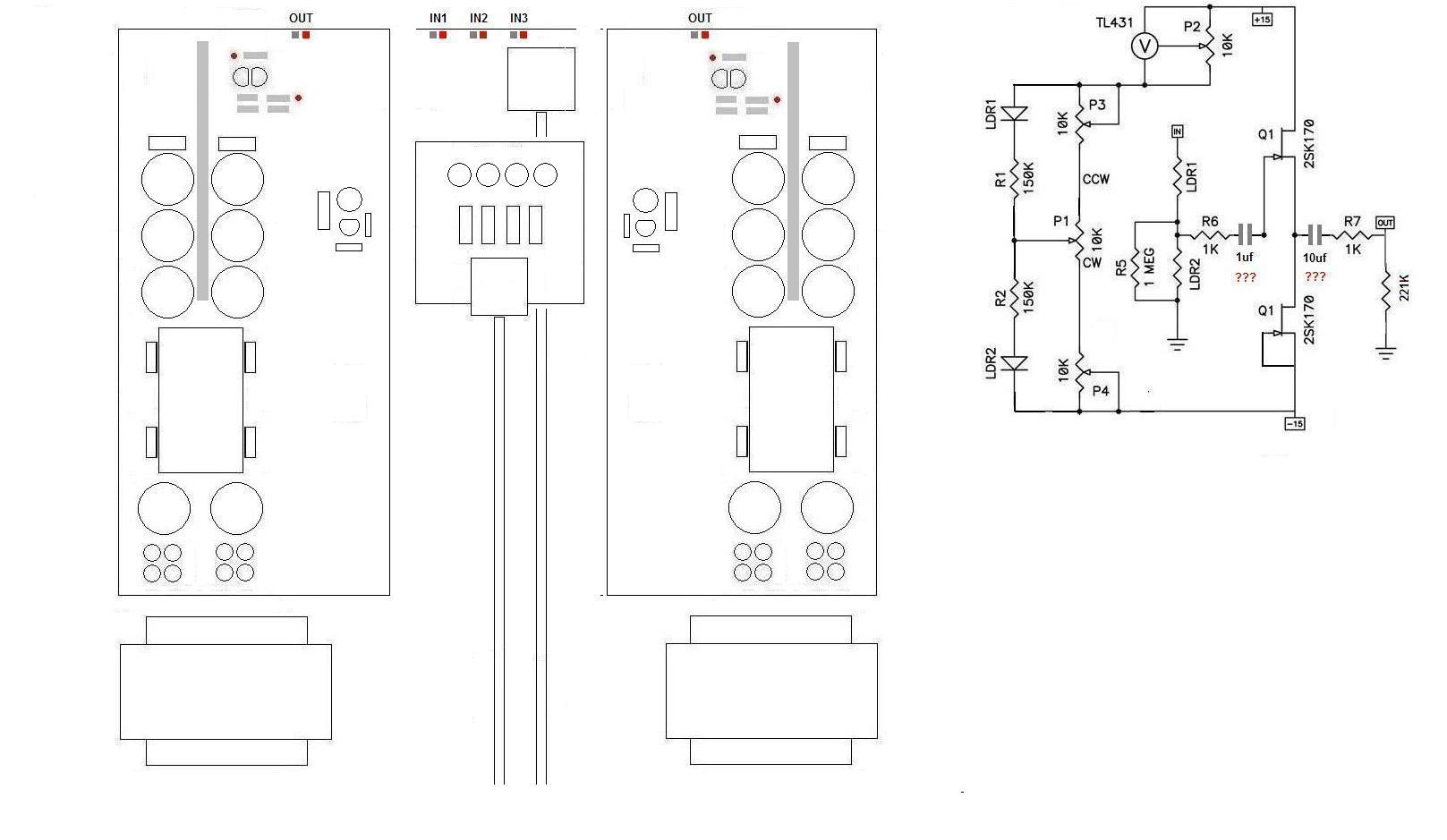

ok
most of the wire connections goes between chassis RCA and switch signal IN
so I guess its most convenient to mount the switch directly on to the backpanel
ought to be doable

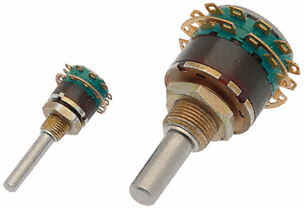

funny to find industruial standard switches looking much like the highend stuff
one of below cost 3USD, and the other 60USD
both with solver contacts and 4-pole options available

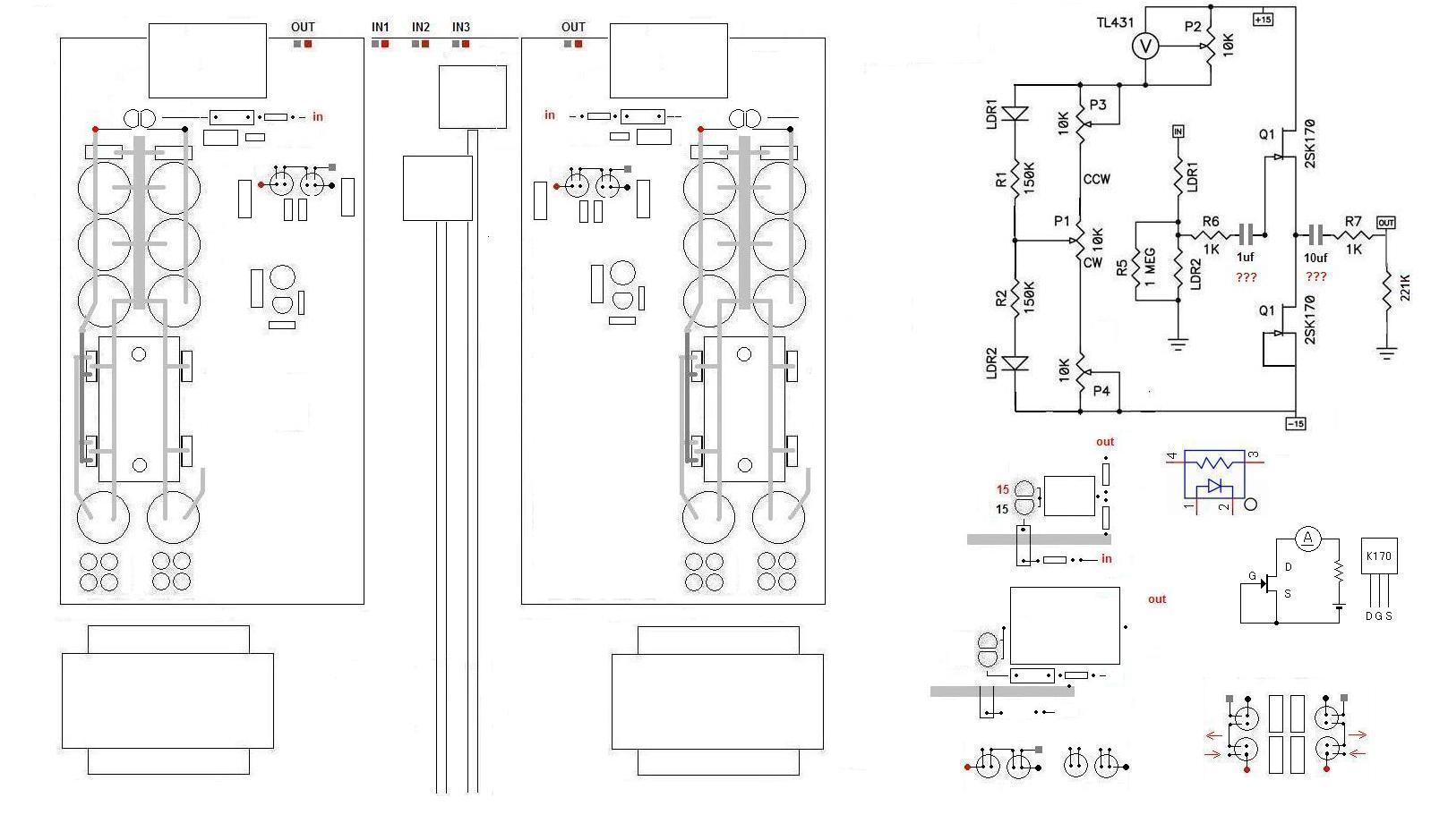

hmm, I guess those are only suggested in/out values relation, be it polar or poly
and yet another 'layout' :clown:
obviously its going to be completely seperated dual mono
it will definately be easier to wire it this way
and I found some alu to cool the regs

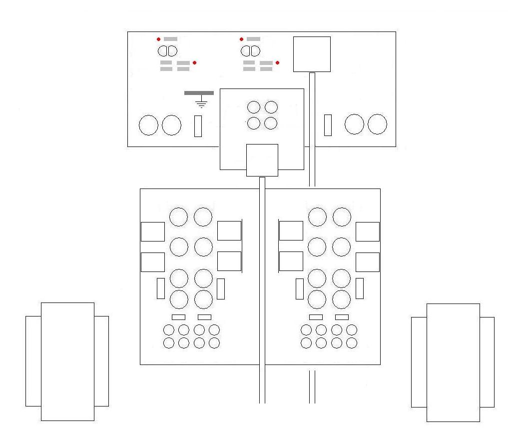

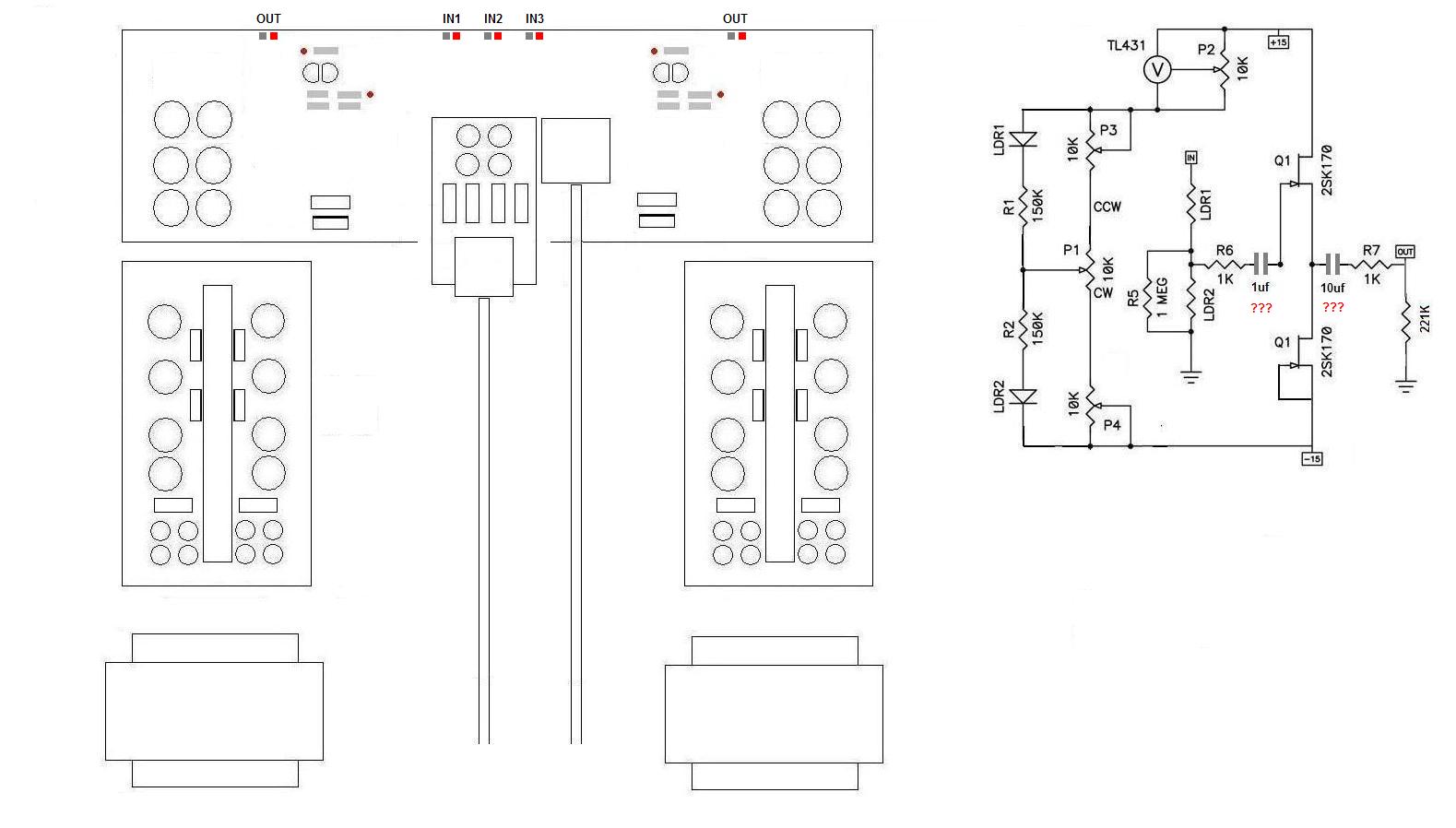

I think from memory that Nelson designed this particular vol control with the buffer for the "3" versions of the LDRs, not the usual "2" ones (rather different impedance range) and intended it to operate over an attenuation range of about 40dB.
If the following load is a "reasonable" impedance (>10kR), shouldn't need the large size 10uF cap on o/p before R7.
you mean like NSL-32SR3, instead of NSL-32SR2 ?
wouldn't it be higher impedance ?
maybe its due to the buffer ?
