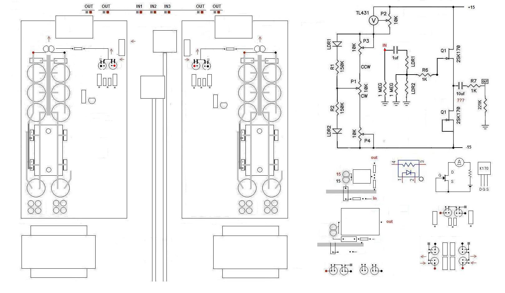

my power amps are mono amps
and I will use a 4-pole input selector
have had several of these C-core trafos for years
and I would like to use them
power supply does get bigger
and it ain't cheaper either
but I like the simpler connections to buffer/LDR curcuit
and maybe consider that its 'almost' like a 4-box preamp

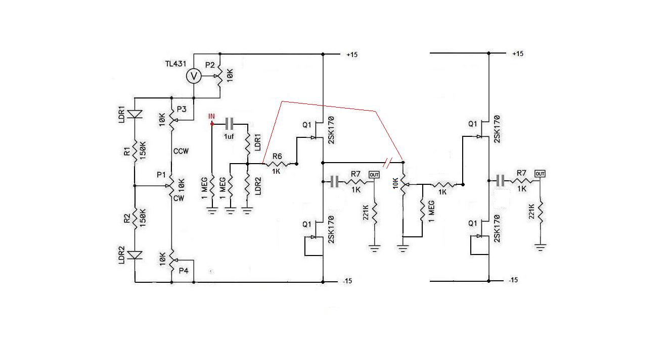

ok
tho trying not to complicate it, I'm now thinking if there could be another pair of jfets
driving optional output
through a simple attenuator, back panel mounted
he, might be best to make it work first

Why not duplicate the circuit you have and wire it in parallel.
yeah, I thought about it
but that exsta output may be only slightly attenuated
not a favourite of LDR's
I don't know yet how it will be used
woofers, subs, or maybe a tweeter
would it be better to take signal from LDR, instead of after first buffer ?
or maybe that's what you are saying ?

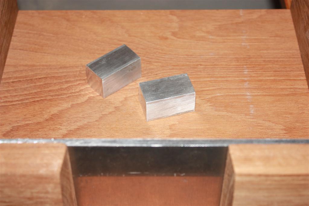

btw, managed to cut and file down the alu blocks I need for cooling the regs
and some important allignment and smoothing work on the box too
and I have found prototype boards with 3hole pads, nice
