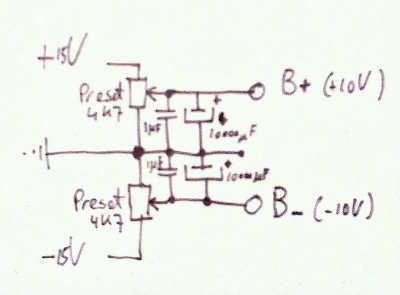

I've been thinking about the B1 (actually build one as well) and it's power supply.
As I see it, the concept is: take a descent DC-supply. Then follow that by a RC-filter (R1, C1, C2, C3 in the original schematic) to have a really nice supply.
Of course the PS impedance gets larger (R1 is doing that) but that is apparently not a problem because (now follows my thinking :scratch:)
1. the B1 draws only a little and fairly constant current?
2. there is enough capacity after R1 to provide the current needed (see 1.)?
If this reasoning holds, then increasing R1 gives us a lower corner frequency (less HF-noise), without penalties (the increased PS impedance is not a problem, see 1 and 2).
Please enlighten me, does this reasoning hold, or am I missing something important?

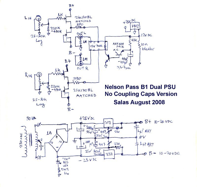

The reason I ask (of course I'd like to understand) is that if this holds, it's very easy to make a symmetrical B1 which is much more in line with the original asymetric circuit by Pass than the interesting circuits proposed by Salas (as mentioned in e.g.: http://www.diyaudio.com/forums/pass-labs/145201-building-symmetrical-psu-b1-buffer.html).
It goes like this:
Start with the (first?) symmetrical schematic by Salas http://www.diyaudio.com/forums/attachments/pass-labs/134693d1243979226-building-symmetrical-psu-b1-buffer-b1psu2xsmall.jpg. Leave out the LM317/LM337 stuff.
Take a decent symmetrical DC-supply. Follow that by an RC-filter, where the R is a preset, and feed the circuit by Salas with it. The DC-offset can then by nulled by virtue of the presets.
See pic:
Please comment on this setup. Is its smart? Is it stupid? Are regulators (LM3x7) better?
Thank you, MArco

you don't need the offset trimming.
Build the +-9Vdc to +-10Vdc dual polarity supply using your standard transformer rectifier and rCRC smoothing.
The jFET follower determines the output offset.
When Vgs is zero at the input then output offset is also zero.
If the current through the follower is slightly low then the Vgs is a tiny -ve voltage. That becomes the output offset.
A big error in setting the follower current results in a bigger output offset.
As the error approaches zero uA the output offset approaches 0.0mV
This setting of the follower current is done with the CCS jFET. That is why it is important to select 2 devices with similar or identical Idss.
It will also be better if these two devices are thermally coupled. So that the Idss in one tracks the Idss in the other with changes in operational temperature.

If I have dual supply rails which are not exactly equal but of opposite values it doesn't really matter because offset is determined by idss and not by the supply rails. Is that really true?
Yes, a DCB1 with +10V-5V would work and output offset would be almost zero.
The reason for it not being exactly zero is that the CCS jFET is not a perfect CCS. As the -10V drops to -5V the CCS current drops from Idss to ~97% of Idss.
The input offset (Vgs) of the follower jFET is now not zero but very slightly -ve due to the top jFET passing ~97% of it's Idss. That input offset becomes the output offset.
You could correct this by choosing a slightly higher Idss for the CCS to bring the output offset back to zero.
But this would leave you with two slightly different Idss jFETs each with different Vds producing different Tj. The offset would vary with ambient temperature.
For improved temperature stability, keep the Idss the same and the supply rails the same.
