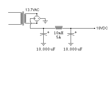

CLC unregulated Power Supply
In the article Mr. Pass recommends a regulated PS. I haven't had any complaints about the really cheap wall wart I've been using since I built mine a couple years ago.
I recently tried this one with some spare parts and some test leads, it sounds very nice. I got the idea from the ZCA here: DIY Class-A 2SK1058 MOSFET Amplifier Project
I hope you did not buy a 5A inductor.
The stereo B1 consumes ~20mA
No, they were all my parts box. What I've found so far says that the inductor should be rated for 20% more current than it is expected to draw. Does that sound reasonable?
It would be a lot cheaper than a 5 Amp one. 😀
