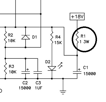

Hai guys,
just ordered my B1 PCB @ passdiy, should be here in hopefully 3 weeks, so plenty of time to ask dumb questions.
i got one at the ready just now :D
as a novice in this area i have a little trouble understanding the following found in the B1-manual:
"With the exception of R1, all the resistors are ¼ watt"
okay..so R1 is a 3watt resistor..but what is the value of R1 in Ohms? Is it 1K but is the "k" missing? Or is it 0.1 Ohms
I enclosed a picture of the schematics to see what makes me confused.
my apologies for my novice-level on this subject, i hope you guys can help me out.
Greetings from The Netherlands.
Maarten

It's 1 Ohm. That's what the small 1 left of the 3W stands for. ;)

Thanks Nightrush,
i assumed it should have said 1K in Ohms with the K missing but you explanation is clear, thanks a bunch!
