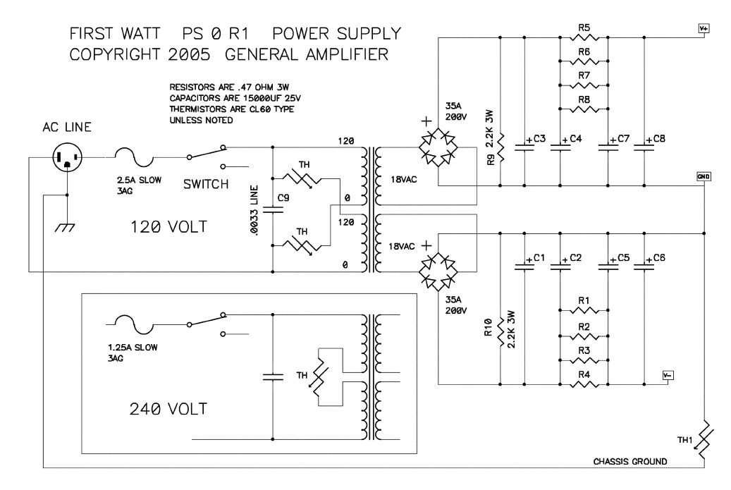

Hello,
For R1 is ok a Vishay-sfernice 1 Ohm 6W wirewound resistor? (I have a lot of them).
Cheers
Cheers
It will work fine. And you will be sure that it doesn't ever get close to it's dissipation!! 🙂
Thanks 😉
