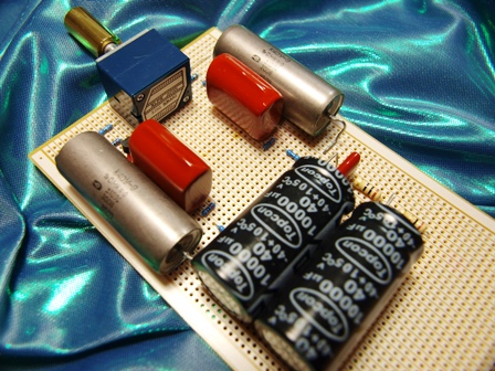

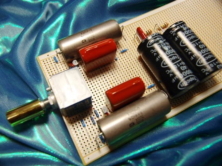

BoZ cct. brd.completed.
See imges below. Once again I used the Russian 0.1uf PIO, and 10uf poly (input cap and output cap respectively) (snubbed with 0.1uf ploy). All on vero-brd. spare central tracks shorted to ground to act as a gatherer. Alps blue velvet 25k pot and slim solid brass knob.
PS: 1R0 to 10,000uf cap, 10R0 to second 10,000uf cap. 5% WBT silver solder used. This will go into a Hammond anodised Al case.
