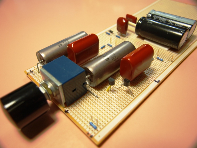

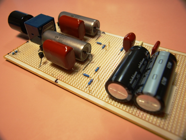

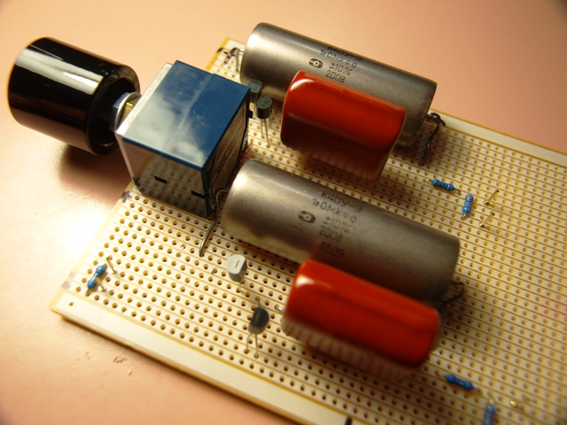

Guys:
Just the amp section done. You can see the Russian 1uf PIO caps and the 10uf brown polies. The PS will be built on the same brd. The Alps blue velvet pot is also a part of the same brd. 4oz black chrome knob adorns the sctructure.
You make it look like such a difficult build! LOL
Okay if you are still thinking whether or not to build I think this pic should assuage your concerns of difficulty. You guys can do this.

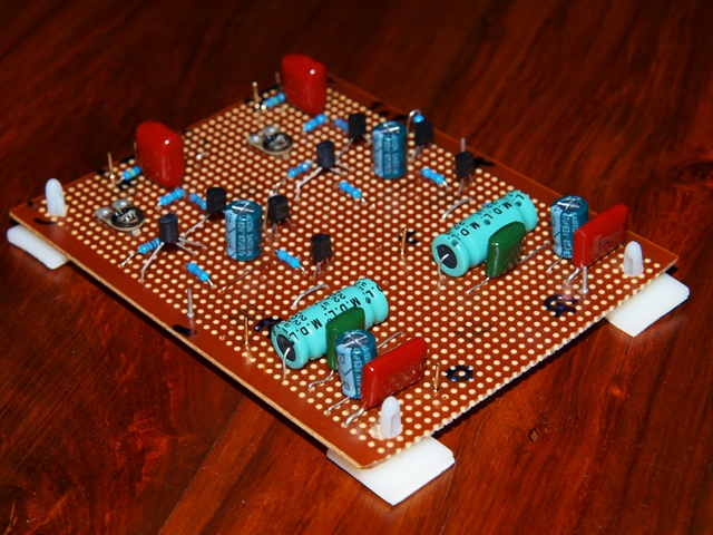

The B1 on vero-brd. was far simpler than this ESP P37A discrete component class A preamp from Rod Elliot again on vero-brd. More active components in this one. If you like the B1 the P37A should also please.
I built this for an Malaysian friend who I have built a lot of amps etc. for. There is no PS here. I ran it on four 9V batteries to run it in. Very natural uncoloured sound.
http://sound.westhost.com/project37a.htm
A little more progress. The PS is now on the brd. The only other part I added was a 0.1uf poly across the B+. Where Pass suggests 2 X 15,000uf filter caps I used 2 X 10,000uf 'cause that's all I had.
For those who hadn't noticed I had the CCS FETs backwards. I lost two hours pulling one JFET for another.

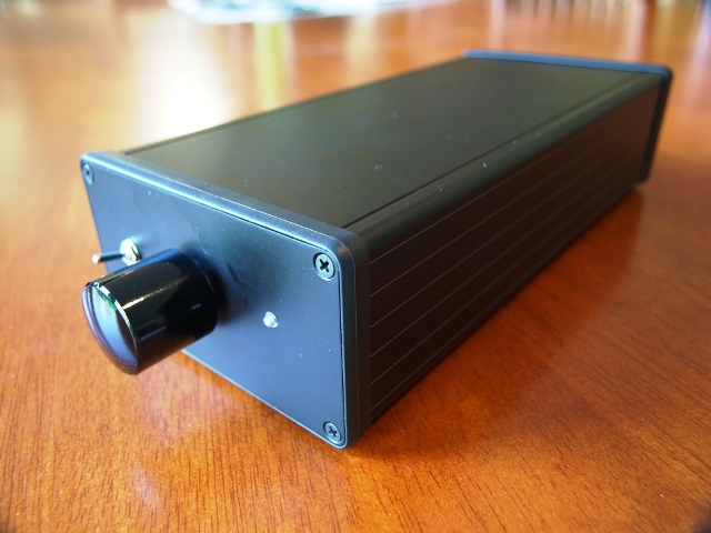

Now the cct. brd. is finished I had a quick listen. Seem to have good low-end weight. More to come.
I have had a brief listen on my main system with my 6AS7 SET power amp. Bass is light with mids/treble absolutely fab. Sound stage and imaging stunning. I will trial the B1 on a high-end DIY discrete 200W transistors amp soon. Gain is a bit low for my SET.
Playing a gold pressing, re-mastered Frank Sinatra CD which is the best I have heard this CD. More to come.

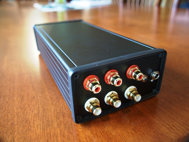

Case is Hammond. Gold RCAs with selectable inputs. 4oz solid brass black chrome knob on Alps blue velvet. Inside all the hook-up wire is cotton coated, tinned solid copper wire. Hard to work with.
PS in a Toshiba 19V 3.5A SMPS.
