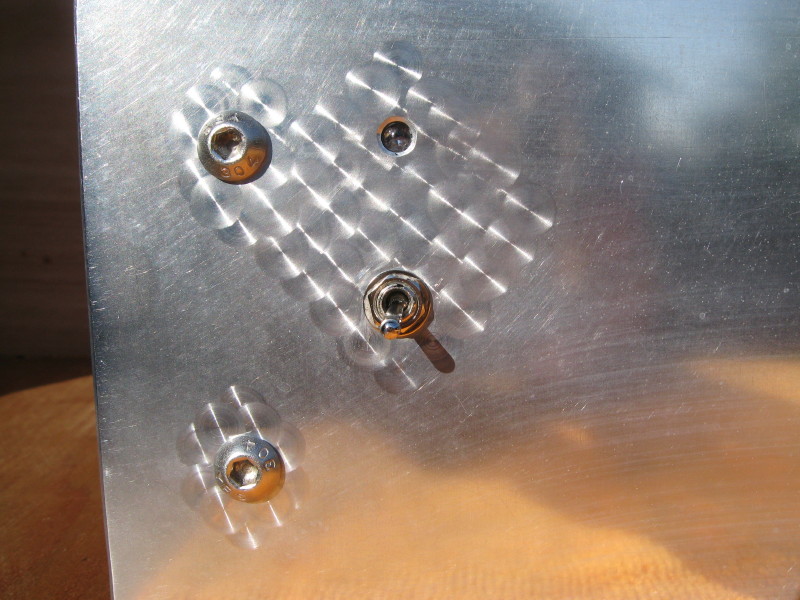

I had a visitor awhile back, an industrial designer that developed some of the Bel Canto lineup and he chided me on my use of a black toggle on a silver faceplate. I guess I may be getting over-sensitive about mixing black and silver.
I actually find little to complain about your chassis and the mix of color, the knob looks good in a contrasting color. I spent a good amount of searching to come up with a local supplier of fasteners that has a broad line card of product, including stainless and black oxide in different styles. My oversensitivity even drove me to experiment with engine turning on my last build.
Thanks for the link Chris. Can you give a hint on price please.
$65 natural, $75 anodized plus shipping.
