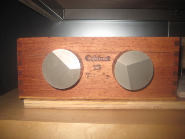

I put my open chassis B1 into a box yesterday...
Still sounds great and looks much better. All in all a good use of a $4 Tatuaje box.
My wife even said something complimentary about the appearance.

Very good use of the box 😎 Where did you get those knobs, I've never seen a profile like that but really like them?I put my open chassis B1 into a box yesterday...
Papa. From Burning Amp #1.
They are Threshold knobs: (maybe from this?)
Vintage Rare Threshold Model SL10 PreAmplifier for sale - New and Used - PC Game Cheats Codes | PC Cheats Codes
I have a stereo volume pot on the left and the DPDT is actually the knob on the right. Left of center is input one, Center is Off, and Right is input 2.
I only had about .25" around the board on all sides so it's kinda like 10 lbs of stuff in a 5 pound bag in there with the Nichicon KG PS caps folded over the top of everything.

Here is a picture of the final outcome. I like the small foot print of it now but once that last hermit crab on the other shelf goes to see Davey Jones than I will make a better housing.
