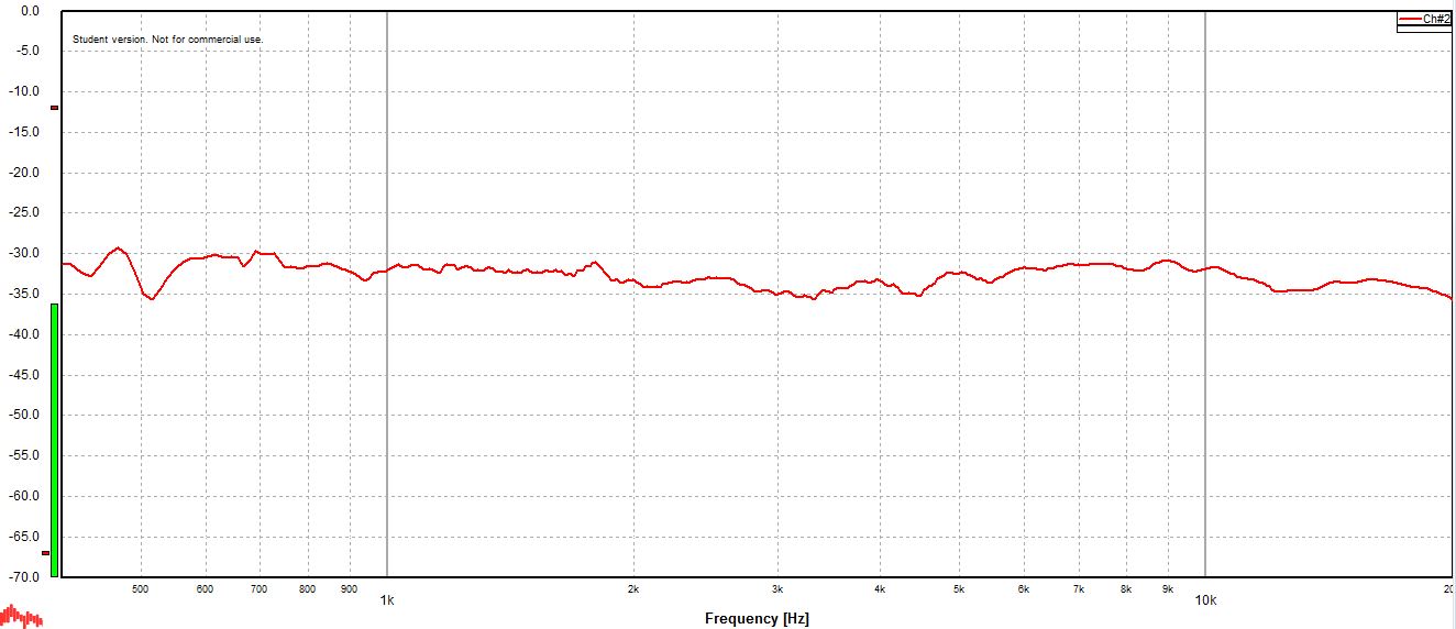

The MLS measurement was taken in the near field - at a distance of about 0.6m , although I did take measurements at various distances, but in the near field the room effects are only obvious below 400Hz, which is where I set the low frequency limit of the analyser display.

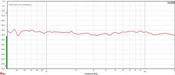

Latest on axis measurement
And, also 45 degrees off axis
Interesting pair of measurements. Allows for easy adjustment to personal taste by adjusting the toe-in. I'd take the 30 degrees please. 🙂

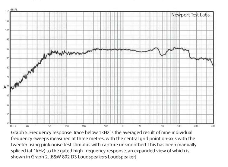

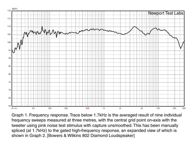

The latest Australian HiFi has now included a tech review of the 802D3.
See attached, including the unsmoothed response measured at 3m (tweeter height) of the previous D2 version Vs the latest D3.
I know B&W like their high crossover point for the 800 series but it's the designs biggest flaw. It creates such a huge sensitivity to listening height and distance that it's no surprise that opinions are divided. They should simply adopt a different strategy (lower the xover point) and give the speakers are wider and smoother, vertical, listening window.
I don't like to criticise in a design that has had so much thought, R&D and engineering expertise put into it. But simplistic xovers and crossovers so high, with such a large diameter midrange driver, are simply plagued by the laws of physics. A loudspeaker of this cost and pedegree should be listenable over a wide degree of sitting heights.
Edit - I am almost tempted to say that B&W should shrink the FST down to a 4" unit and make a 4 or 3.5 way design. As an example keep the 1" diamond, cross it in a 4kHz to the 4" FST. Have a 6" mid/bass below the FST and cross it over at ~700Hz. Then either cross in the 4th driver, say an 8" bass unit, as an entirely 4 way design, or have it act as a .5 way to the 6" mid/bass above it.
Alternatively B&W could do the 4 way in a different way entirely.
Use a 4" FST midrange and 1" Diamond tweeter, have these crossed over at 4kHz. Then have an 8" FST driver below it. Have these crossed over at ~700Hz, with the 8" FST covering down to around 200Hz. Then have some 8" bass drivers below this.
Both ways are more complex than what B&W have at the moment, but this would solve the 4kHz issue that plagues the current design ethos.
The easy way to solve this problem is to lower the xover frequency. This is simple and effective.
