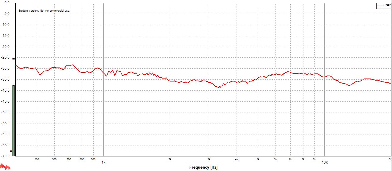

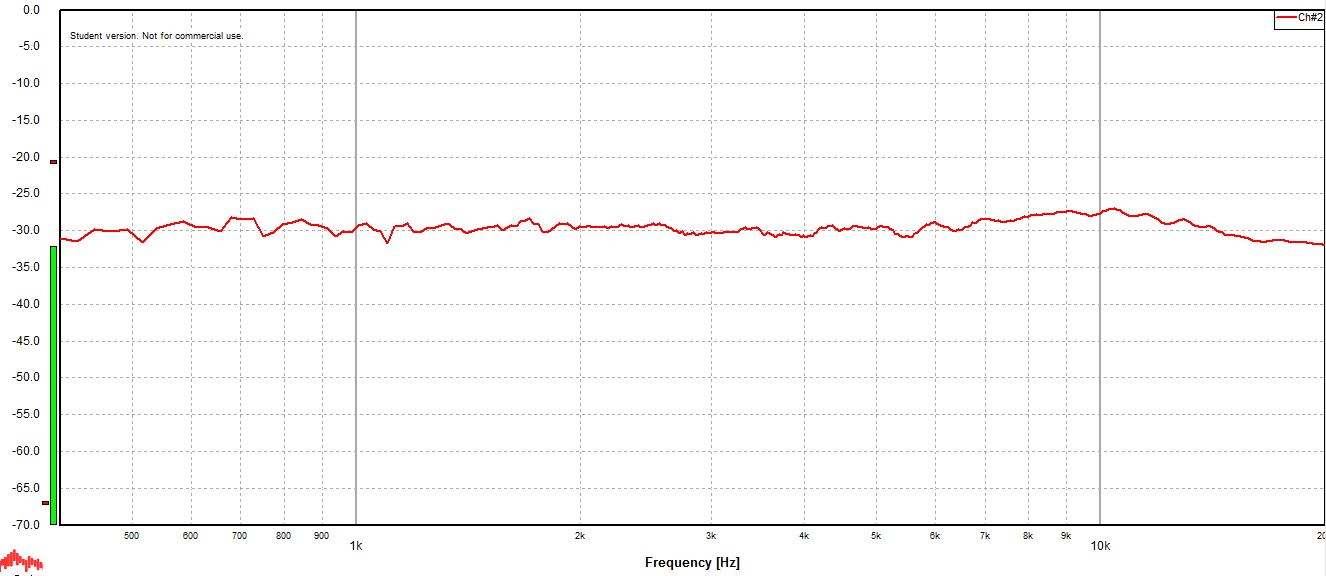

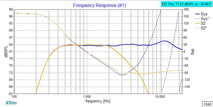

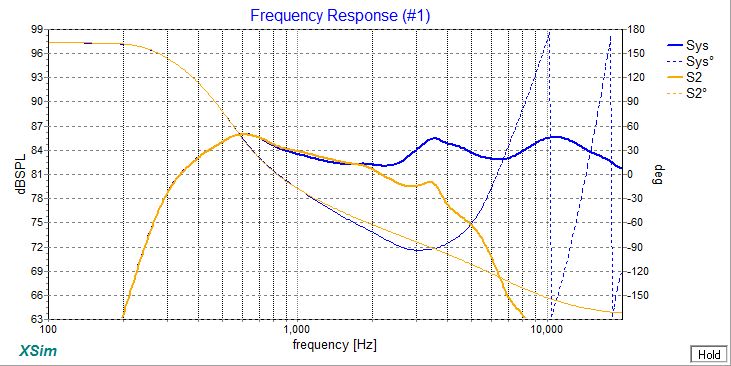

Changing out the FST isn't mandatory, and in fact it's possible that the old kevlar FST is better in certain respects because it's stiffer.
I did eventually notch the peak at 3.6kHz with a network in shunt (R+ L + C) with values that precisely matched the Q and amplitude, and after doing that I found that the phase alignment became perfect at the crossover point; when I waved a test mic through the vertical axis, instead of seeing strange discontinuities I saw a smooth (textbook) transition. This wasn't an easy exercise because it was 99% trial and error using live mls measurements, but was ultimately very worthwhile.
I've attached simulations of the response of the FST + tweeter before and after my FST crossover mods, and as you'll see, the response is much flatter.
Personally, I don't think there's too much difference between the sound of the new D3 series and my modified 800D2 in the mids, and if anything I slightly prefer my 800D2.
