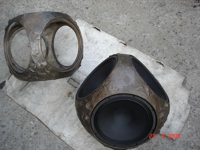

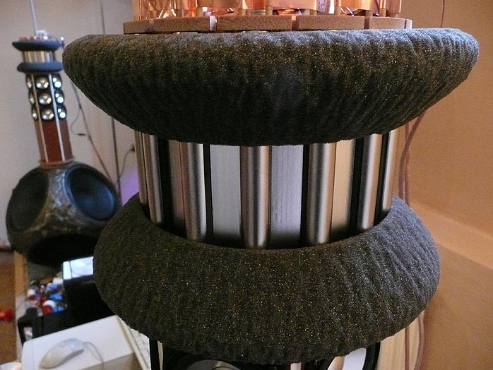

Kind of reminds me of RAAL's Requisite Eternity omni.
RAAL Requisite Eternity Omni-Directional Speaker System | Tuvie
That's a solid bronze casting that holds the woofers on the bottom.
The best part is the polar array of RAAL ribbons on top.
