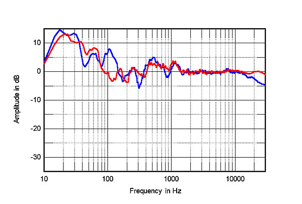

radulescu,
Is this room response just an accident or is low end too heavy always? Remember, this is with room correction!
I have some measurements made at different points in the room but none outside and these can or cannot be trusted as anyone pleases .
The one attached is made at the listening point , in a relatively small room and it can be seen that the bass is a bit overwhelming. The fact is it is not!!!! The measurements are affected by the fact that the solid walls with little furniture are absorbing too little and the reverb time is too high for an accurate impulse response. The measurements are in fact valid only over 45 hz for real and under that it is only a suggestion of what they are capable. Our psychoacoustic sense us modifying this response as it is used to that room and it turns it into a very realistic reproduction.
The only thing I felt missing is the kick at 70-130 hz that on some songs should make me feel it in my teeth.
For what is worth, I could get about 126 dB Leq 125 ms at the listening spot and about 133 dB Lcpeak with a Bruel and Kjaer hand held meter.
Of cause this does not look like an "acceptable" room curve at all.
So there seem's to be some homework left to be done for the designers of this particular speaker too ...
(sorry again for 'mythbusting')
Marketing claims and "real room acoustics" (loudspeaker/room interaction) mostly compare like "a kick in the teeth", and exactly this is what can be learned/experienced here too ...
