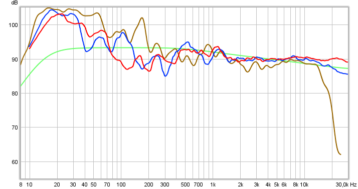

One thing I was wondering - the curve published in Stereophile was with Room EQ. Makes me even more puzzled... Here is their room curve of Martin Logan Masterpiece Reneissance, but in a different room. This looks like ok sound signature to me! (Red without room EQ) MartinLogan Masterpiece Renaissance ESL 15A loudspeaker Measurements | Stereophile.com
Overlaid:
Blue/red is tracing of the 1/6 smoothed curves from SP plot.
Brown is tracing of radulescu curve added 1/6 smoothing.
Green is a approximate B&K curve high passed at 15Hz.

Now that´s a movie´ish graph
easily done on my own system and i don´t like so heavy bottom end.
but kind of ok if you listen 126db all the time
🙂) I don't listen to 126 dB all the time...But most of the time 🙂..
OK, now I don't think anyone would believe those speakers are capable to play at 126 dB for ever, that is an absolute peak , they are cruising at 110 if one likes it, but most of the time I listen to about 90-105 dB Leq average
That bass is emphased to much by the reverb time
As I said yesterday, there is a bump in the response from the elongated impulse response on low frequencies.
The measurements were made at the listening point, near the back wall.
