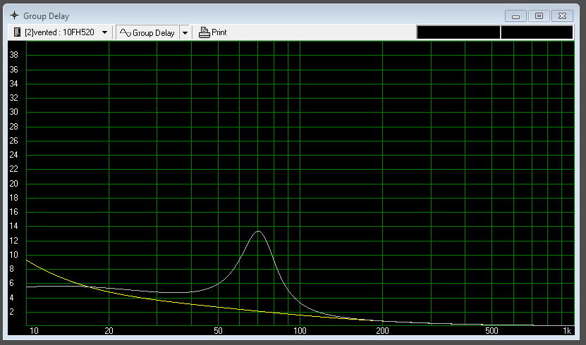

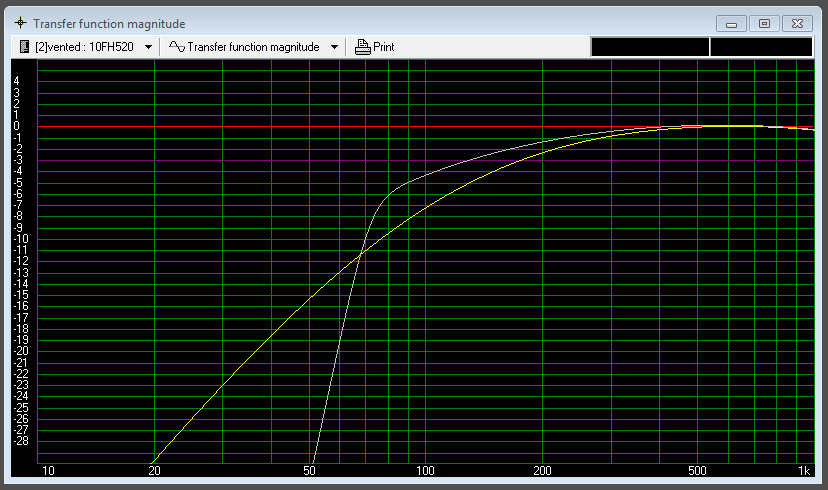

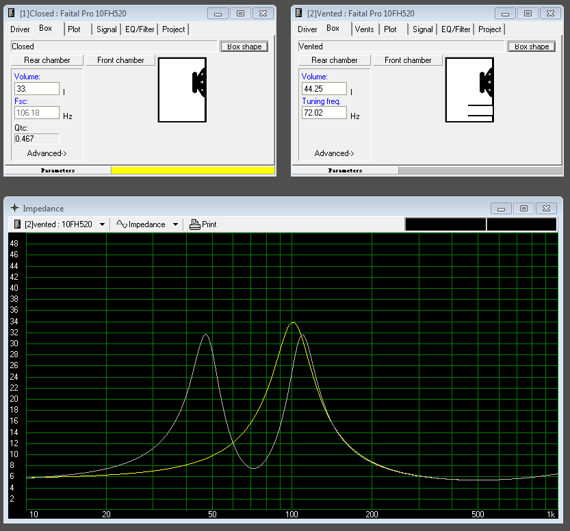

Ok so I have been playing around in WinISD on the Faital 10FH520 between seal vs. vented. I think a sealed version would be better to mate with the existing subwoofers. The response is flatter down to the Xover point (around 90Hz) for the vented alignment but with the rise in impedance on the sealed alignment shouldn't I be able to compensate with EQ without taxing the amplifier at the cost of some extra excursion of the Faital? At 6mm Xmax I don't think I will have any issues. I this logical thinking? Should I be considering other parameters? BTW this will be an MTM setup. Looks like the Beyma CP380 on an XT1086 horn. Xover will be all active using a good old DCX-2496 (existing).
Another reason I want to try the Faital is the offering is fairly new and there don't seem to be any projects based on it. Mms is low, Le is very low and overall it looks like a good candidate for this project. Are there any glaring reasons not to use this woofer? I know the AE is an outstanding woofer I just want to try something different.
No experience with or comments on the driver choices, but the box tuning looks a little unusual. The sealed version is very low Q resulting in, perhaps, rolloff earlier than you want...try a smaller box for a Q of .6 or .7 and see how you like the response. The ported version is peaking on the bottom end (may sound boomy)...try tuning so the bottom end of the shelf does not rise once it has begun to roll off.
I tried a higher Qtc for sealed and there was only a subtle difference in the roll off but with the lower Qtc I gain a couple dB near the Xover. The volume of the enclosure is near Vas.

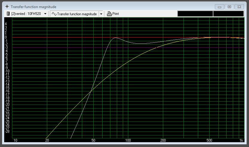

Here is a plot with a 4th order High Pass 80Hz LR applied to the ported box. As a system it's not bad.
In the EQ/Filter section try a Linkwitz transform on the sealed box with the goal being Q=.71 at 80 Hz. Then add an 80 Hz 2nd order Butterworth highpass and you'll end up with LR4-80 acoustic response. The acoustic response of your ported box + 4th order filter is more like 8th order.
If i was building an MTM with Faital tens and a compression driver, here's what I'd do:
#1 - Due to the low QTS, you won't get much bass out of the Faital woofers. I'd consider using a resistor to raise QES. That will lower the F3 of your sealed box.
#2 - Another option is to use a ported box, but as you noted, that will make it difficult to integrate with subwoofers. Geddes used to use a ported alignment with the Summas that I'm running, but he switched to a sealed design for similar reasons IIRC
