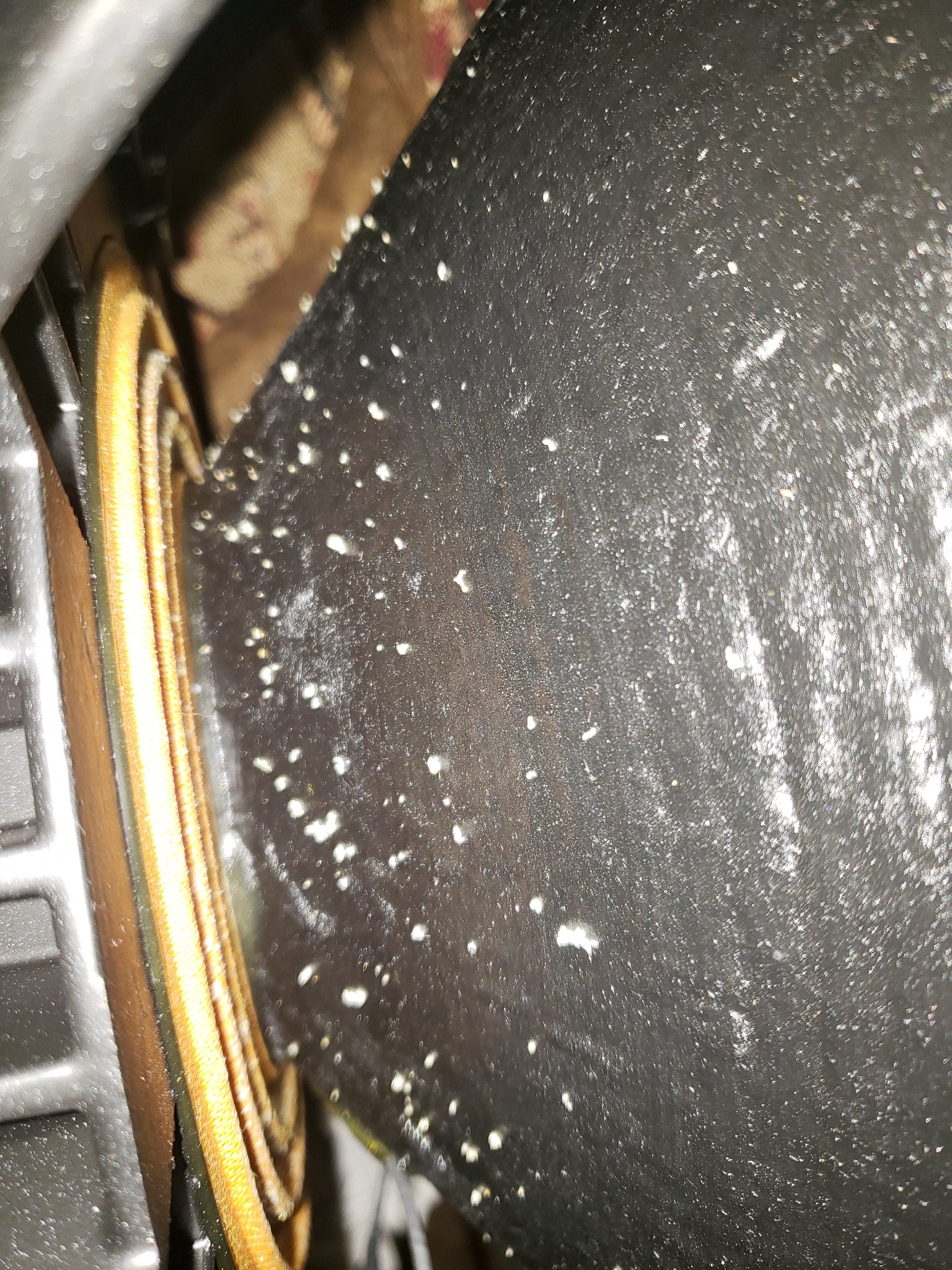

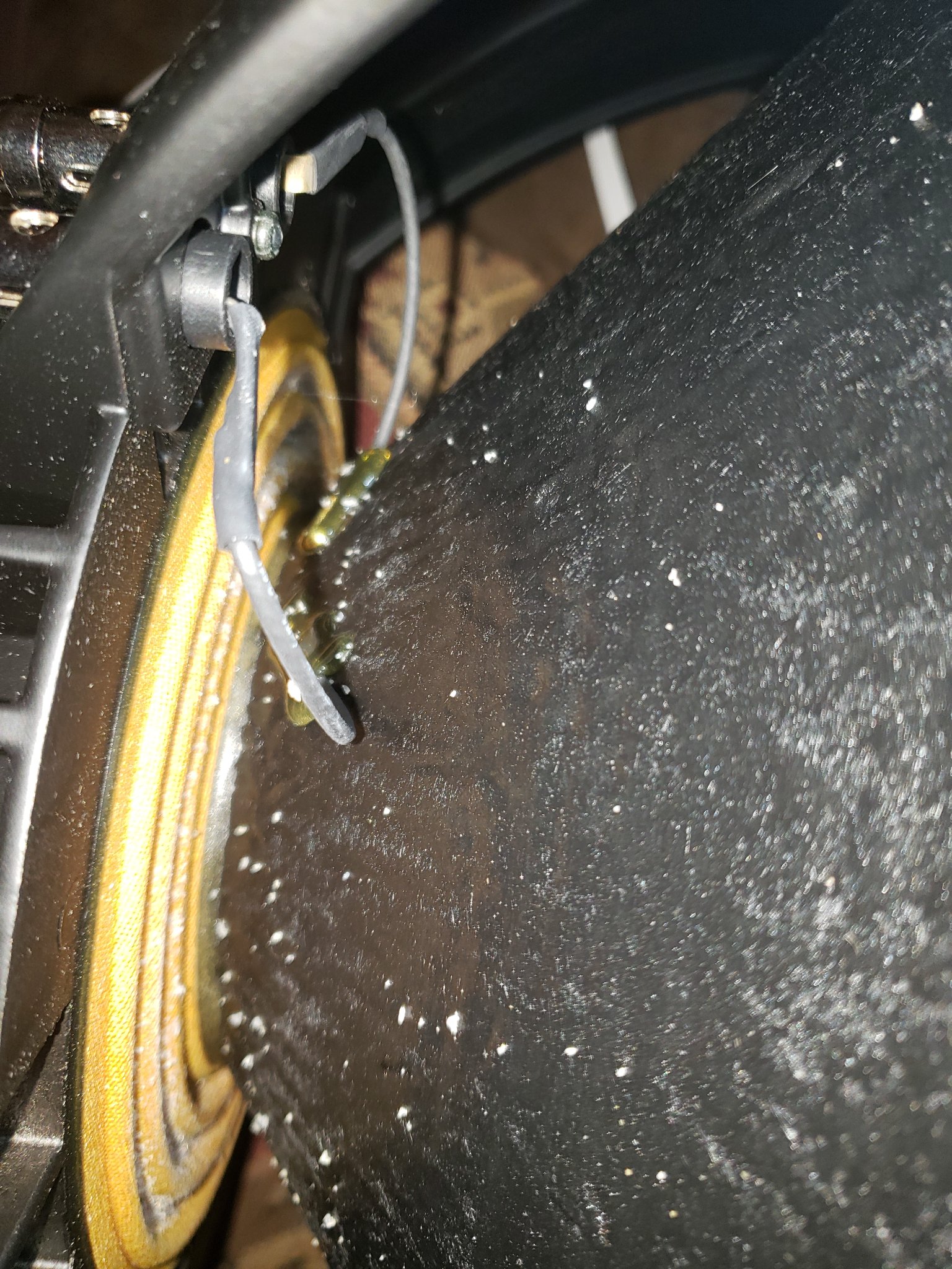

Anyways, I took some more pictures of the two 18NW100s before returning them. Here is the silicone crumb carnage...
The spiders on these subs are absolutely unsuitable for linearity to xmax. After seeing how much the spiders were shedding, I stopped pushing them further. This was only with 18V @ 15 hz. I've learned my lesson and will follow my original rule of not using woofers with narrow, low compliance suspensions.

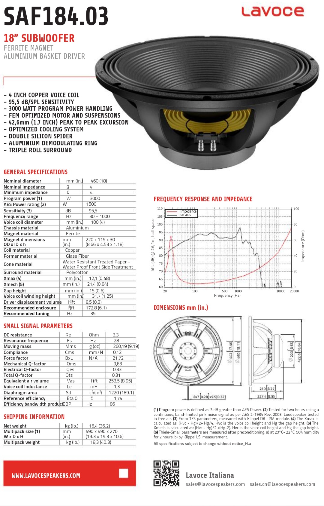

Here's the 4 ohm version of Lavoce SAF184.03
Looks like it has 1mm less xmax and 10 grams more Mms with a tiny bit of extra compliance. I'd say they compromised in the right places for the lower impedance version. The Fs is down by 2 hz as well with the same Qts.
These always have measured accurately for me after light break in. They settle at spec sitting in 20 deg C room temp. Run them harder and the Fs will drop to about 26 hz and come back to 28 hz sitting in room temp.

@jawen I did see that. Among other things I'm still not at all thrilled with the suspension. That spider is way too small for the mathematical excursion capability (especially not the klippel rated xmax at 20% BL loss).
Over time the narrow spider setup will become looser and develope unlinear centering bias. This is common on drivers like this and I wouldn't be comfortable pushing it anywhere close to its rated xmax under these circumstances.

I've been tinkering with the new 4 ohm Lavoce SAF184.03s and they look really promising for my needs. Fs is down to 28 hz after preconditioning. The build quality is on par with the other big brands and the price of $300 is excellent.
No, they're not neo drivers, but I'd rather deal with a few more pounds if the driver is what they say its supposed to be.
I realized that most 18" B&C woofers are built on a standard shallow basket, being lower power type midwoofers. The spider diameters on these are limited by VC OD and basket opening. This makes a 4" VC a rather tight fit ie. as on the 18NW100. A narrow spider will limit excursion and behaves much less linear than a larger one. It will also need to be progressive in compliance, which can be a protective mechanism keeping the VC from bottoming out.
Drivers built on the larger, deeper frame platforms, ie. 18SW100/115, have more room available to fit a larger OD spider, making them better suited for longer stroke subwoofers applications. I personally don't have much use for a short stroke 18" driver, so the only reason for purchasing these is cost savings.
The Lavoce SAF184.03 is assembled on the larger, deeper style basket, similar to 18TBW100s and most other B&C neo 18s. They have enough room for larger 4"+ VCs, allowing for more linear excursion.
