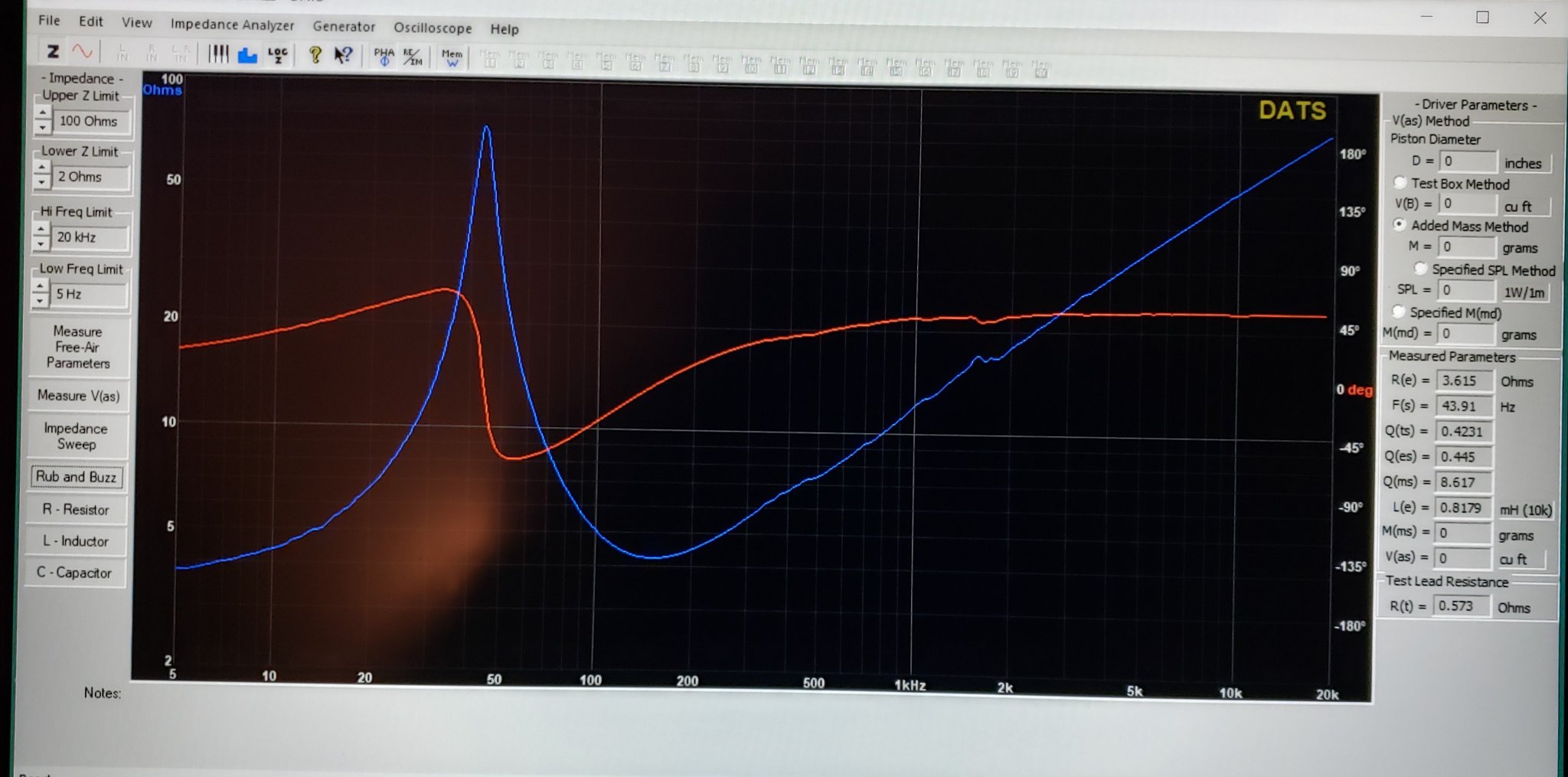

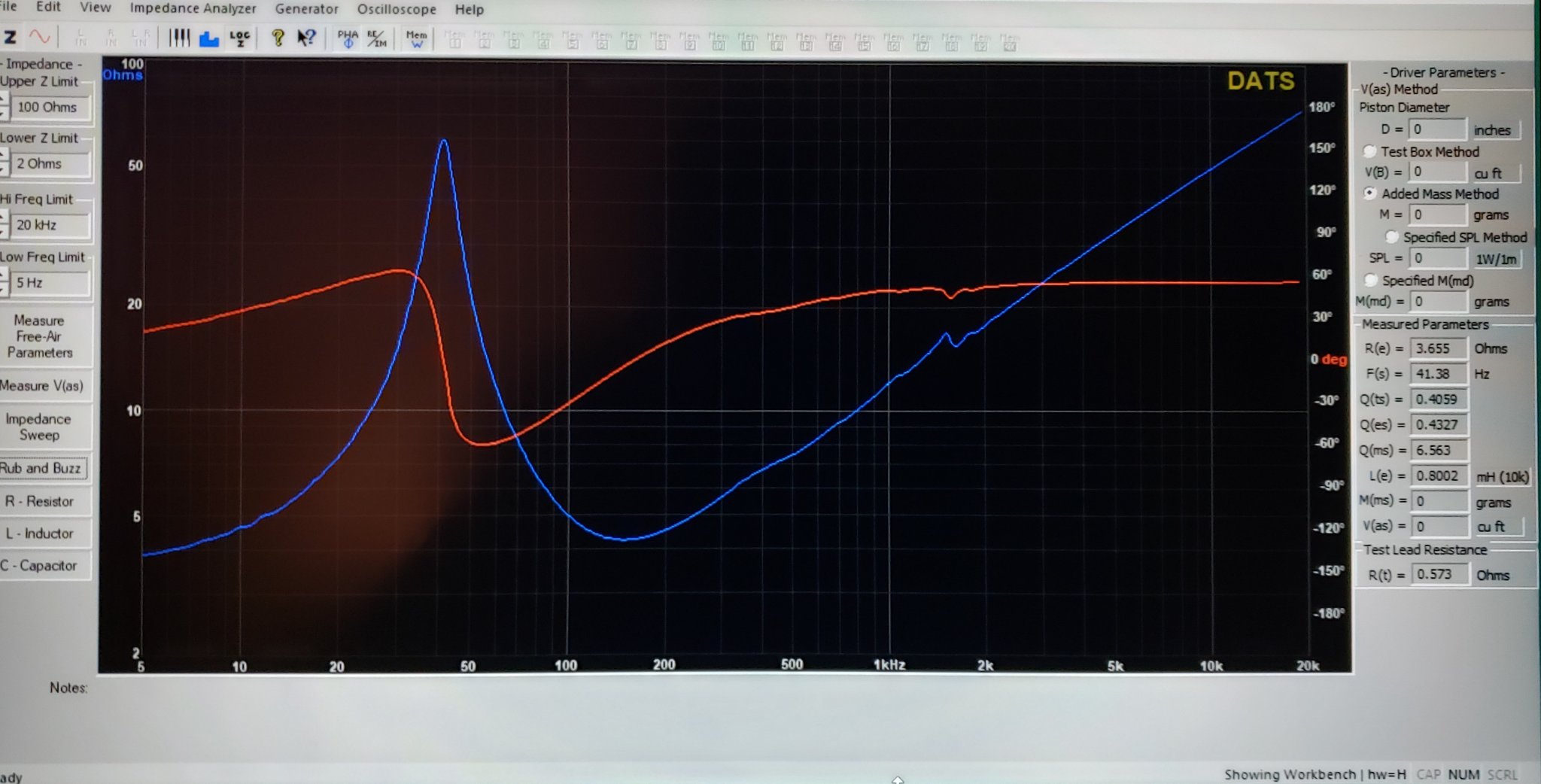

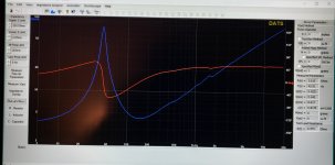

B&C 18NW100 TSPs way off

This Lavoce SAF184.03 I've been working with is honestly one of the best 18" pro subs I've seen from a cost standpoint. It does everything a typical 18" pro sub is supposed to, but for less money. The cone is very rigid on this thing, but not to the point of sounding too nasal or peaky. The suspension is just right in compliance - something hard to achieve on a woofer/sub of this type. The motor is very quiet and well ventilated. Not completely silent in free air but very close to it. In a ported cab under 200 hz you definitely won't hear anything but the input signal, even at close to xmax.
The best part about this 18" is the TSPs are very accurate at lower drive levels, not at 1000W with the VC boiling away - that's kind of dishonest, rather embellishing the truth. I just wish other companies would make drivers this good for reasonable amounts of money. At $300 shipped to your door (40 lbs... yikes!) I haven't seen anything better in an 18" sub.
And to the point made here before, having the driver do mechanical limiting isn't a good idea long term. It just wastes energy, beats up the suspension and increases distortion unnecessarily running close to the driver's SPL limits. Some people like that compressed sound when playing EDM or rap. I'd rather do that electronically with dynamics processing.
So far, after testing these Lavoce 18s, I've come to the general conclusion it can do hifi and PA equally well. It does this with less power than many other similar drivers I've used. At about 800W it just barely touches xmax In 160l ported tuned to 33 hz. Crossed up to 100 hz it still sounds tight and clean without the mushy lower mids that many other large drivers have crossed this high. 80 hz HP is probably the sweet spot in most situations.
