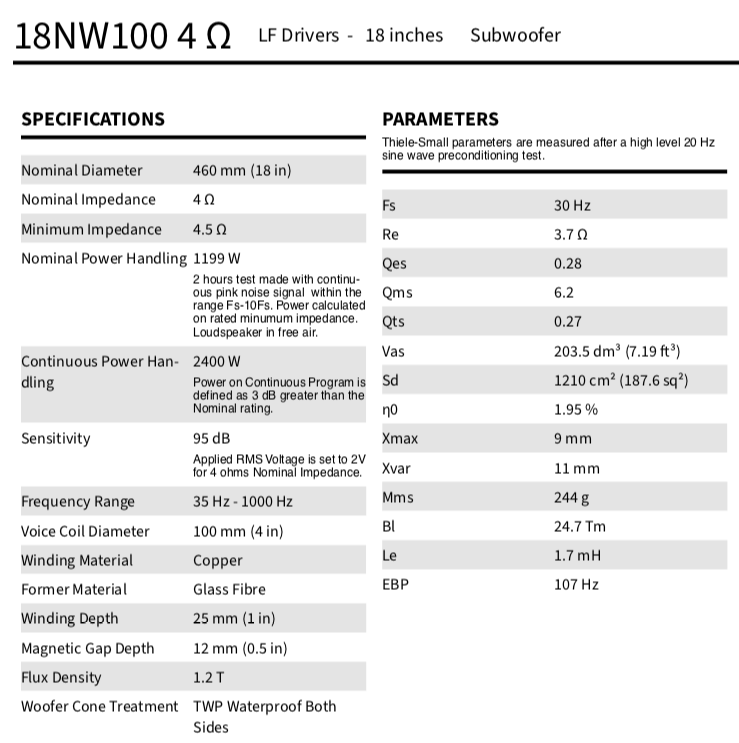

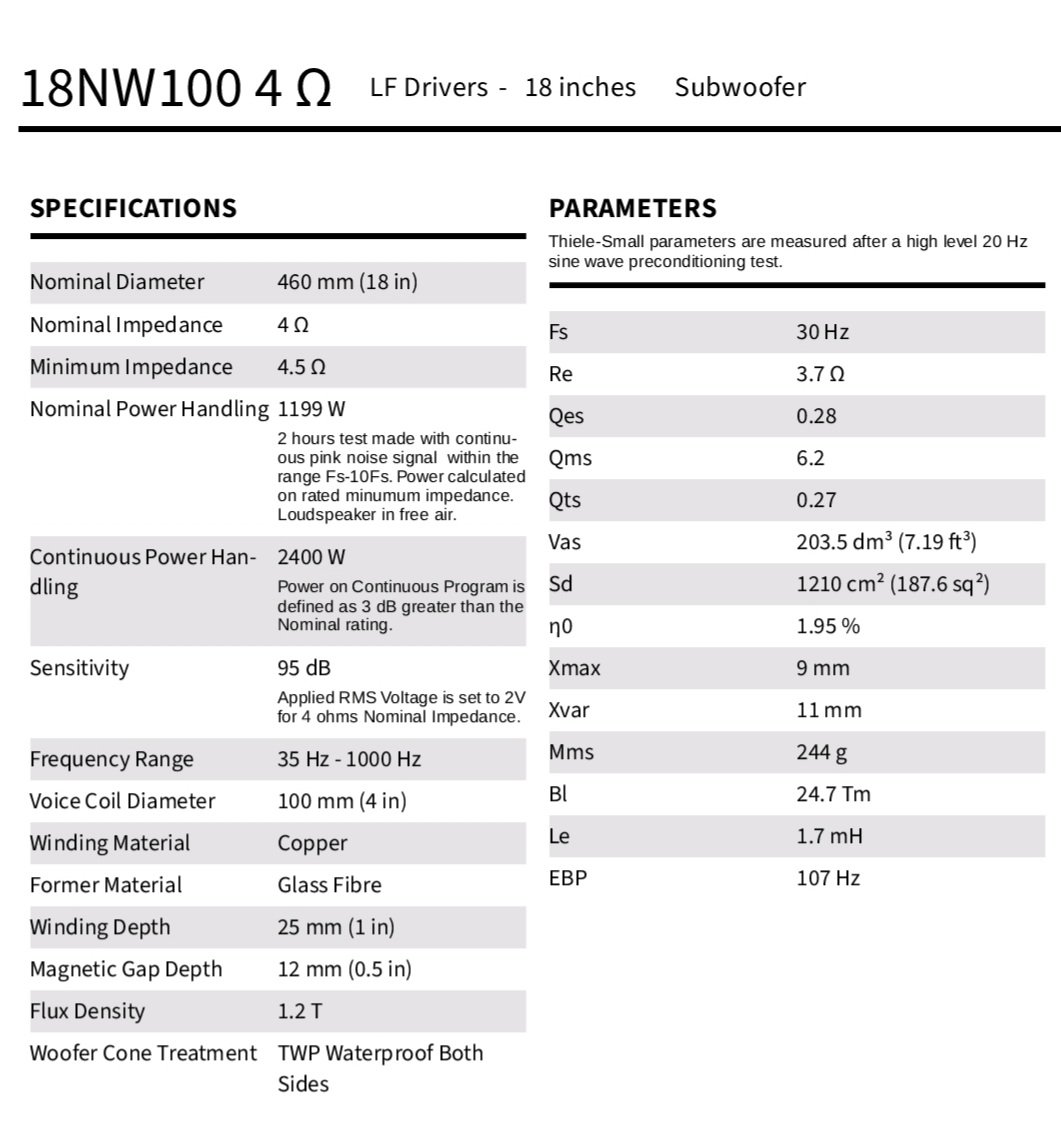

Hey Art, thanks for the reply. I understand what your saying. Do you find an actual factory specified Fs for the 4 ohm 18NW100?
The 4Ω is 30Hz vs. 31Hz, the Vas is 203.5dm3 vs. 252dm3 (stiffer) and Mms is 33 grams more than the 8Ω:
As it says under "Parameters"
"Thiele-Small parameters are measured after a high level 20 Hz sine wave preconditioning test."

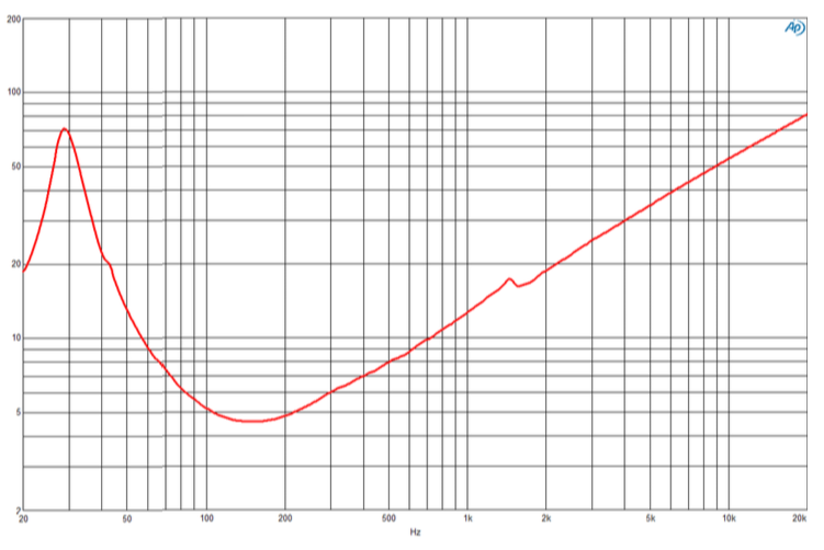

I would assume a "high level" would be ~ the "Nominal Power Handling" of 1199W (one watt less than the 8Ω 😉) , around 73.5 volts into the specified minimum impedance of 4.5Ω.
That said, at 20Hz the impedance is ~18Ω, only 300 watts.
As I recall, you have only applied 15volts, a small fraction of the driver's free air power rating.

The difference in Fs on my 18NW100s is more than 30% if you consider measuring 41Hz after a fair amount of run-in when it should be closer to 30 hz. I'd be ok if it stayed at leastn 35 Hz, but it won't make it to that point unless I really take a sledgehammer approach to running them in.
At 35Hz Fs, off by less than 15%.
I would bet the Fs would come in closer to 30Hz with proper preconditioning and (at minimum) a 4v test.
At that point they'll be abused and prematurely worn before being put into service.
Preconditioning a stiff driver designed to withstand 2400 watt peaks in free air for 2 hours according to the AES2-1984 "The rated power of the device shall be that power the device can withstand for 2 h without permanent change in acoustical, mechanical, or electrical characteristics greater than 10%."
is not abuse.

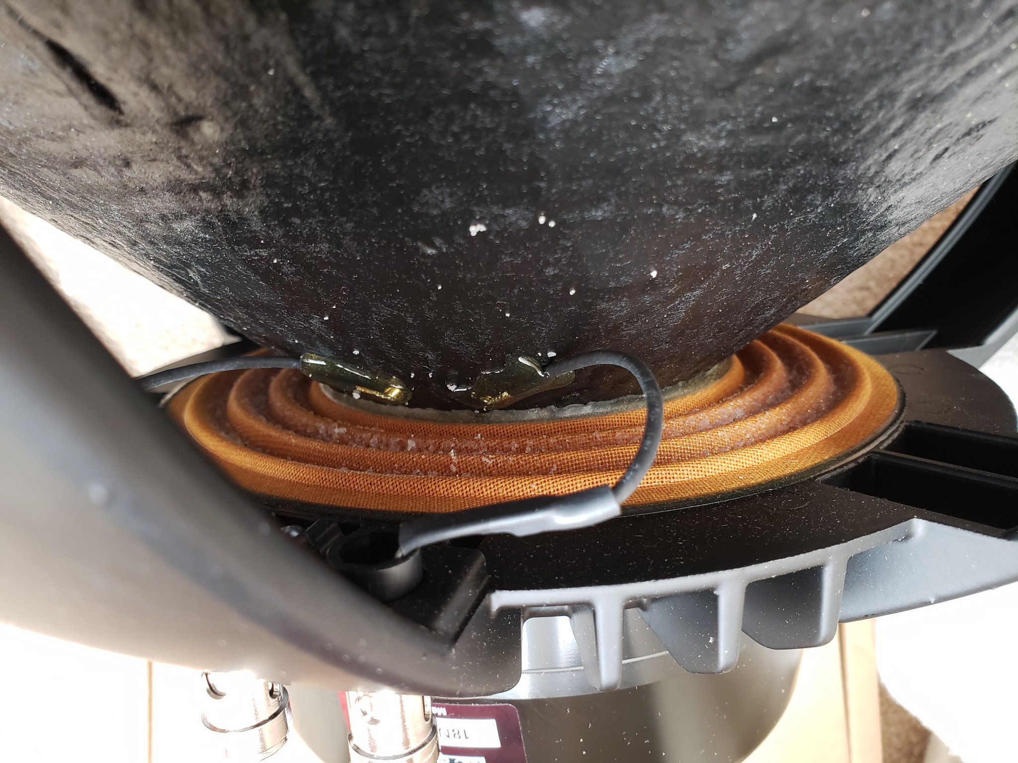

There's also another issue I have with this woofer. The silicone impregnated spider is shedding its silicone in the form of little crumbs as I push the driver harder. I've had this stuff get into a driver VC gap before with disastrous consequences. The VC eventually burned in some spots during heavy use and the driver needed to be rebuilt. My 18PZB100s did this despite being advised not to worry about it.
The crumbs do look like the silicon was over applied in places, which would tend to raise Fs until shed.
I'm surprised those crumbs could stay in the gap long enough to cause heat issues.
Do you have photos of the burnt VC?
