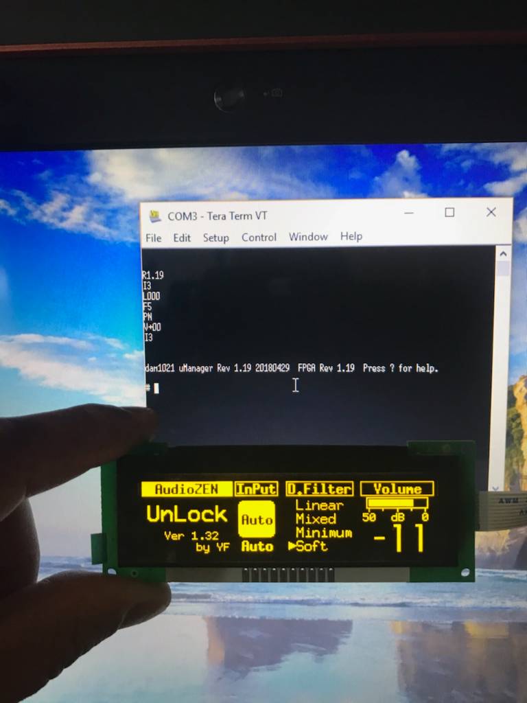

I have a quiet big problem. My AZ board does not change filters in soekris. There is no audible change. I have connected soekris to the console and there is no reaction on changing filters in AZ board. Any idea how to fix it?

Your description can't be judged. Please attach some photos,and do other functions do not work?
@mirfak,
post also some pics from the serial console connected thru J10, there you can see all changes via MCU.

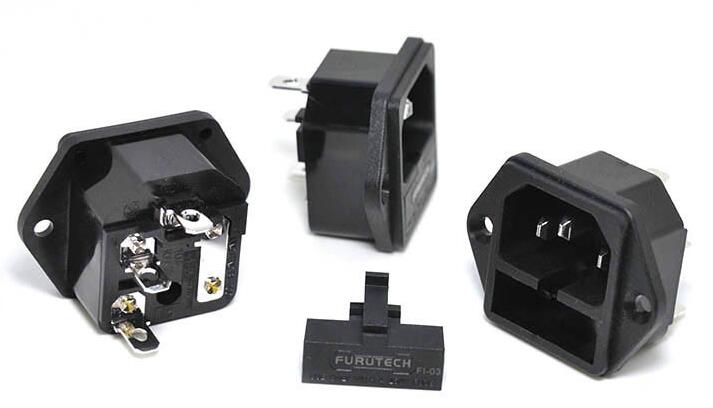

Perhaps Fuse on board would be a good idea... Despite place for AC filteringThis is just a test version. The final version should be divided into 2 parts, PSU and DAC, otherwise the PCB size is too large. And the DAC part maybe use 4 layers of PCB.😀
I managed to have Fuse but could be done better...

No problem。 F5 is the default for your dam1021 settings. If you change the filter, you'll see the detail. AZ does not change the default settings of your dam. Just after dam1021 setup, MCU will write to your dam from the AZ's last setup memory.
When I change the filters in the console, I hear the difference but as I change in AZ, it makes no difference.
WTF?
