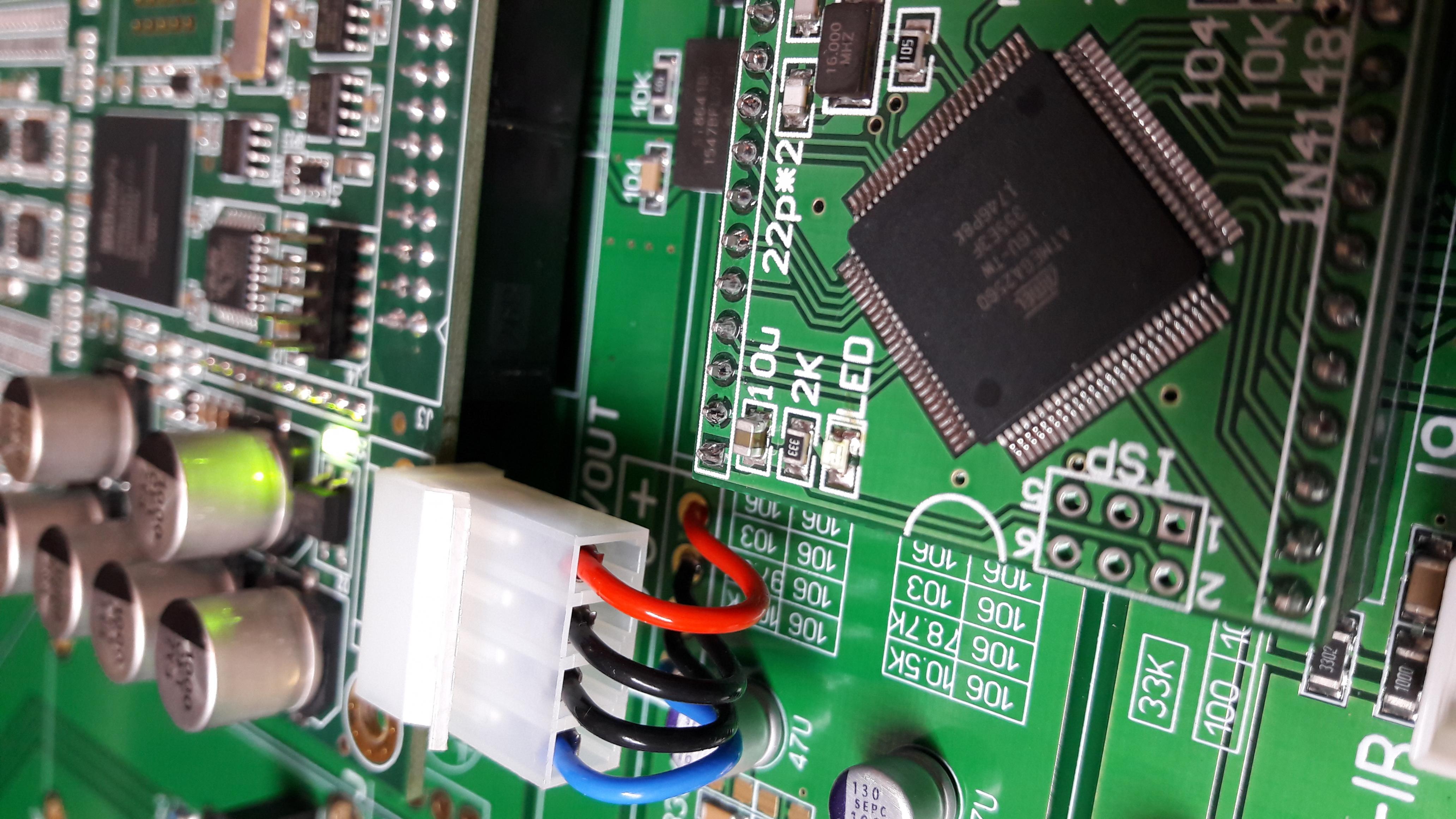

Sorry.This is the current limiting resistor of LED, which can control the brightness of LED. It does not affect MCU work.

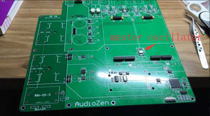

@audiozen,
Is a external master oscillator used? or internal?
Non isolated serial port is accessible via on board connector?
Oh...very nice, wish I known...

Hi Leon, the remote works fine. I have another question about USB port, since we have a dedicated power supply to supply the Usb card, Can I disconnect the red wire from the pcb?

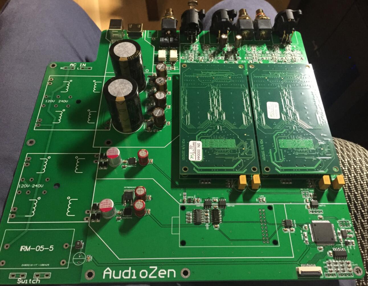

@audiozen,
Do I have to remove the board to program the firmware or can it be programmed while seated in your board. Is the non-isolated serial ports accessible to program firmware?
Yes - you can use the J3 header of the dam1021. I did that - no problem.
I asking related to the dual DAM1121 setup.
The TTL interface is reserved. With a TTL to DB9 adapter, you can upgrade 1121 firmware.
Hi Leon, so in your opinion, I can remove the red wire 5v from usb input pcb, in this case the usb card work with 5v supplied from 5v regulator from sk board, is it right?
Another question, the 3.3v tps serves for what? Can I use this 3.3v, to supply the 3.3v soekris dam in order to replace the hottest 1117 ?
5V (red) from the computer USB was cut off and replaced the linear power supply on SK. 3.3V does not need to care, SK will power to dam1021.

How do you toggle between programming boards? There are 2 DB9 connectors?
