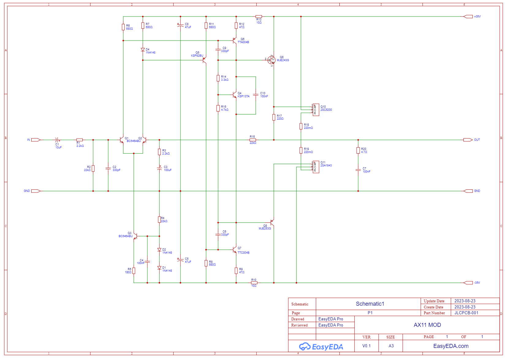

Could the configuration of these components under Minos effectively function? Considering potential alterations to resistor and capacitor values, has anyone undertaken the bold feat of integrating these intricate elements onto a sole circuit board?
As a non-windows user, I cannot run sims on this for you. First observation, Q5 is not doing anything. It is not a vbe multiplier unless the collector connects to something and spreads the voltage to two driver bases. Or two predriver bases.
The lower Q10 (of 2 Q10's) needs some sort of current limiter. No resistors.
No CCS on the input pair so no hum rejection as AX11 has. (Constant Current Source).
You haven't specified rail voltages. If you used +-25 v the 2sa1943/2sc5200 pair could handle about 2 amps by the AndrewT DC soa guide of full rail voltages. Could pump 150 w into 4 ohms at 25 vac swing, which is way more than the 2 amp soa allows (16 w). Better make sure it doesn't swing that far on output. Usually class AB amps can swing 1/2 the rail voltages if the gains are high enough. That is the reason 150 w honeybadger has 5 pairs of 2SA1943/2SC5200.
Others can further criticize the new design. I build old designs with a good reputation, or repair blown amps with good reputations. My 70 w/ch PA amp has two heatsinks 6 1/4" x 5 1/2" x 7/8". Layout of a 100 w board had best put the output transistors in contact with a heatsink as big. Or have a honking noisy fan on smaller ones.

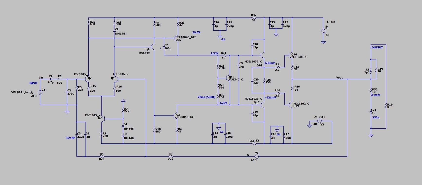

AX11 original schematic:

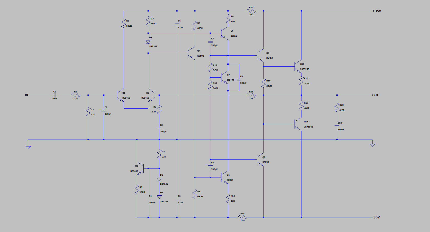

This represents my latest endeavor to fashion a schematic that radiates an enhanced and considerably more visually pleasing appearance:

The initial diagram intriguingly omits any resistors in proximity to said Transistor—an observation that piqued my interest. Could you kindly elucidate the optimal value and specific placement for such resistor? Should they be situated at the Collector, Base, or Emitter terminal?
You are right, AX11 doesn't have the resistors. I haven't built an AX11, I like speaker capacitors.
The quad303 uses 10 ohms in the collector leg and 68 ohms in the emitter leg of driver Q106. Same driver position as Q9 in your revised schematic. I don't know why, but commercial amps on the market are subject to abuse like clipping and get warranty claims if they latch up to one power rail.

Your specification of a 4 ohm speaker puts enormous current loads on a single output transistor pair. My 70 w/ch Peavey M2600 has dual parallel output transistors. You might try putting heat sinks on the drivers and paralleling 2 or 3 pairs output transistors, which need to be matched for Vbe. Lower rail voltages get better current on the DC soa curve, which AndrewT told me predicted life of an output transistor. Again, MJL3281/4281 MJW3281/4281 NJW3281/4281 have more soa than a 2SC5200 (which is by definition a copy, Toshiba doesn't make them anymore).
Reducing the voltage could prove advantageous as you mentioned? Would a configuration of 25-0-25 volts be sufficient for the intended purpose?
Actually a single output transistor pair amp producing 25 vac into 4 ohms would produce 154 watts. V^2/R=P
I^2*R=P for 154 watts gets output transistor current 6.2 amps. DC soa of 2sc5200 at 50 v is 4 amps. So no, following AndrewT dc soa rule for output transistors, single pair 2sa1943/2sc5200 is not safe at +-25 v.

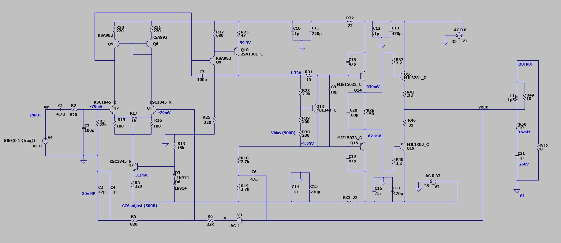

After a week of persevering through challenges, I have at last grasped the intricacies of LT Spice. Innumerable hours were dedicated to identifying components, comprehending datasheets, and procuring models. The culmination of my efforts materialized in the form of this achievement.
At this juncture, I find myself in need of the expertise present within this forum, seeking guidance on the realm of simulation. Regrettably, I stand with limited insight into the subsequent steps. Your assistance in illuminating the path forward would be immensely appreciated.
I extend my heartfelt gratitude in advance.

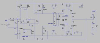

After dedicating several hours to initial simulations, I find myself encountering intriguing results that have prompted me to seek the insights of this esteemed forum. The situation I find myself in involves the collector voltages of two transistors, Q1 and Q2.
To my intrigue, the collector voltage of Q1 presents at 300mV, while Q2 manifests at a markedly different 34V. If memory serves, aren't both collectors meant to be harmoniously aligned in potential? In my setup, an input voltage of 0.5V is diligently provided. Yet, an uncertainty lingers—should this input voltage be judiciously adjusted to either lower or higher levels?
Additionally, I observe a rather substantial 5.03W power dissipation across R19. Could this, perchance, be attributed to a disparity in the proper biasing of the transistors? My scrutiny further unveils that a majority of PNP collectors are registering mere millivolt values on their collectors.
Seeking elucidation, I extend a cordial request to the astute minds of this community. Could you kindly illuminate the prevailing circumstances and suggest plausible explanations for this intriguing divergence? Your sagacious insights would be met with deep appreciation and gratitude.
In your sim post # 55 emitters of q1 & Q2 don't go anywhere. In ax11 schematic they go to collector of a ccs, a bc146. Get that straight, the middle of the schematic might settle down to 1/2 V+ - V-, and power in R19 might become normal.
Usually in sims people put a 1 vac input on the input, an 8 or 4 ohm resistor on the output, and sprinkle sim oscilloscopes and current meters at various interesting points. Higher gain circuits might like .5 vac on input . 1966 standard was 1.6 vac = maximum input, modern PA equipment seems to be +10 db or 0.48 volts or something.

here is a "gift" from another with spectrum disorders. (zip file).
I can't believe people build something like the AX-11 , it works .... but is quite non-linear.
I simmed it ... .2% THD - 330pF millers ??? What ?
The gift has 1/100th the distortion and uses accepted design "rules".
Just unzip the 2 files somewhere. LT will open it and just run !
I had indeed observed all those aspects prior to your response, subsequent to a meticulous comparative analysis of the two schematics. However, what truly perturbs my equanimity is the realm of simulation. Regrettably, my knowledge in this domain is quite lacking, and curiously, the more I delve into its intricacies, the more it becomes enshrouded in a veil of perplexity. 🙁
To be more specific, in the AX11 schematic, a wire from emitters of q1 & q2 goes to collector of Q3, the CCS. There is no dot at the crossing with the ground (center tap of transformer) which means no connection. In the simulation you have connected the collector of Q3 to the "ground", the center tap of transformer. Q1 and Q2 emitters are not connected to anything.
There are tutorials on simulations on the "design & build" category of diyaudio forums, called "software tools" forum. After reading one or more of those, you might post your corrected simulation over there and ask for criticism+help. I don't see any oscilloscope symbols, sine wave generator symbols, or ammeter symbols on your sim plot, which are usual symbols I see on sims all the time. Not running windows, I can't use it myself, but will look at the results from time to time.
As wg-ski pointed out, long tailed pair amps (Q1 & Q2) in sim have perfectly matched transistors. In real life they are usually not and the mismatch of gain or vbe of those can affect enter voltage and distortion profoundly. Big amp manufacturers buy parts in lots of 10000 and can specify how much match they want in that lot for a price. You, the individual, get whatever transistors were left in the bin at a distributor after the big guys bought a couple of hundred.
In quibbles about Ostrippers simple amp, drivers MJE15032/32 I would substitute with MJE15028/29 since they have less Cob and might be a little faster. VAS 2sa1381 has been sold by digikey in the past, but they didn't know at 7AM EDT of any in stock at any manufacturer whose inventory they link to. They don't have any. The "2sa1381" digikey bought most recently is in a TO220 pcakage (from ON), not a TO126 package like all the other suppliers.
I agree with ostripper on the 47 pf capacitors on the cb jiuntion of the drivers instead of 330 pf. My original ST120 board had 51 pf capacitors there after bad experience caused them to issue a service bulliten with changes. . Performs well after the stupid dynaco idle bias control circuit is changed to provide 20 ma bias on the output transistors even cold & soft.
