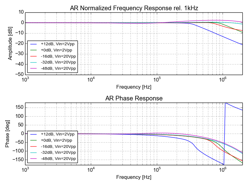

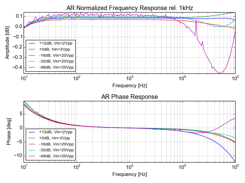

Frequency Response Measurements
Altough participating at the RTX GB, I recieved my Auto Ranger Kit two weeks ago. I intend to use the Auto Ranger as a intermediate solution until I've managed to implement auto-ranging for the RTX (since the API is not available yet, this might take some time).
After finishing the initial calibration this morning, I had a brief look at the frequency response. Please take the -48dB plots "with a grain of salt". My TPA6120A2 is able to deliver max 20Vpp on the input of the Auto Ranger, resulting in 80mVpp on the AR-Output. Of course, things get worse at higher frequencies.
I am prety happy with the results!
#1 10Hz-100kHz for all ranges
#2 1kHz-2Mz for all ranges
@Jan: recalibration needed? Another thing: At some levels (i.e. ~1Vpp, but also some others) the AR is not able to settle on a range, it never stops auto-ranging. Any thoughts on this?

Yes that-48dB gets a bit noisy. I do this with a Krohn-Hite 7600 amplifier which can put out almost 100V rms, but most people will not have something like that available.
Depending on the True-RMS meter you have, that -48dB may not be completely accurate. But maybe you could do the cal. with the instrument you used to make the sweep, and then fiddle the -48dB trimmer to get max. flatness.
But at any rate not too bad.
Jan
