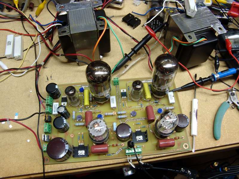

I have read and reread this paper, and I have come to the conclusion that I must build an "acf-2" or an "acf-3" or both, only using somewhat BIGGER tubes. Then I must "test" it in true Tubelab style. As I am leaving town in a few days my "testing" will be confined to the simulation world for now.
While visiting my very ill mother in law there wasn't too much to do since it was 2 degrees outside, so I did some simulations, designed an amplifier based on the ACF-2 and laid out a PC board. Now that I have returned and almost caught up on the usual stuff, I made one.
The amp used a 6EM7 to develop several hundred volts of clean drive signal, and feeds this into a Macdonald ACF-2 circuit that has been given the Tubelab treatment. The output tube is now the standard octal dual triode so I can use anything from a 6SN7 to a 6336A.
Initial testing with a 6SN7 revealed basic functionality, and several hundred volts (P-P) of clean output with no OPT hooked up. Connecting up an OPT caused red plates on the 6SN7. I popped in a 5998A which made about 2 watts before red plate set in. In true Tubelab style I went for the big guns and installed a 6336A. As soon as the tube warmed up both grid stoppers exploded in flames!
Far more science is needed when I am not in a rush, which means next weekend.
A picture of the PCB is included. Note the crispy resistor just in front of the right output tube. There is another one behind the yellow cap.
Something obviously caused a bunch of grid current in the output tube all at once. It was late so I just turned it off. The DC voltages were not quite right with the smaller tubes in it, but I was in a hurry so I ignored that and cranked things up anyway.
The grids are DC coupled from a 12AX7 which is supplied by a 330K ohm plate load. There should be no way for this to source enough current to vaporize a 330 ohm grid stopper. It was either a serious oscillator or a tube arc. More experiments to follow. Toasted parts are likely!

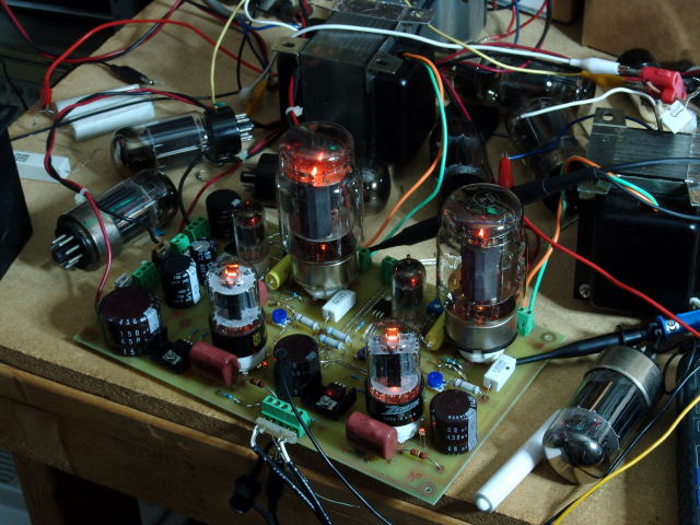

ITS ALIVE!
ITS ALIVE! And it works GOOD too. It turns out that the big dumb blonde one put 1N4007's in where the zener diodes should have gone. I replaced the toasted resistors, put some real zener diodes in and turned it on. It took a little adjusting, and the bias adjustments are real critical, but the amp works. How GOOD does it work? I am currently using 5998A output tubes. These are like higher gain 6AS7's. Output power at clip is 8 WPC. The distortion curves are unreal:
0.1 W .125%
1 W .175%
5 W .320%
6 W 1.4%
7 W 2.6%
8W 6.1%
Frequency Response @ 1 W:
Low End -3db point below 10 Hz
High End -3db point 26KHz
I listened to it for about an hour, it sounds GOOD, crystal clear, solid bass.
There are some issues, but the biggest one is that it still blows up when I plug in a 6336A.

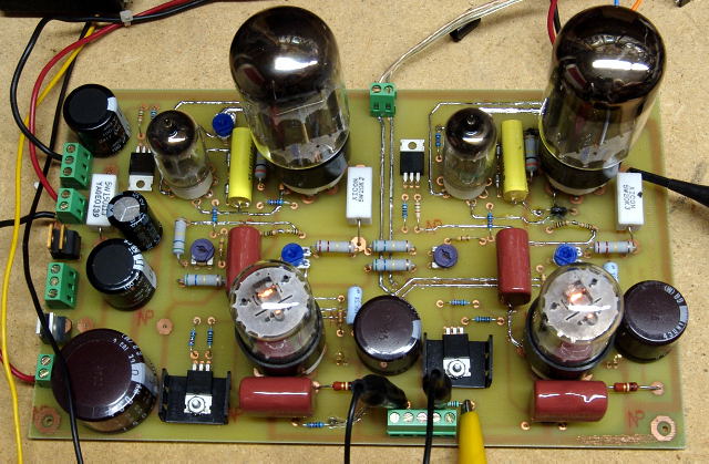

You know that I couldn't leave it alone. 6AS7's, 5998A's, 7236's all rolled through this amp without issue. I listened to each for about a hour. I began to think about the 6336A's, why wouldn't they work? What obvious thing could I be overlooking? How about the most obvious, a bad tube!
Yep, even though it worked in another circuit the 6336A that I tried was toast. 4 others from the same flea market box worked just fine. The ugliest two have been playing non stop for over an hour.
I don't have enough power supply to really test these tubes, but I see 8 watts at 0.4% distortion at 2.5% at 10 watts with both channels operating. The output impedance is about 1/2 an ohm.
