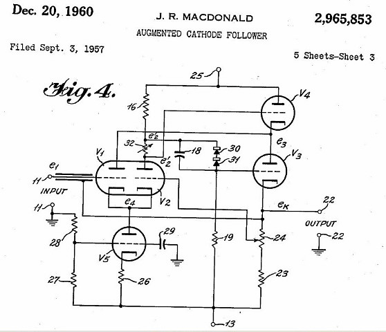

I started experimenting with bootstrapped CF output stages early last year. I developed a power amplifier that put out 20 watts with very low distortion for the design contest mentioned in post #41. It was a very complicated design using DSP technology. I learned about Macdonalds work in the first post of this thread, so I set out to build a power amplifier using one of his circuits. I decided that the ACF-2 circuit shown in post #25 would be the best choice for an output stage. It is similar to the circuit shown in the patent #2965853 (included). There are several advantages to this design over a simple CF:
V4 is a CF fed by the same signal voltage that the output stage (V3) sees. When carefully adjusted, V3 operates with a constant plate to cathode voltage. This lowers the device dissipation allowing serious efficiency improvements if V4 is replaced by a modulated SMPS. I heve been experimenting with this technology. The constant voltage removes the effects related to parameter shift VS voltage, lowering the distortion. The same voltage is applied to V1. This allows it to function in a similar manner. Since the voltages across V1 all move in phase, the input capacitances tend to cancel, so the stage input impedance is very high up to the MHz range. The feedback can be adjusted (24), so that the stage has overall gain. This feature can be used to reduce the drive voltage requirements, allowing for a better driver design.
In my implementation I replaced V5 with a solid state CCS. I made (24) variable as shown in this schematic. A stage gain of two seems to be the best balance between distortion, drive requirements and stability. V1 - V2 is a 12AX7 and V3 - V4 is a 6AS7, 7236, 5998A or a 6336A. The zener voltage is adjusted to set e3 such that the voltage (and dissipation) is evenly split between V3 and V4. This amp operates with a 600 ohm OPT. The cheap Chinese OPT that I am using now has RDCprim of 12 ohms. I am sure that there are better ones out there.
I am testing versions with V4 replaced with a mosfet, and a version with V4 replaced by a variable SMPS. I plan to test versions with pentodes for V1 and V2.

The DC voltages come from adjustable power supplies and were adjusted to meet the needs of each tube being tested. The negative supply spent most of its time around 250 volts. The positive supply was (and still is) set on 280 to 300 volts with 6336A's (depending on how much current I draw).
The OPT is connected to the OPT1 and OPT2 terminals. The tube current is set by the voltage divider at the grid of V2A (V4A). The pot across the OPT sets the amount of feedback, and thus the output stage gain. With the pot set for full feedback (wiper at the top on schematic) the stage gain is 1 and the output voltage (across the OPT) is equal to the voltage at the grid of V2A. As the gain is increased there is some DC offset introduced. Some gain lowers the drive requirements but too much gain leads to instability especially when driven to clipping. I got best results with the output stage gain set between 1.5 and 2.
The bias adjustment should come from a regulated source. It doesn't need to be a lot of voltage. I have problems with the pot connected across the two power supplies. They are both old tube regulated power supplies. The output voltage does shift with line and load variations espcially since I am drawing about 500 mA out of one of them which is rated for 300.
The zener diodes D1 and D2 (D3, D4) set the voltage distribution between the top and bottom output tubes. Try to get equal voltage across both halves. I am currently using 3 X 53 volt zeners in series.
