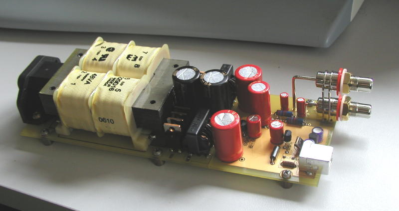

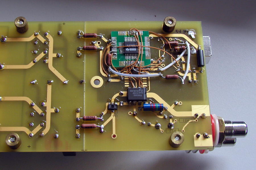

I finally took time to build the USB version of NOS DAC. It is basically same project, just the input BNC is replaced now by USB, CS8412 by PCM2706/7 and clock oscillator added. The regulators and bypassing caps stay exactly the same.

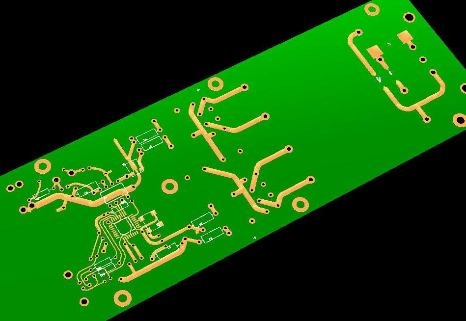

I will soon come up with proper PCBs to clean up the p2p mess 😉 In that prototype I have separate regulators for digital and analog sections of the chip; 3V AN8003 works here fine.
The initial listening impression was actually quite good (considering the rest of the source equipment)😉

I'm using 50VA Hammond transformer with dual secondaries. Attached is schematic for SPDIF version.
with USB, the regulators are AN8003, the bypas caps stay the same.

Peter, would you post the schematic of the USB DAC?
How do you plan to isolate the messy PC(especially the ground) from the USB DAC?
Edit: Have you ever tried stacking 2 or more 1543's on top of each other but running separate AN8008 regs for each of them? I'd be curious to hear about it.

I don't have the schematic ready yet, but it's basically the application note of PCM2706/7, the rest is the same as my NOS TDA1543 DAC posted previously.
I'm using dedicated PS, I don't think I can do anything about the grounds.
I tried stacking 4 TDA1543 chips, but the results have been always inferior to using a single chip (no separate supplies though).
Since the pics dissapeared, here's again the prototype:
