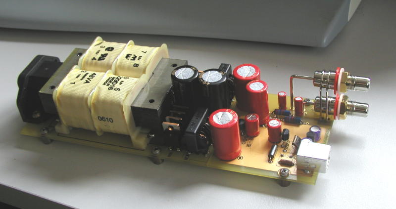

mikelm said:I'm not sure if 1 DAC can handle both USB & SPDIF inputs
my computer has both USB & SPDIF outputs so..... If I can have only one obviously I would like to get the best one, so if you could evaluate which is best with the same ( or similar ) sources I would appreciate your recommendation.
I just recently finished the USB DAC layout. The whole thing is very similar to SPDIF DAC (see pic below): the PS is the same and the board sizes are also the same. So if you separate the DAC section (by breaking it off along the scoring line) from the PS, you can swap SPDIF with USB version, using the same supply.
I was thinking for a moment of combining both interfaces on one board, but unnecessary compromising of the layout prevent it me from doing that.
But, you can mount the USB board over the SPDIF board, using standoffs, and with a switch select the I2S input to the TDA1543 either from CS8412 or PCM2706.
The USB board sections will be also available separately, so anybody having SPDIF DAC already can modify it into USB.
