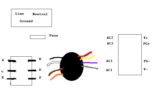

This is the premium LM3875 kit, which I was trying to put together as a dual mono amp, passive volume and chipamp in one chassis, and two separate chassis for each channel's power supply. Also, the main thing that was giving me trouble was, I'm trying to wire it up with a DPDT switch to switch from 120V to 230V mains. The trannie I'm using is:
http://www.plitron.com/shopping/specs/0770XX201.pdf
300VA with 24V secondaries.
So I thought I knew how to wire it together, and I plugged everything in, and 'POOF!' The fuse blew and there was a loud sound from the speaker (I only wired it up for one channel). I hope I didn't do any damage to the amp.
I've come to the conclusion, that even though I've done a little diy'ing, I'm out of my depth here... the instructions don't cover what I'm trying to build. (If worse comes to worst, I could ditch the DPDT switch).
Could one of you kind souls take a look at this little diagram and tell me what hooks up to what? I need some remedial help here.
It may just be the DPDT switch. Thanks.

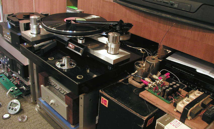

I'm actually working hard with phonostages. I started with a phono section based on VSPS (RIAA circuit only with all the rest changed and OPA627 used) and it worked surprisingly good. The step up was done by S&B TX103 (for Shelter 901)
If there is an interest, I can post detailed schematic.

The second circuit I tried was ONO. I used what I thought the best parts and because I couldn't decide which version of PS to choose I run it from batteries. But I was not blow away after switching from OPA627 circuit, in some ways I think the other one was smoother. I may have overdone with all those Premium part in ONO ;-)

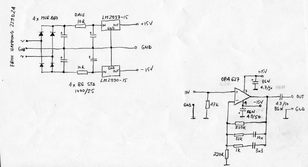

Here is the schematic of VSPS based phono stage using Allen Wright's modified curve, with the additional zero at 3.2 µS.
The component types are probably critical and are based on my previous experiments with DAC and buffer. Good thing was that most of the parts came from my other projects as well. All resistors are Caddock MK132, RIAA caps are 10n ERO 1830 and 3n3 Wima FKP2. I use separate transformer per channel: Hammond 229D24. The only bypasses after regulators are BG N 4.7/50. If you select OPA627 for low offset you may not need output coupling cap (offset less than 2mV).
This is actualy a very good sounding circuit. It is also simple enough to be built on a proto board.
